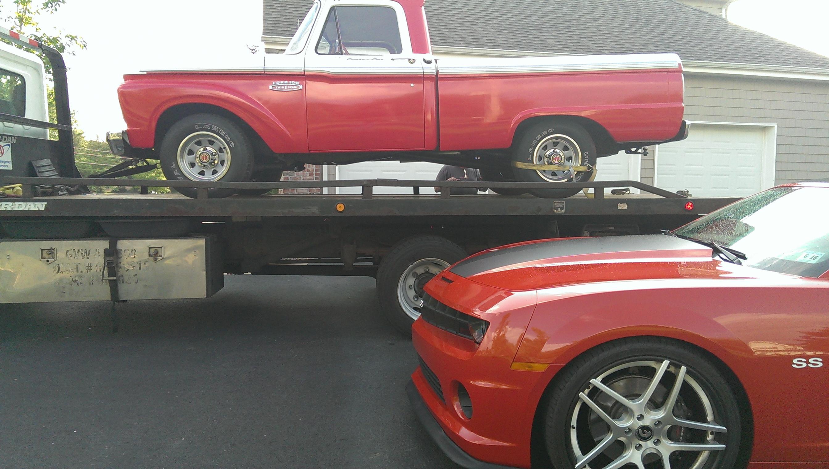

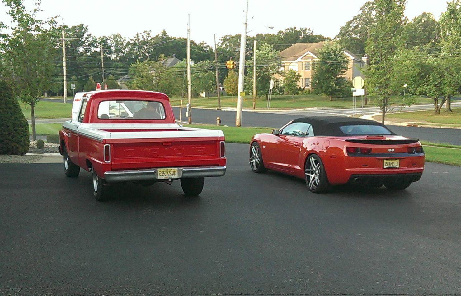

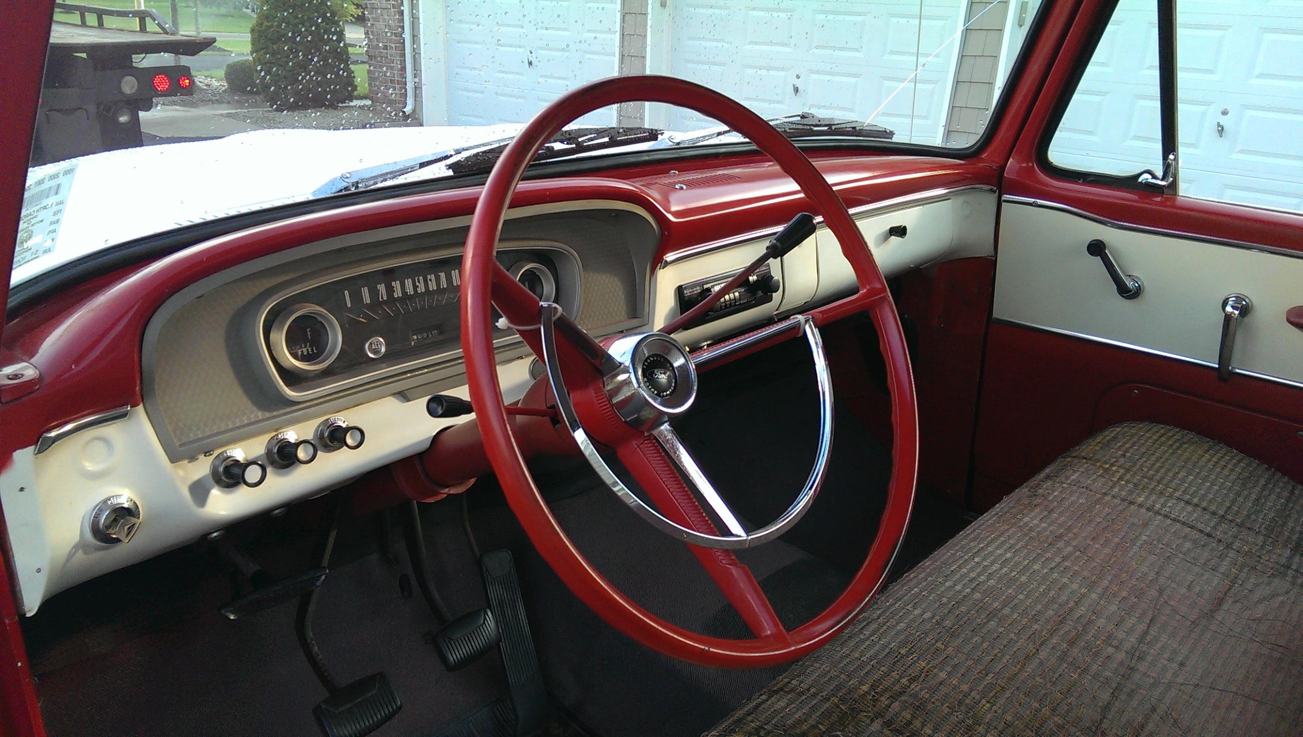

    Hey guys and gals new to the forum I just picked up my 66 f100 custom cab short bed yesterday. Body is fine so I wont need any body work or do anything to the bright work, the motor needs a tune up and a little cleaning and repainting but thats about it. The truck has a 3 speed which I will be keeping its much more fun to drive that way. I plan on bagging it and changing out the wheels and tires. If anyone has any advice on bagging this truck please let me know this is my first build and I a limited on knowledge
