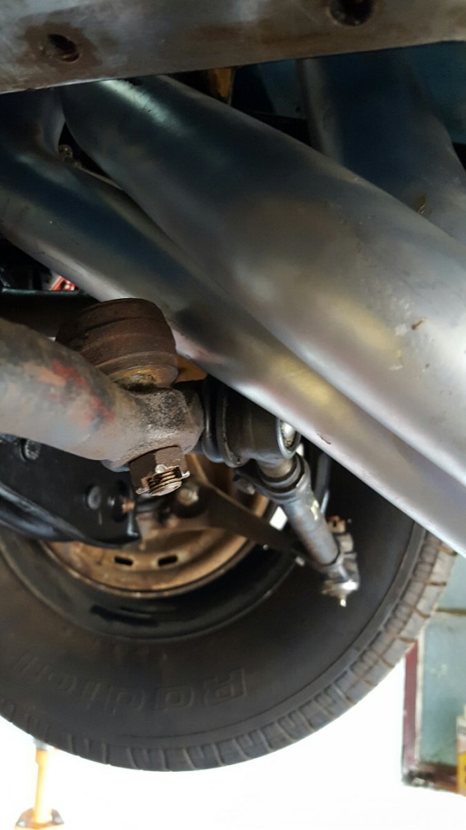

    Finally got a chance to drop the 440 into my '65 Fury III to replace the tired out 383. The car is an original big block car, so I figured that things would go smoothly. Not the case.
    After getting the conversion motor mounts from Schumacher, which required drilling and tapping the block, and working out the oil pan clearance issues, I dropped a shitload of money on a set of TTI headers specifically for my '65 big block C body that were supposed to fit perfectly. Not the case.
    After pulling the torsion bar to get in the PS header, I found that I have serious interference issues with the idler arm (see pics) and the bellhousing. I checked TTI's website and found that their recommended fix for steering clearance issues is to slot out the motor mounts and move the motor back about an inch, which, of course, would require me to pull the engine again. However, it also doesn't appear as if 1" will solve my problem(s).
    My next steps are to remove the motor mounts to see if I can modify them in any way (vs. the motor mounting stanchions welded to the frame) to move the motor back, which will partially resolve the clearance issue. I'll also have to notch out the bellhousing to allow the header flange to lie flush against the head. I'm thinking that I'll have to dimple (or dent) the header tube in order to get the necessary clearance. I'd rather not do that, but I don't see what other choices I have at this point.
    Has anyone dealt with this issue, and if so, how did you solve it?
    Looking at the car, I could heat and bend the idler arm, but honestly, that kinda scares me. Should I even consider the possibility?
    I've heard different POVs about denting header tubes...some say it will kill performance, other say that you can get away with it, and you won't feel any difference.
    I'm not looking forward to re-pulling the engine, especially to compensate for stupidly expensive headers that were "application specific" for my car.

  2. Well, they do say this in their listing "Engine mounts may require modification when stock pitman arm or idler arm interferes with header"
    What bellhousing do you have, should fit stock one but Lakewood type requires notching?
    AS for denting - watch this

    Hotroddon - Yes, they do state that, and I did find the directions. However, it doesn't appear as if their suggested 1" will work. I was also able to gain a little clearance by raising the tail of the transmission about 1/2. Hopefully between that and modifying the motor mounts I will be able to make it work.
    I have a stock bellhousing. I called their tech line and the guy said that it was not uncommon to have to notch the bellhousing. Thanks for the heads up, TTI.
    Gerrys - Yes, the headers were ID'd as headers for a '65 C body with a big block RB motor. The only dimension the tech advised I check was from the center of the crank bolt to the top of the crossmember. He said that it should be 3 1/2", and if it was lower, it may cause fitment issues that could be fixed by raising the motor. Mine was about 4", so it's already "raised" based on their specs.

    Got it now. Just an F.Y.I. about you header clearance issue. I worked part time for a number of years at a shop that did a lot of front ends on drag cars. We have heated and bent a lot of pitman and idler arms to keep the toe-in correct on some Chrysler cars. That could be an option for you.

    ...beginning to wonder if TTI tubes are made offshore....There simply is no shortage of available cars that could be used for design to make sure that the tubes actually fit.
    Before making serious changes to suspension or steering I'd send those things back.

    Not really sure if anyone actually answered the question the discussion got a little side tracked. That being said I'd dent the headers and move on.
    Also keep in mind if you lifted your trans tail shaft you changed your drive shaft/ u joint angles and you'll need to lift the front of the motor to put them back to correct so you don't get vibration and destroy joints.

    Ok, headers are in. After notching the bellhousing by about 3/4", I had to massage the headers a bit to clear the idler arm and the tie rod link. Of course, then I found out that the 8 qt oil pan that came on the engine didn't have the proper relief for the idler arm when turned full right, so I had to pull the deep oil pan and use the original pan, which brings me back down to stock oil capacity. All told, I put in about 6 hours, took the headers in and out about 20 times. This was a learning experience for sure.
