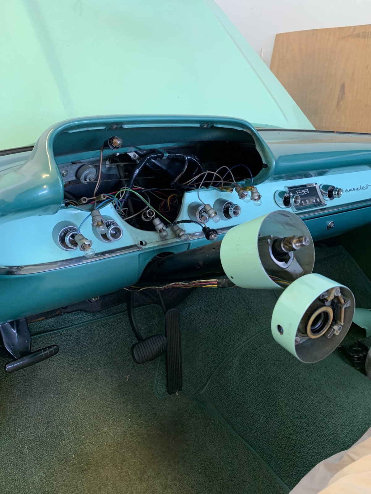

  9. Johnny Gee
    Joined: Dec 3, 2009
    Posts: 12,696
    Johnny Gee
    from Downey, Ca
    Here’s pain in the ass. Tearing down the top end of steering column just to be able to pull the cluster. 74CA83CB-F229-46B1-9793-712CF6B360D0.jpeg
