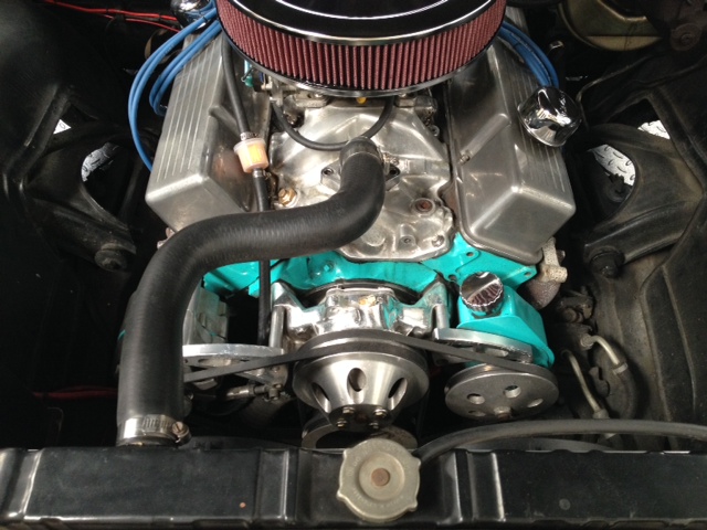

  23. Im taking your advise Ralph, thanks.. I'll post results.
    here's a pic of what Im working with. Dont really like the billet but its strong and works good, so it's staying for now.
    -Don

  24. Oh brilliant !
    Why didnt I think of that ???
    :eek:
    Guess the pulleys you have over there don't come off the pump.
    The fan blades get tricky too

  27. 48stude
    Joined: Jul 31, 2004
    Posts: 1,325
    48stude
    It's hard to see , but is your crank pulley smaller in diameter than your pump pulley, causing your pump to run slower? Bill
  28. Good idea Bill, I threw a tape on them and they are both 6.5"

  30. I don't see any heater hoses (by pass) or any bypass provision.
    This could be a source of heating troubles.
    Based on your verbal description alone, it sounds like a fan related airflow problem. However with out a bypass circuit in the cooling system there's other things to look at first.
    Some guys will say that they have no troubles running sans heater core or a bypass and yet others have cooling trouble without them. I'm guessing you are not part of the first group.
