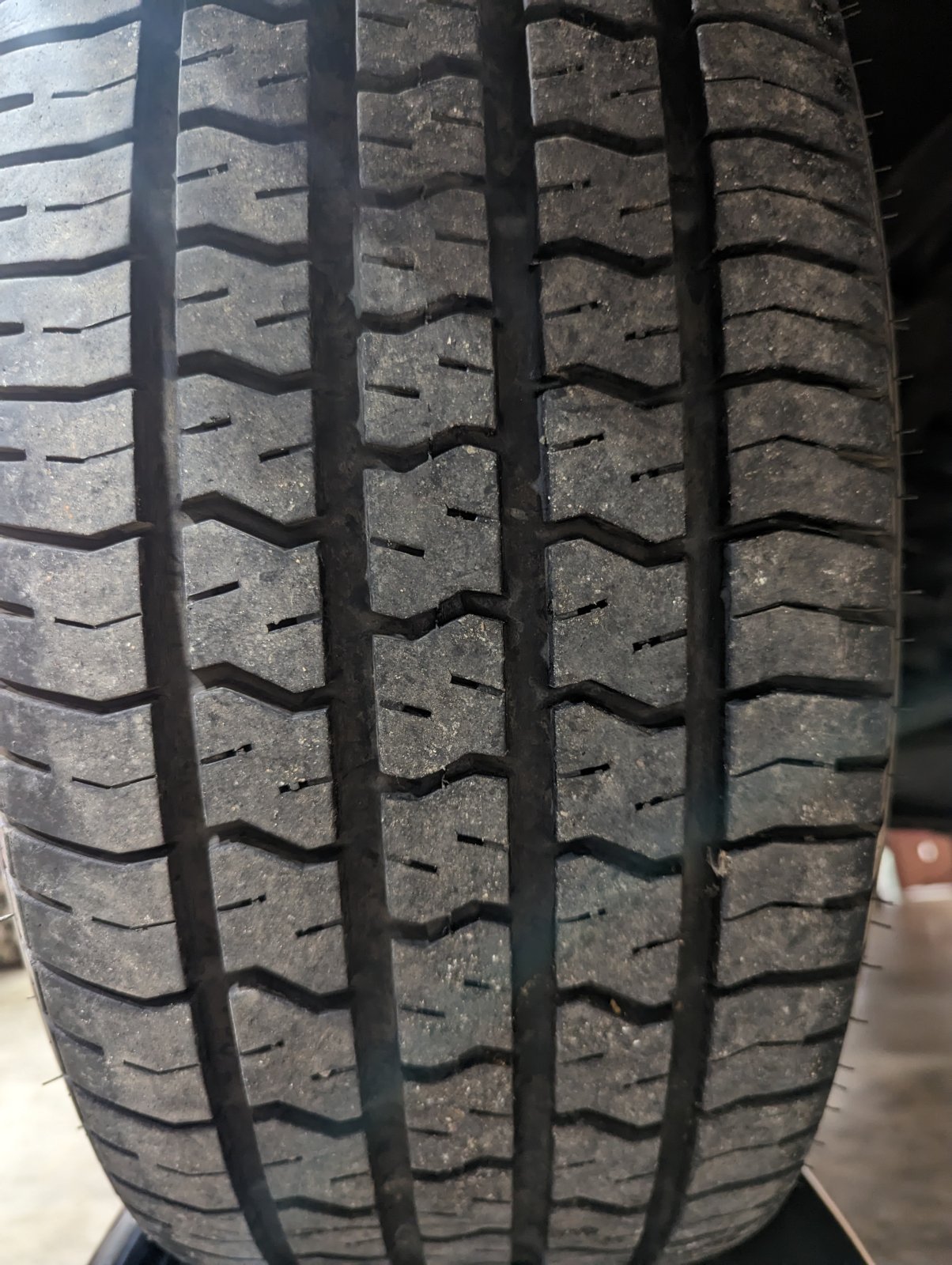

    I have a set of 27 year old 235/60-15 Grand Am Radial G/T tires that have been on my Impala since they were new in 1996. I had them on a set of Cragar S/S wheels for a few years then switched over to these because the 5-spokes were the unilug style bolt pattern and were hell to keep balanced. These were cheap and in stock at the time and they just grew on us, you don't see many Impala on moons.
    The tires are kept clean and at good pressures, still have plenty of tread and don't show signs or rot or cracking. What are some things you guys look for on tires with this kind of age on them. Think these are still safe to cruise on or just replace them?

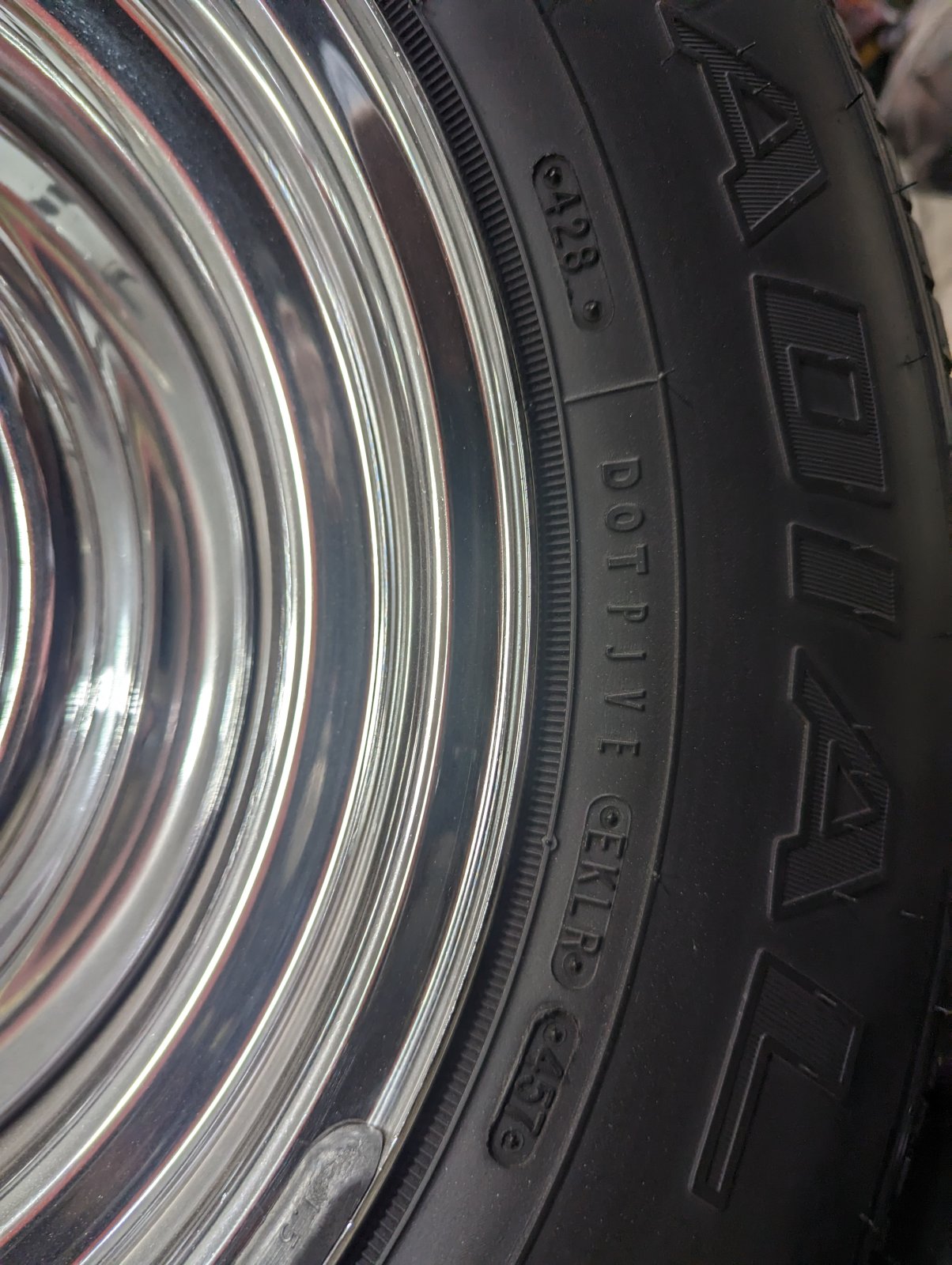

    Yep, if the OP's tires were fitted in 1996 as he claims, that means they were manufactured in the 45th week of 1987 ........ or worse, 1977 !!! They may be older than he realizes.
    KrucksGarage likes this.

    So the 457 is the 45th week of some year ending in 7 then as I understand your saying? I'll bet it's 97, I'm probably just a year off thinking about when we bought those. I bet there were made in 1997. I want to say we bought them at the local Les Schwab. 97 has to be right.

    That is the correct way to read a pre-2000 three-digit date code. Your tires may very well be 1997, but they also may have been stored new for too long before being sold/fitted. Either way, 27 years (or more) is way older than I would trust.
    From 2000 on, the date code is four digits. This way you can nail the actual year down.

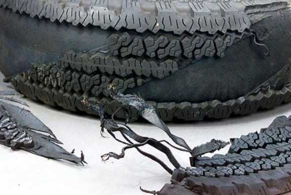

  17. Those tires look great. Until they don't. Rubber dries out and you can't always see it. This is what normally happens when you least expect it with old tires. Screenshot from 2023-03-10 04-58-43.png
