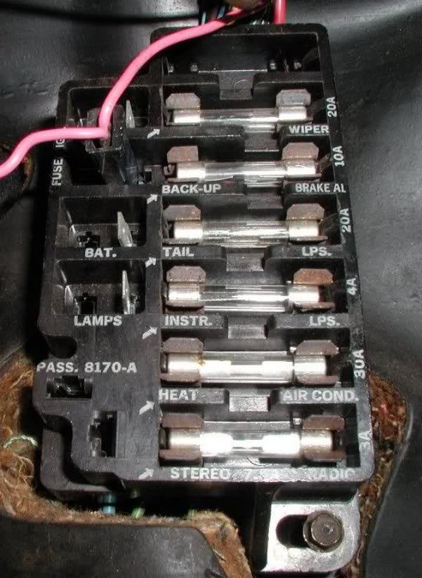

    I decided to jump in with a test light (The car is at my parents house and my Dad's meter wasn't working). I may be headed down the wrong path on my troubleshooting but I did find that the "Tail" fuse had power across it with the lights off, doors closed, trunk closed, etc. I also disconnected the trunk lid wiring connector and removed the other 2 tail lights. After that the "Tail" fuse still had power. Not sure if this is contributing to the battery drain or not and I ran out of time before tracing wire by wire with the diagram. I'm assuming that crossed wires would short and blow the fuse. The fuse block in the attached photo is not the actual one. I found that on the interwebs. Ours is not corroded. :)

    I believe the taillight fuse should be hot always, it feeds the switch so your lights can be on anytime.
    KarlWithaK likes this.
