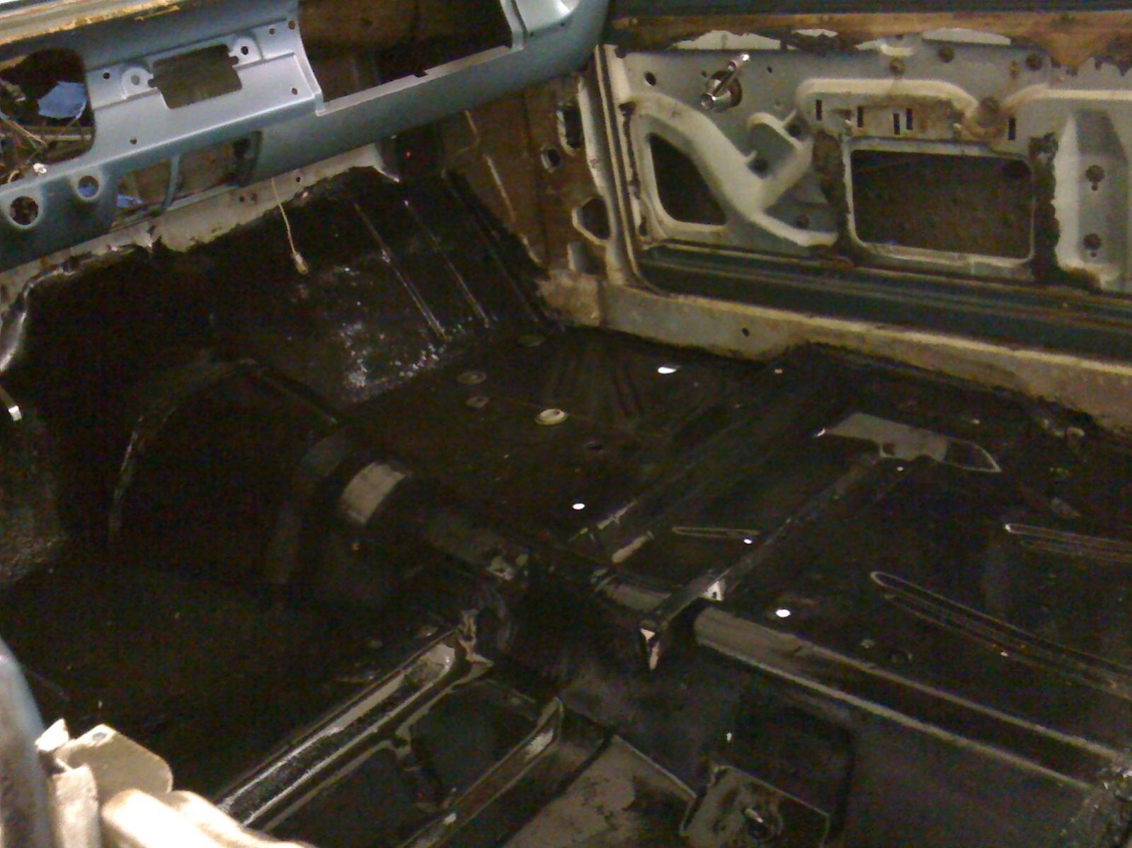

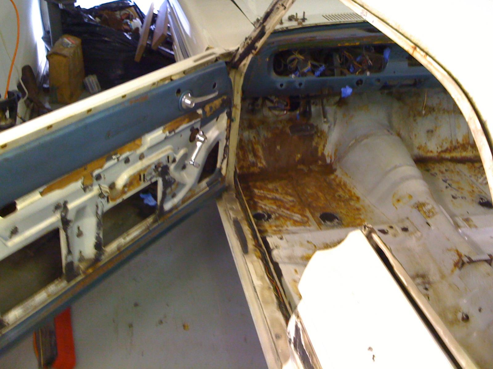

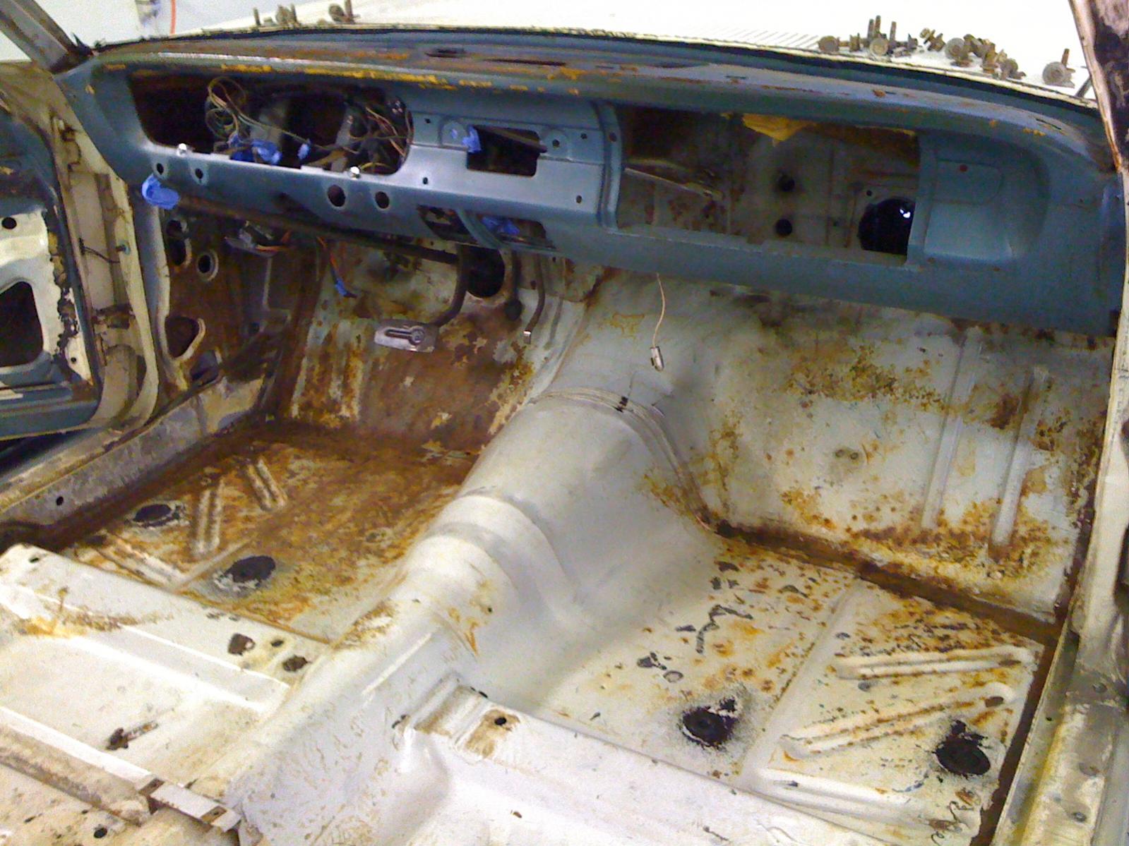

    Last night I spent the majority if the night going on with the tear down of the car. Im fairly picky about how a car comes apart. I do it by sections and bag EVERYTHING! Nuts bolts clips all of it. I find its easier for me to move to the next step if i'm able to work through a system. So the inside is almost totally done, I'm working my way out to the exterior trim, glass and so on.
    I've boxed up and i'm ready to send out the interior trim (pot metal) the plastic dash guage console, the chromed windshield surrounds, and other misc interior parts like wing window frames to my chromer. Im gonna wait until I get the grill, headlight buckets and all the rear trim off the car before I send it out. There are a few pieces that I know are in need of replacement, like the COMET lettering on the side quarters. Shot. So i'll be on the hunt for these parts asap.
    While ditching the carpet I found a bit of rust on the rear floor pan ontop of one of the torque boxes. I'm cutting that out and replacing it as we speak. It sits under the rear seat so im not going to make this panel patch focus on pretty, rather on strenght. Its about a 2 foot area that runs under the seat support. It'll take a few hrs to fix. than good as new. Im going to talk to my guys at Precision Auto to come look at the car for paint. Its gonna be time to rock on it soon.
    At about 11:30 p.m. last night I was looking at the car and realized that to make this happen I'm going to have to approach the build in a nonconventional build pattern. I'm going to have to do things fast and quality as the time comes so that it'll be done. Rather than strip, fit, mock up, disassemble, paint reassemble. its gonna be balls out and take it as it comes. I'm sure this may cause a few issues, though this is where building quite a few of these cars over the years will come in handy, although each one is a bit different. Keep your fingers crossed. Heres tonights progress......

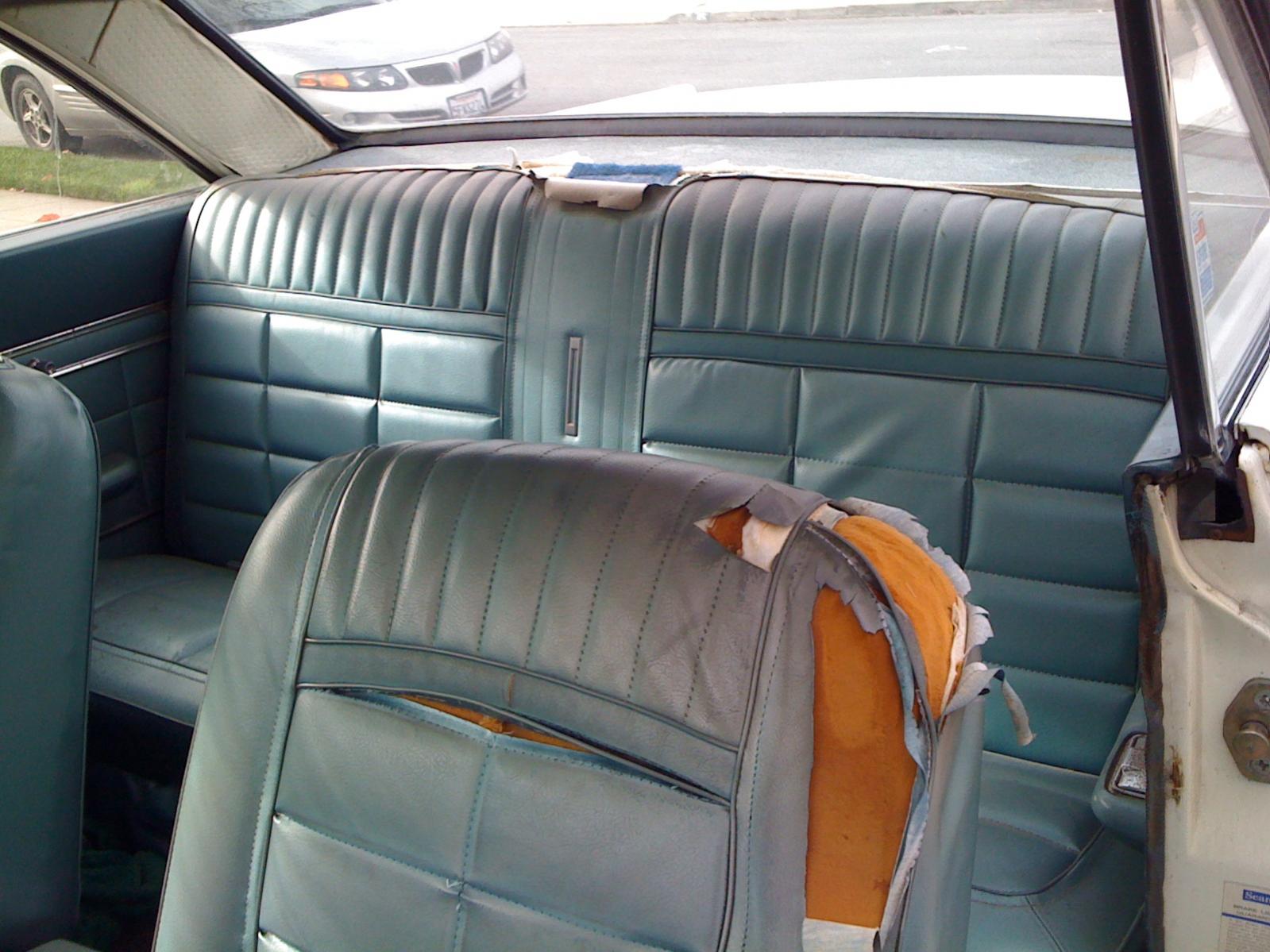

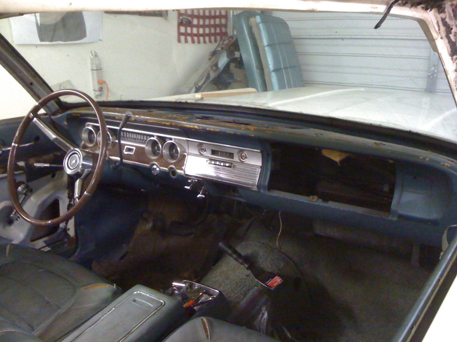

    By the way guys here are a few more shots of the interior in its factory form, before I ripped it out.
    I threw one in of the factory 260 CI V8 that ran so good you can believe it.
    One of the guys that has a shop across the lot was so mad at me about this thing. He said leave it! It runs and looks great! He'll be stolked on the finished product.
    I think I drove it around here for a few months before I tore it down, I wanted to get a feel for the car and what I can do to really improve the factory short commings. Brakes, for sure. Yikes
    Also is a picture of our dog (child, lol) Daisy. She's 15 and still awesome. She's my comic relief so I thought I would get you in on that.

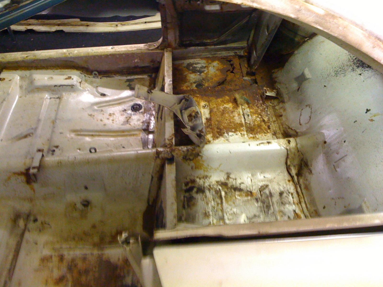

    Hey guys here is a bit more progress from the week from PSYCLONE.
    We finished dissasembly to take her down to the bare interior. I worked on the few patch panels that needed to be done on the inside. I made them as overkill as possible due to there location as as structural torque box and seat support area. They are not a piece of visual beauty though they aren't designed to be that way. That area is needs to be strong and resistant to flex. After the small patches I seam sealed it and fashioned a larger piece to cover the small patches (not pictured) to make it look a bit nicer and spread out the load and torque over the old pitted sheetmetal. Then POR-15'ed it again. Besides, there totally hidden. Not pictured is the interior supports I welded in under the big patch. Then out came the POR 15 to kill the remaining rust.
    There is also a good chance that this area will need to be removed later in the build for a few of the rear suspension ideas.

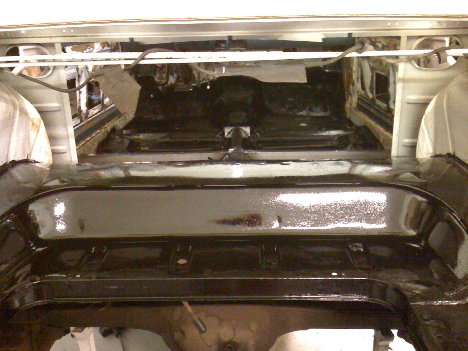

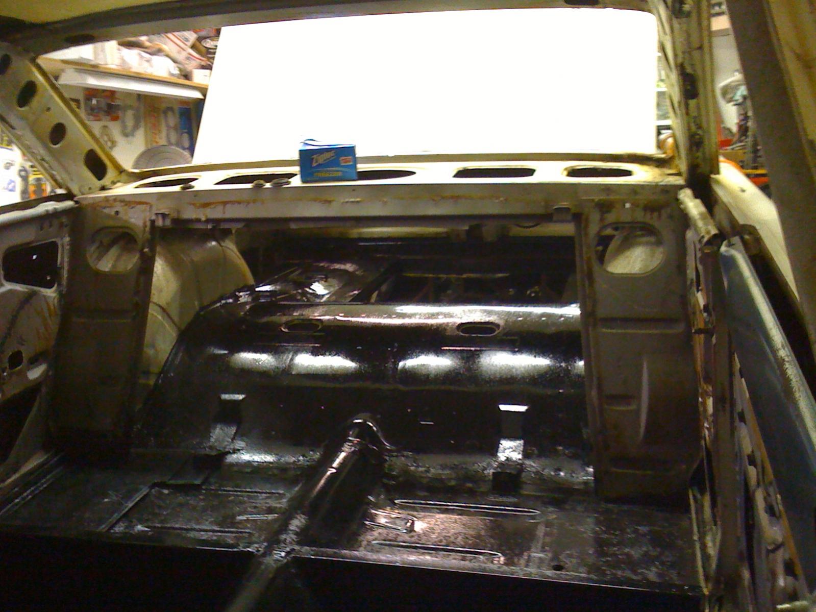

    After I did the patches I cleaned the floor and applied POR 15 to the remaining parts of the floor and trunk.....Messy.........But I love this stuff;
