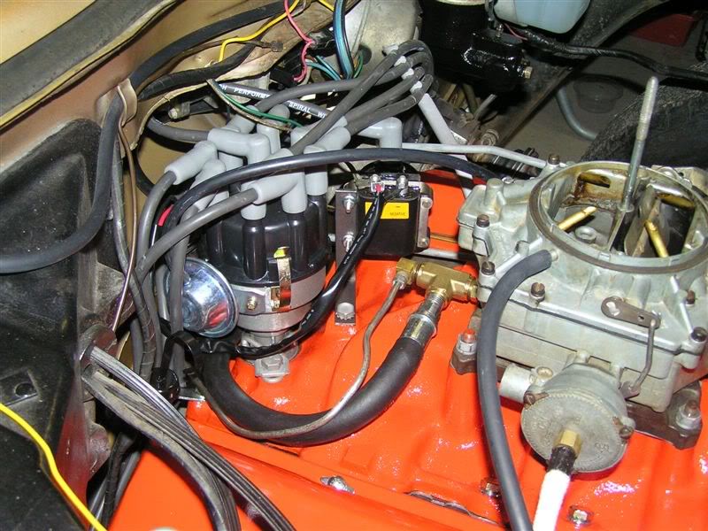

    The "canister" below the manifold is a baffle to prevent oil from being sucked out of the crankcase. You have all of the parts, except the actual PCV valve, which is external.
    Here is an example of the PCV: --> the rubber hose and silver PCV, screwing into the brass "T" coming off the back of the carburetor. 1964 PCV.jpg

    Great, exactly the info I needed. It seems the actual PCV valve was removed long ago I guess, should be an easy enough fix.
    Thanks for the info & pics Big Dog

    Now that slack has caused me to look more closely at the pic from OP, I see that this is one of those "half breed" systems used early in the pcv valve's introduction into the automotive use. The piece he's holding in his first post is the adapter used to adapt the pcv system to the early sbc setup that in earlier years would have had a road draft tube there.
    There is a hose nipple on the adapter Where you attach a hose that goes to the thebig vacuum outlet underneath the carb, as in your pic. BUT , in that line, between the adapter and the vacuum outlet, which in your pic appears to be a brass tee, is where the pcv valve goes, and I'm not sure if what I see there is a hose adapter or a pcv valve in the big hose. But that hose is where the pcv valve goes, facing the correct way.
  18. The picture is not of the O/P's set-up. It is an example of where the PCV should go.

  20. I'd be curious as to where the vacuum advance is hooked to in the example pic.
    This carb doesn't have the threaded port under the choke housing.
    Possibly one at LF, but I don't see the wisdom of running it around that way...over or under the linkage.

    The engine and pic shown are mostly pre smog except pcv. In those days, and today for some of us, full manifold vacuum was used for vacuum advance of dist.

    Talking SBC only. The system in the picture is known as "Open-PCV", where vapors can still escape to the atmosphere --> pre-smog as mentioned above. I prefer a "closed-PCV" system. Introduced in 1963 or 64 in California as an emissions device. This is where the PCV valve screws into the oil-fill tube and the hole in the back of the block is connected by metal tube and rubber hose to the air cleaner. The engone compartment stays much cleaner.
