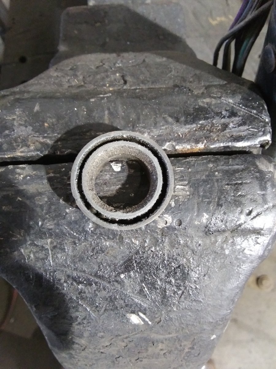

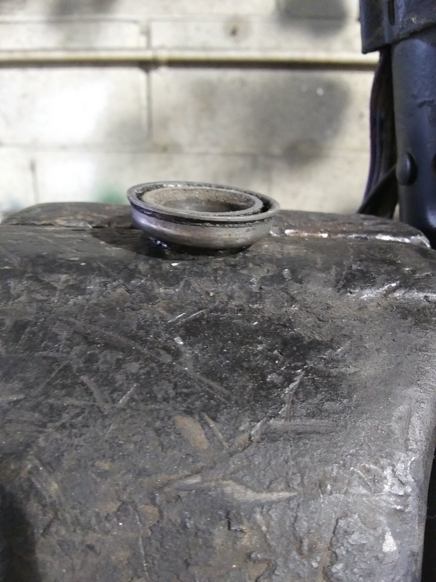

    Funny, I just ordered the same part for my 47 Olds. Same number fits many different years. It was kind of a pain to get out, basically had to fold it in on itself to get it to break loose. There is a non metallic insulator that is part of the bearing assembly as it is part of the horn system. It pretty much got left behind in the column and I had to scrape it out after I got the brass part out.
    This is what it looked like when I got it out!
