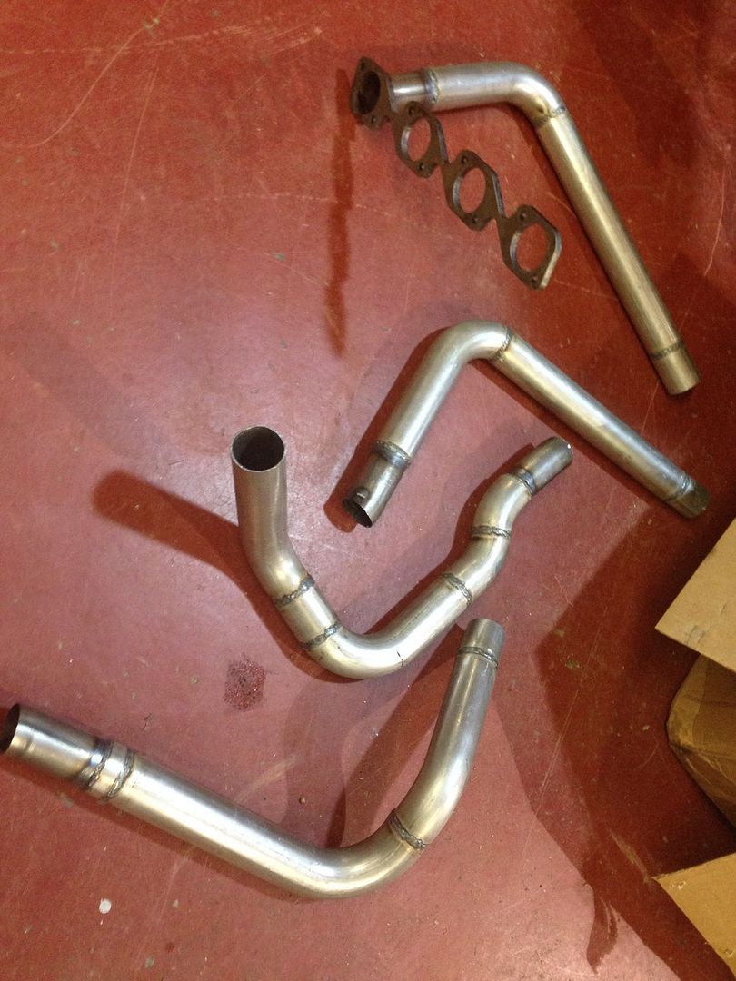

    running it in at jimmy huffs. broke it in with a dominator and super victor.
    getting the collector where it goes and trying to figure out tube length
    Getting the first tube fitted and tacked in

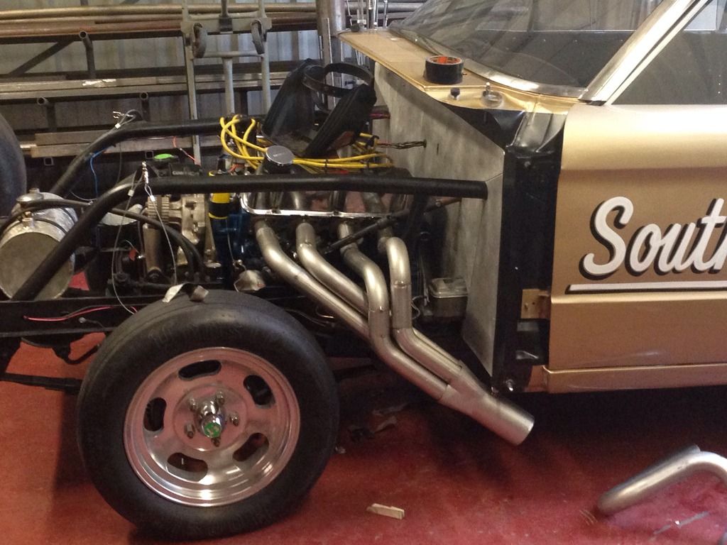

  11. sonic03bluegt
    Joined: Dec 5, 2012
    Posts: 516
    sonic03bluegt
    from sc

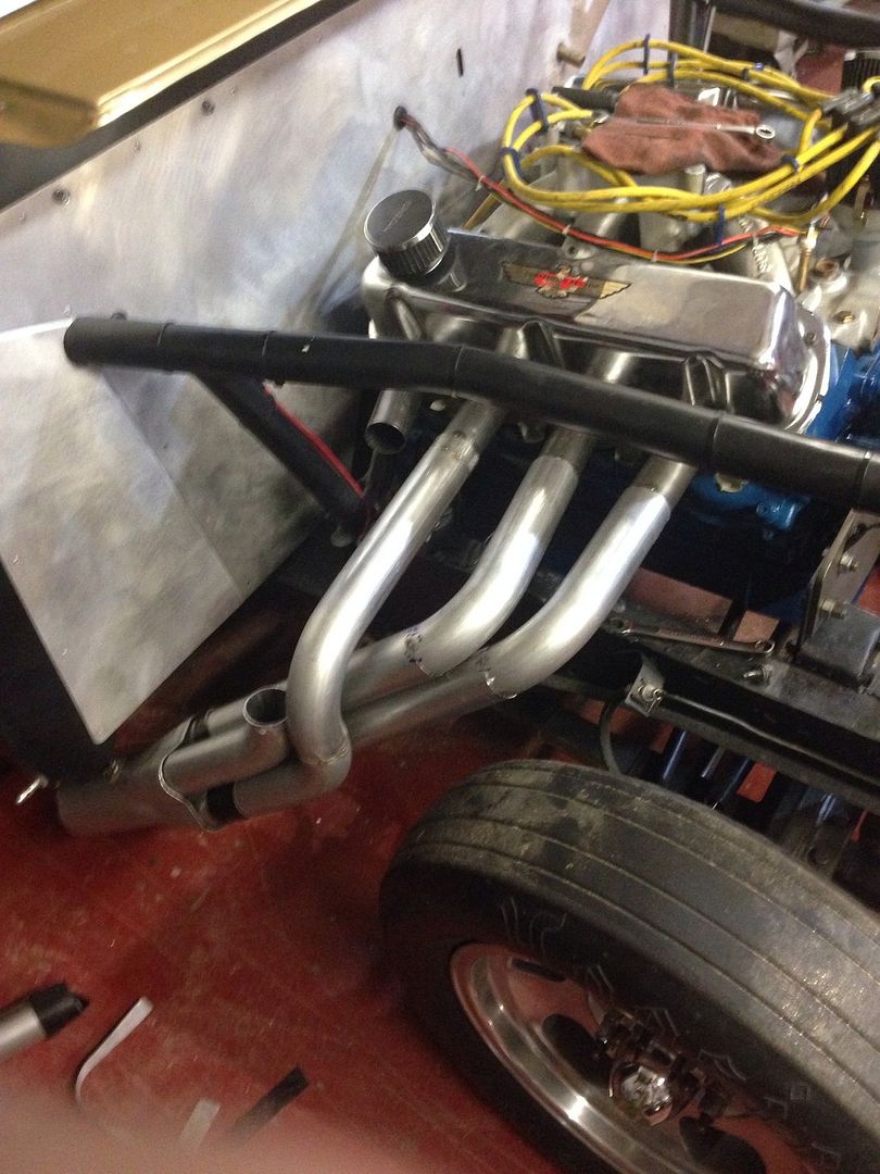

    Got the first 3 tubes figured out and tacked
    This was about 6 hours into the project with 1.5 people working
    The passenger side i fitted all on my own so go easy on me, its my first attempt
    Getting the drivers side welded up for good.
    trying to get the last tube to come out the right length was a little bit of a bitch
    neat little trick Quain had shown Donovan on how to flow the bends that came in really handy
    All welded up!

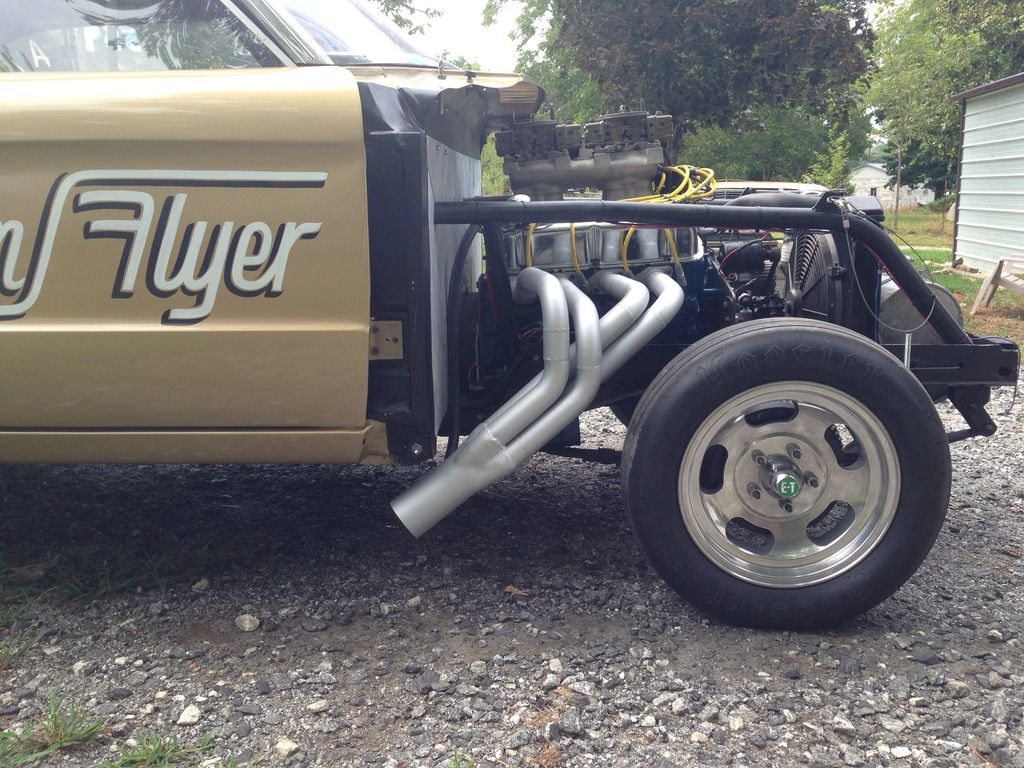

  12. sonic03bluegt
    Joined: Dec 5, 2012
    Posts: 516
    sonic03bluegt
    from sc
    Took a lot of work to get to this point! Now i know why custom headers cost so much

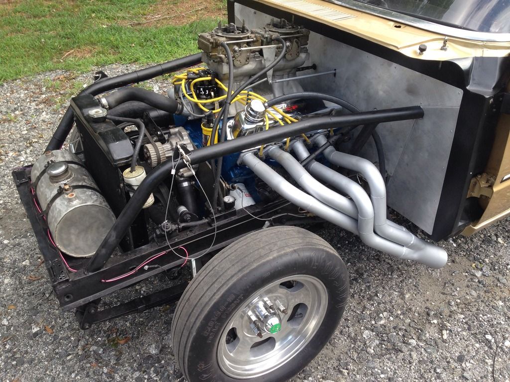

  13. sonic03bluegt
    Joined: Dec 5, 2012
    Posts: 516
    sonic03bluegt
    from sc
    I am pretty proud of how the headers turned out. Quain was out of town tuning a ProMod so Donovan and I conquered these on our own, and he only has a couple of sets under his belt. They are 1 7/8" stepped to 2" tubing 3.5" outside of the header flange. 29" tuned primaries on both sides. I owe a huge thanks to Jimmy Huff for getting my engine built, Quain for loaning me the shop for a couple of days and only being a call away, and Donovan for donating a good bit of his weekend building a set of headers
    els, kiwijeff, 3dnsouth and 6 others like this.
  14. sonic03bluegt
    Joined: Dec 5, 2012
    Posts: 516
    sonic03bluegt
    from sc
    We started with a few pieces of 1 7/8 tubing and a jegs 2" sprint car header kit for the bends and a set of header flanges for anyone that was wondering. Testing this week, then our next race is September 5 at Union, SC. Should be one of the best races so far, mark the date on your calendar!

  16. Quain Stott
    Joined: Nov 21, 2006
    Posts: 2,058
    Quain Stott
    Good Job, building the headers the right way. And yes I'm sure Donovan was a big help he's a pretty sharp kid and has been involved in several set's here. Most home built headers and a lot of store bought ones are not tuned. Most don't even know how to look at a set of headers and tell. I Get a kick out of it when I give someone a price and they tell me so and so will build them for 1/2 that. Especially when I have checked out so and so's tuning.
    els, sonic03bluegt and AHotRod like this.

  18. sonic03bluegt
    Joined: Dec 5, 2012
    Posts: 516
    sonic03bluegt
    from sc
    Thanks, it took a lot of work but im happy with them
    Yeah the hardest part was trying to get the tube length the same for sure
    Quick and Dirty may need those extra cubic inches pretty soon!
    els, Dog_Patch and II FUNNY like this.
  19. Can't wait to hear the new motor in person. Great job on the pipes. I couldn't tell from the pics, did ya purge 'em when ya welded 'em up? Keeps 'em nice n' smooth inside, too. Hammer down man!
    els likes this.
  20. Higgy's Henry
    Joined: Dec 29, 2010
    Posts: 429
    Higgy's Henry
    Quain kind of answered my question which was gonna be, how essential is tube length and do they all need to be equal?
    els likes this.
  21. Quain Stott
    Posts: 2,058
    Quain Stott
    Tony you have to purge stainless or it makes a mess inside. Mild steel unless you are welding to hot don't do bad on the back side. But it don't hurt to back purge anyway but most don't. The tubing Donovan and Gabe used was that old aluminized stuff, donovan said it made a mess when he welded it.
    els and sonic03bluegt like this.
  22. Quain Stott
    Posts: 2,058
    Quain Stott
    Tube length is very important if your fine tuning to get all the cylinders to run the same. For an easy to understand example long tubes give it bottom end (low RPM range) Short tubes (high RPM range) So if you have several different lengths the engine is always confused. Same with intake runners you wouldn't want them to be way different. It's way more complicated than this but this hits the high spots. I'm probably just too picky but I try to teach the kids to do it right.
    Oh yea a supercharged car don't matter as much because it's forced out during the overlap of the cam..
    els, AHotRod, sonic03bluegt and 3 others like this.
