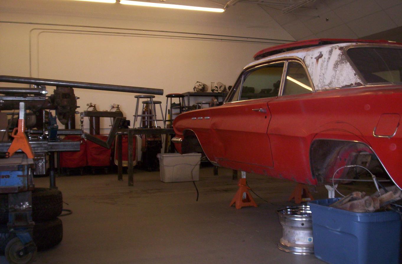

    Hey, I'm building a 61 Skylark to a gasser/drag style car. Hoping to make it look old school drag. Anyway I got a straight axle coming, and dual leafs up front. Front wheels are going to be cragars SS 15x4.5 Rears I allready have wheels for, 15x10 SS. Thats why cragers. Rear tires are Hurst cheaters, 30" tall. All on the way.
    I got the frame at ride height. Right now the rear wheel well is 32" high, front is 36". Got the 32 from 30 tires plus two clearance. 36 is just rake or negative rake, whatever you call that. Seems to me its too tall. Whats the way to fix this. Tubs seem to be dispised pretty bad. I have looked into radiusing the rear quarters, but this car is so shapy (shape like?) it seem like a shame. Check out a 61,62 Skylark,Special to see what I mean.
    Any Ideas, I'll post up pics tomorrow night also.

  4. We have one also that we are doing something similar to.
    I would love to see what you come up with.
    What rear axle are you using and are you using the factory 4 links?

  5. Stubbe
    Joined: Feb 8, 2008
    Posts: 41
    Stubbe
    from Rapid City
    The plan so far is to reuse the links, Mine are pretty clean. I'm going to box them up and put better bushings in. Don't know how we are attatching it to the axle yet or frame (?ish) parts. Thinking of lowering them a few inches with brackets to comp for the slicks. Oh, axle is a 8.8 with 3.73 locker. That puts my wheels out one and a half inches from the outermost body lines, so like 3 or four at the bottom. Right now just trying to figure out how to open the wheel wells and not look like shit.

  6. Mr48chev
    Joined: Dec 28, 2007
    Posts: 33,989
    Mr48chev
    I think I would move the wheel wells up and maybe pick up another set of wheel wells so that I could lengthen them a bit to match the size of the rear tires. End up with something similar to what a 56 Nomad rear wheel looks like.
    That may be near impossible to do though due to the shape of the rear quarters.
    I think you are going to have to do some inner wheel well enlarging or tubbing anyhow as if I remember right those rear inner wheel wells are pretty small.
  7. Stubbe
    Joined: Feb 8, 2008
    Posts: 41
    Stubbe
    from Rapid City
    Thanks, I think I'm going to go with the the stock looking fenders. To keep the cars look right. Can't really tub to much, or need to as the axle lenght is going to put the rear tires out anyway. Also the well are 11" and taper at the top of course. Just trying to get ideas from you guys as I'm pretty new to this.
