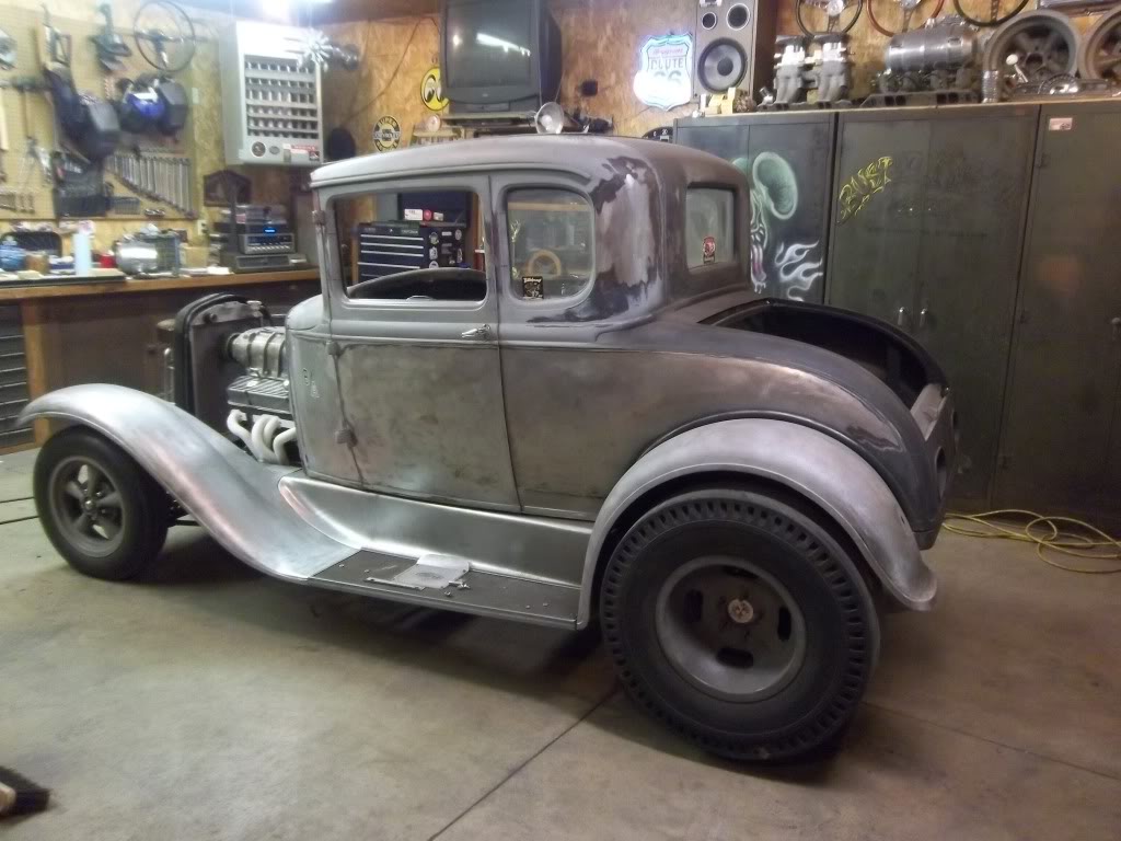

    Model A Frame Boxing and Starting the Trusses
    The inspiration for running the trusses came from The Freakin' A. That chassis was inspired by drag tube chassis design of the day.
    For example, take a look at these Lyndwoods.
    With this frame the plan was to keep it simple. The finish work after the fabrication is like artwork on The Freakin' A. Plus, I like visible welds.
    There's plenty more to do...
    I'll post detail pics as I get them.

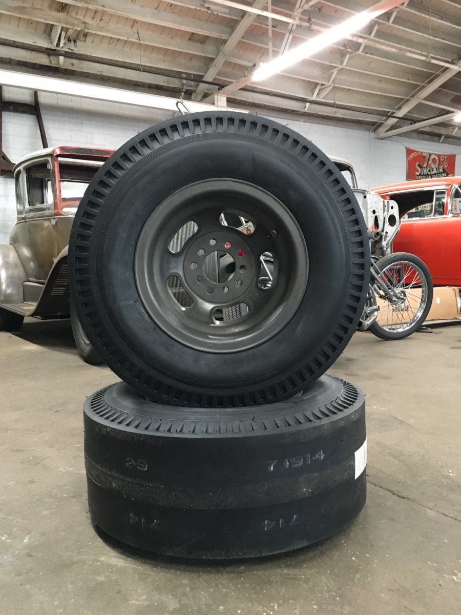

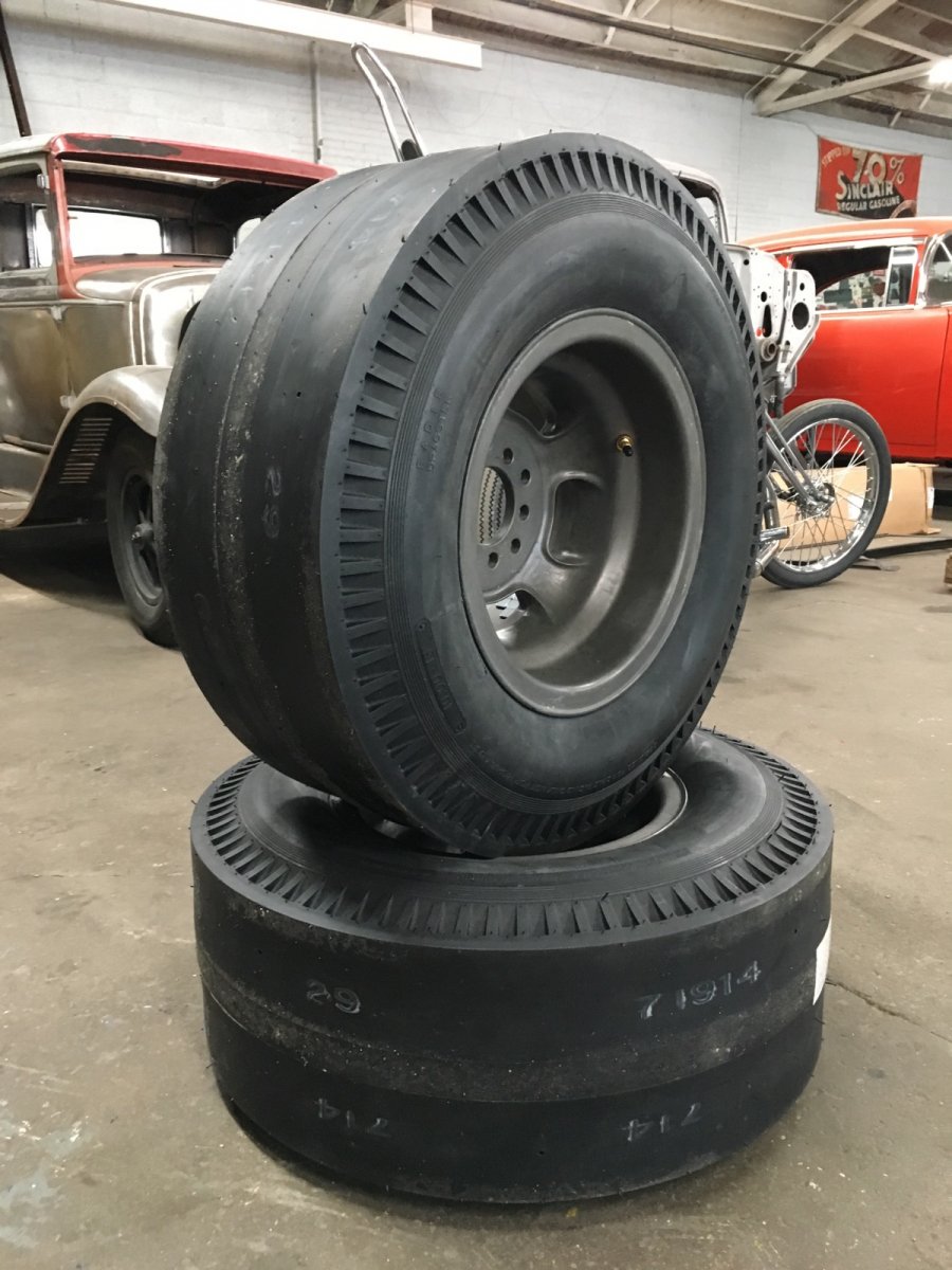

  3. Glad to see them with tires on Brent. Enjoy, and run the Hell out of them. I assume you received the block off plates as well?
    Stogy, loudbang and -Brent- like this.

  5. -Brent-
    Joined: Nov 20, 2006
    Posts: 4,990
    -Brent-
    Yep, they're on the shelf in the garage, untouched.
    Appreciate it, man! You can be certain these things will get run.

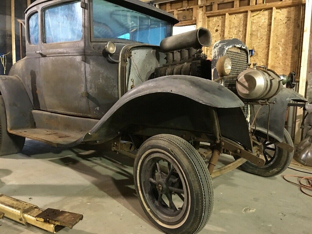

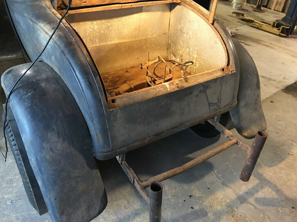

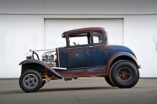

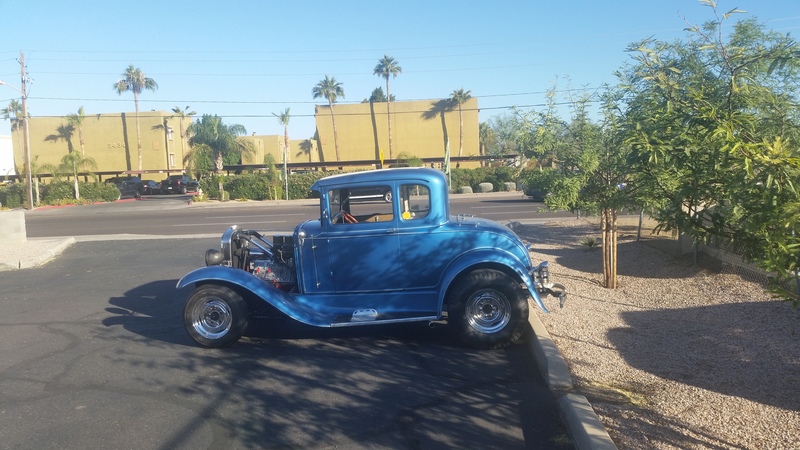

    Beside that, this car popped on eBay. I've only ever seen the few photos where it was staged coming out of a building and sitting outside. I never knew any details but the car has presence.
    Look at that trunk! People think I'm crazy for focusing so much on mine but I can appreciate well thought out areas that most people don't give a second thought to.
    There are a few killer parts on this car.

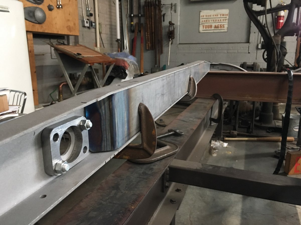

    Model A Boxing Plates and Modification for F1 Steering Box
    The "teeth" along the edge of the plate were ground off so they could be inset.
    Some steel tabs were welded into the frame so the plate could sit against them. The plates are inset at about 1/4".
    I wanted to run an F1 Box and boxing plates. I wanted to keep it simple, too. I've seen folks cut holes and sleeve the holes and it seems to me like that's way more work. The spirit of this frame build is to be tough, inspired by drag chassis of the era and be artful/creative while keeping it simple.
    To address the gap in boxing we have a plan I think will be pretty neat. More on that down the road.

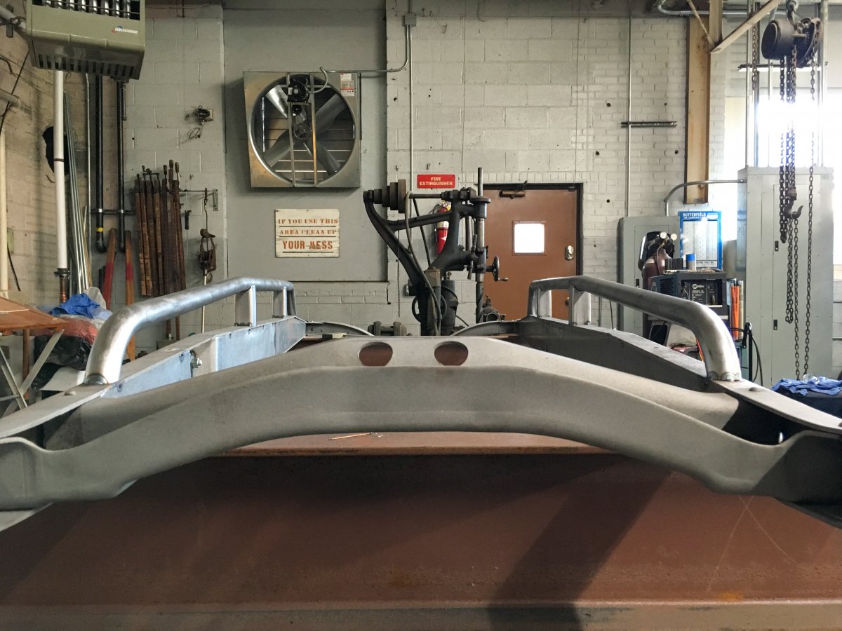

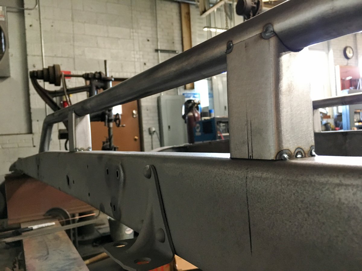

    Model A Frame Trusses
    Some of these pics may be duplicates but they'll help tell the story in this post.
    To start, this car will run a pretty basic 327. In time, I'd love to put a much hotter SBC mill in. And since the car will be a thrasher, we want to build a chassis that will take abuse.
    Overall look (it's upside down). The layout of the hairpin mounts, which will go under the front truss "stands" are set to the same length as the Freakin' A, which also has trusses.
    From the front. Ryan took his time during layout to get it dead-nuts even/square/straight.
    From the side. The stands are much simpler than the Freakin' A's. This chassis will have a lot less frills.
    If nobody ever told you, you'd never know that these stands are the width of the frame on the frame side and taper to tubing width on the tube side. Ryan put a small pie cut and tapered them in. We're the only ones that will ever see it... except if the car's on a lift... then some lucky guy will see them too... and never know what the hell is going on. o_O
    Closer view. The work they took to fit is far of less an effort than pieces that Ryan designed on the other car. These stands allowed for the tubing to be all one piece, too.
    A local race shop bent the tubing to Ryan's dimensions. They left an extra foot run on the ends so it could be fit exactly.
    At this point, everything is tacked. We have a tentative plan for the cross-members and mounts. Ryan succinctly said it perfectly on the phone last week when we were talking about our thoughts for the mid crossmember. It'll be "racecar shit" ... which might be the best description for making it tough, keeping it simple, and sticking to the design elements we both admire.

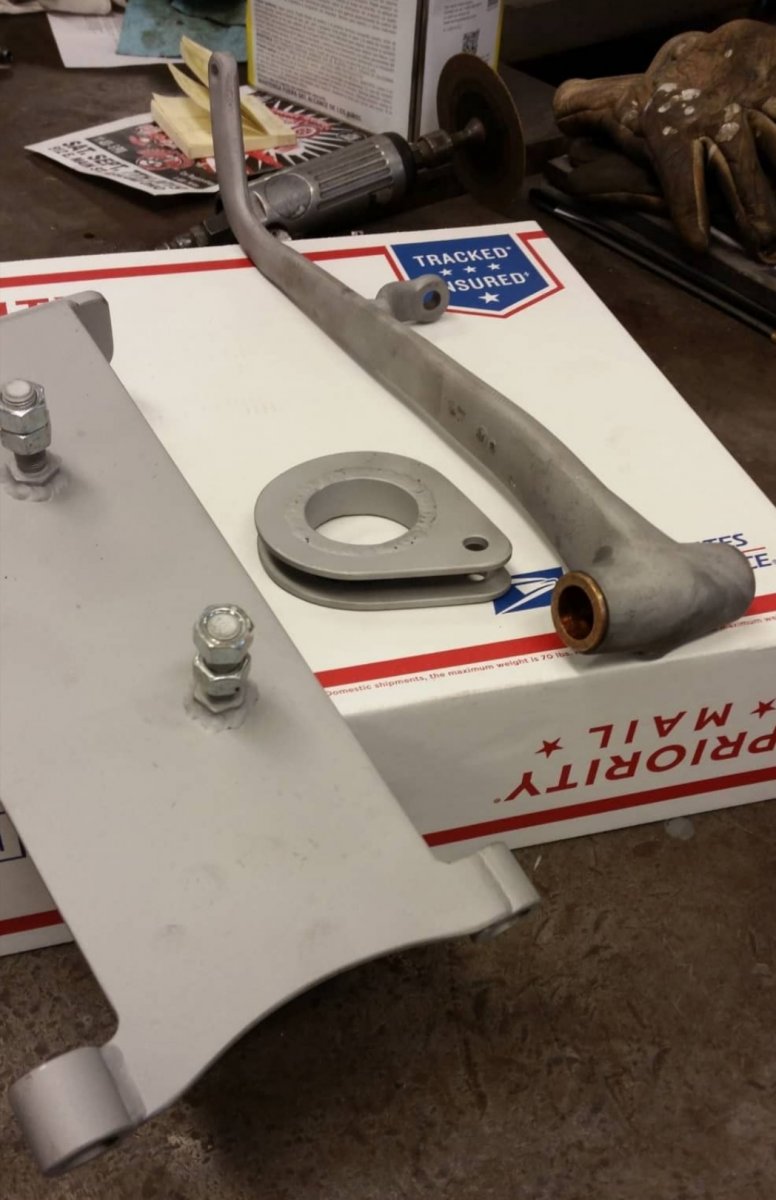

    The frame work is starting to get welded in. No pics of it, yet, though.

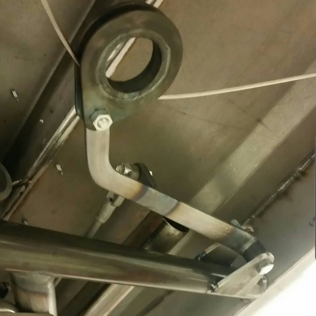

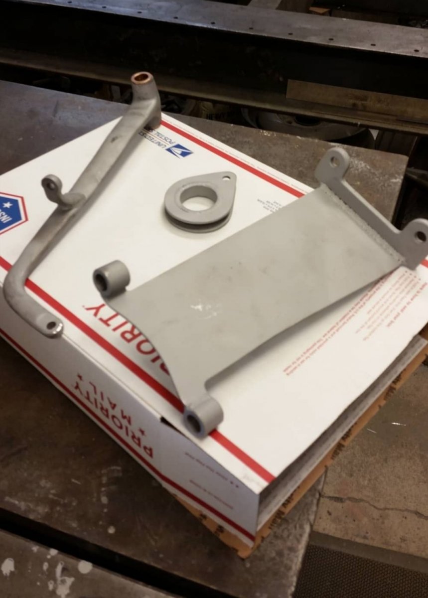

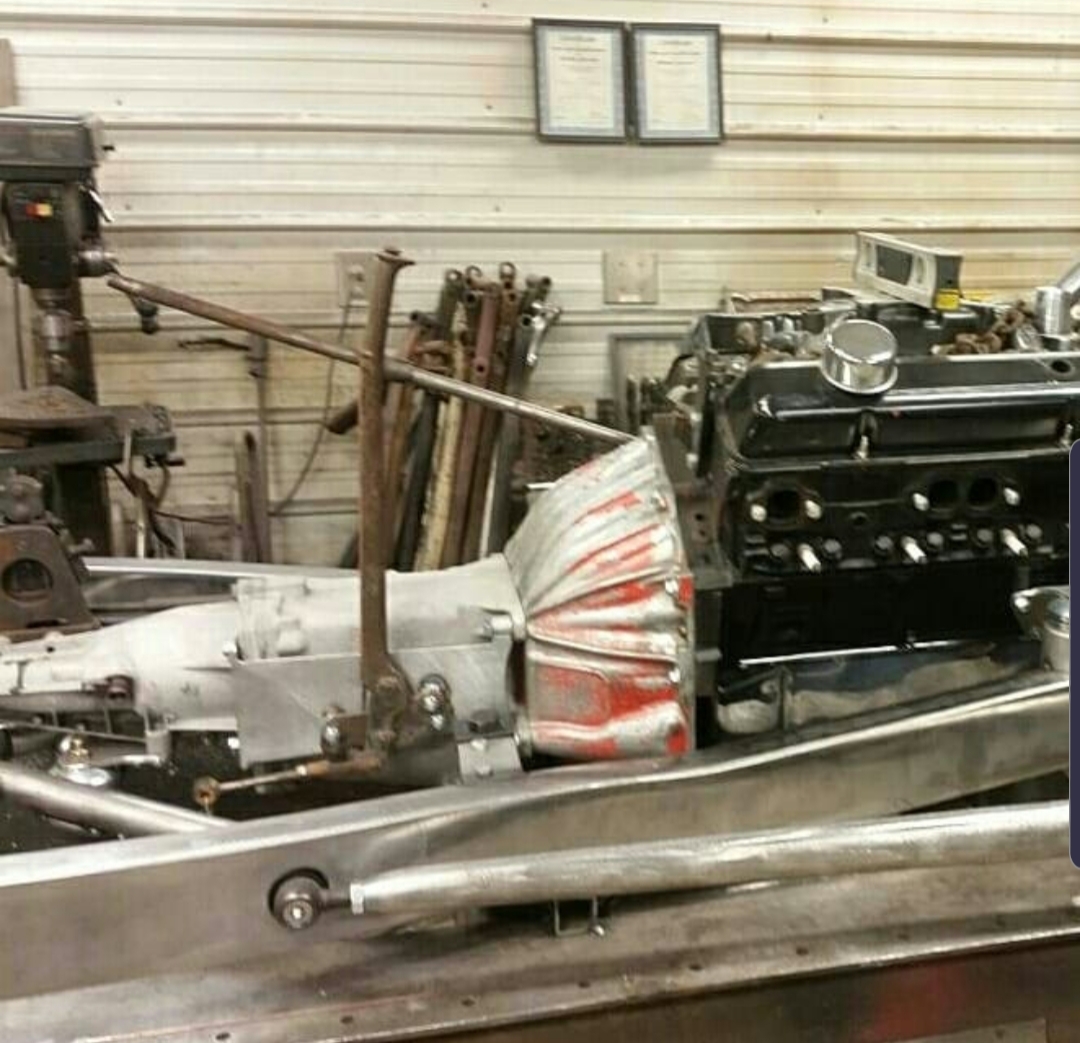

    Instead, here's a part we're going to make work. There's a guy (he's likely a HAMBer) who I follow on IG that made this great e-brake kit for his T Coupe that also has a Muncie.
    Here's his kit:
    It uses a Model A handle.
    And an old Model A pedal modified as a swing arm. Smart stuff.
    Here's the kit going in my car:

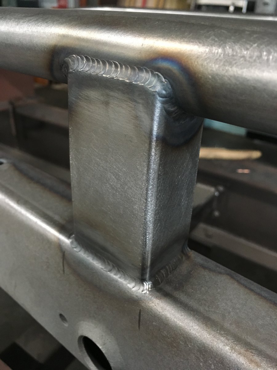

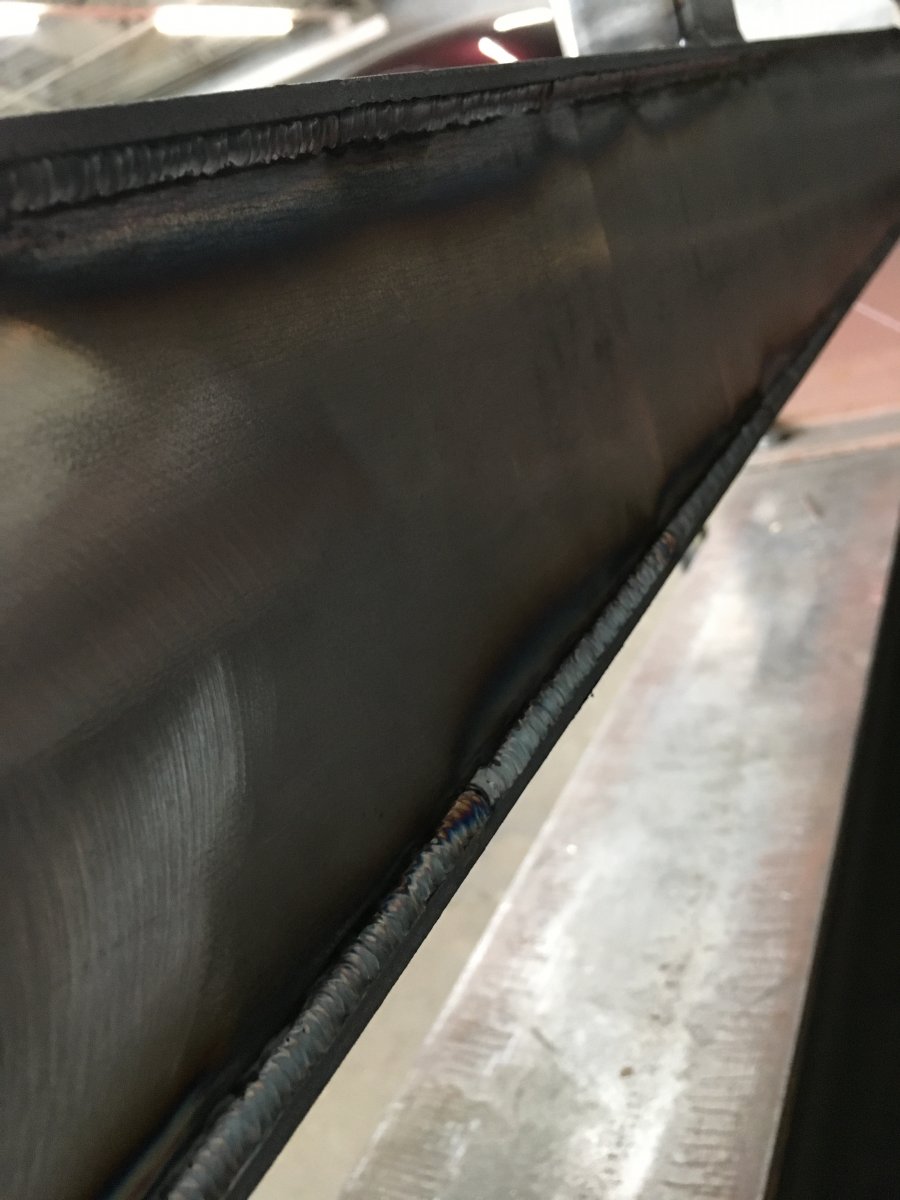

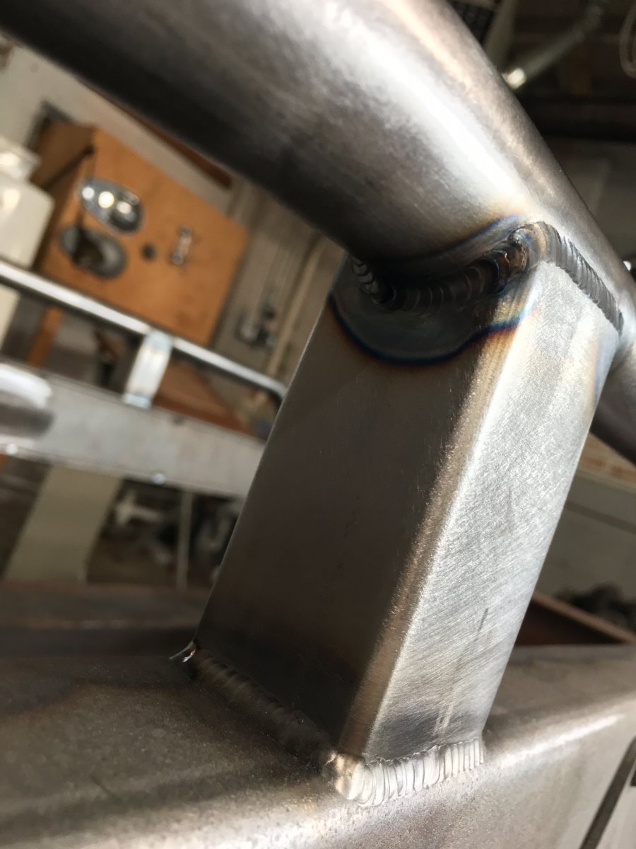

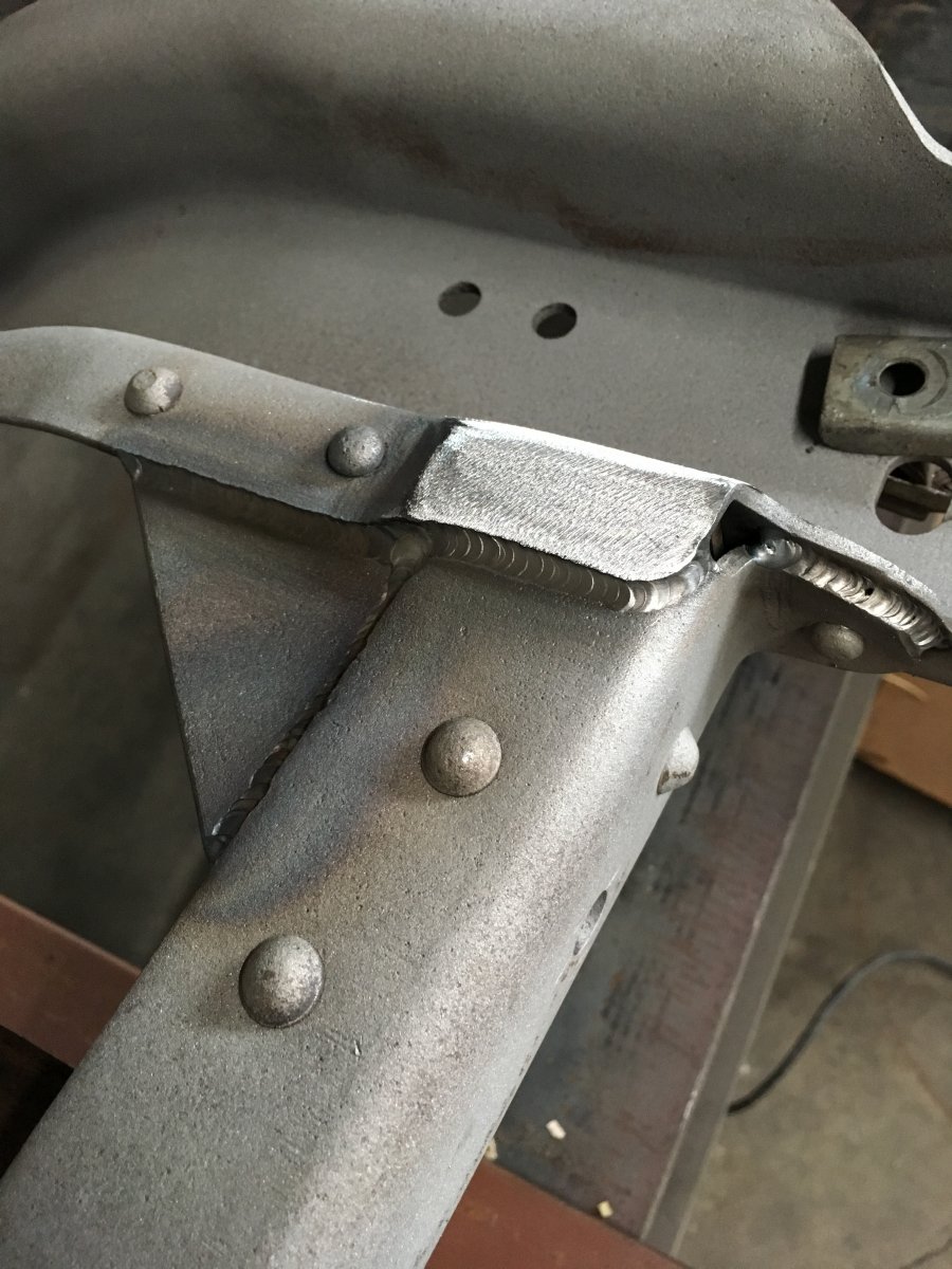

    Frame Welding Details
    Here's a minor update. Little by little the chassis is coming along.
    Model A Chassis Truss Stand 2.JPG Model A Chassis Truss Stand.JPG Tig Welded Inset Boxing Plate.JPG Tig Welded Model A Crossmember.JPG
    pitman, mad mikey, Stogy and 17 others like this.
  20. brianf31
    Joined: Aug 11, 2003
    Posts: 525
    brianf31
    That's some beautiful TIG welding.
