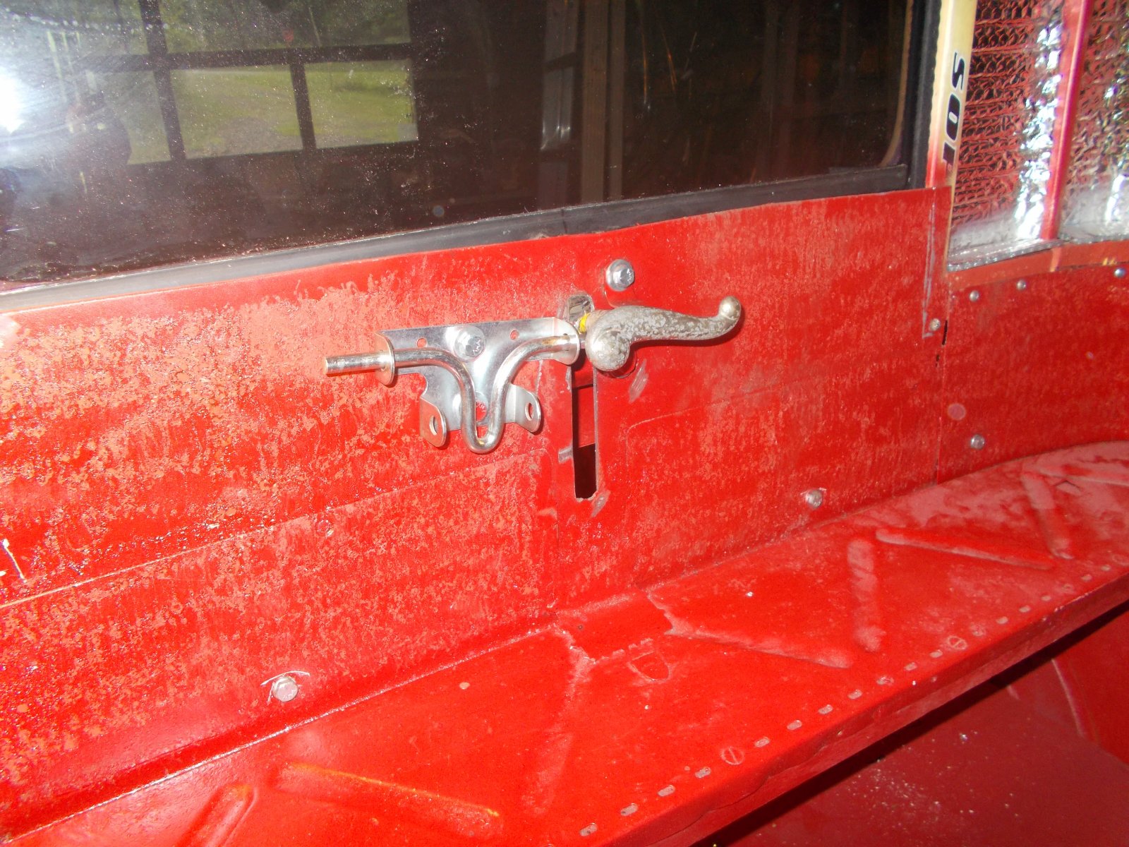

  1. Looks great! More pics of that cabinet please???
  2. SilverJimmy
    Joined: Dec 2, 2008
    Posts: 532
    SilverJimmy
    I don’t think that’s a cabinet, they’re fancy doors Brent hung. Go on the Garage Journal and it’s all there! Very nice shop that Brent built.
    loudbang, Stogy, cactus1 and 2 others like this.

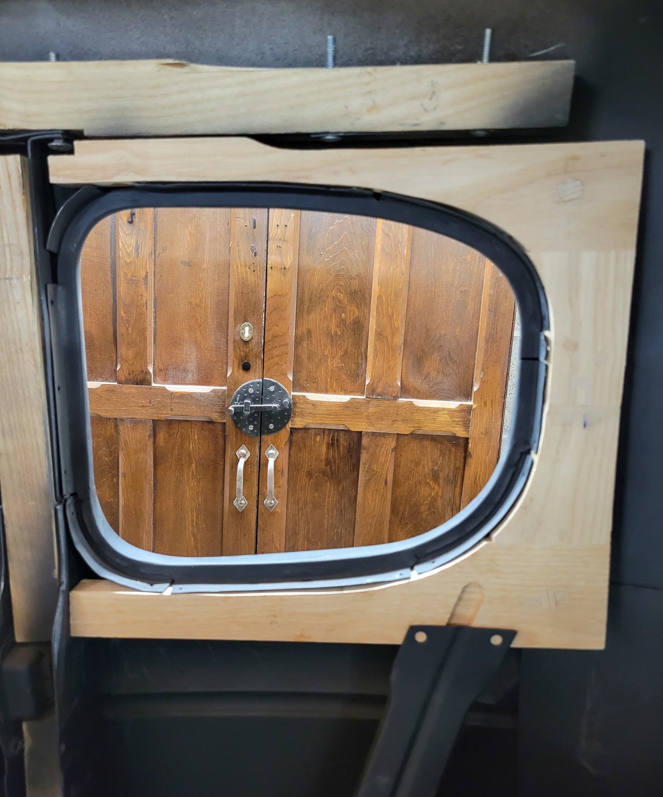

    Yes, they’re "barn door" sliders, of sorts. They’re from Italy, originally. I stripped them of a decades of lead paint, refinished and repurposed them.

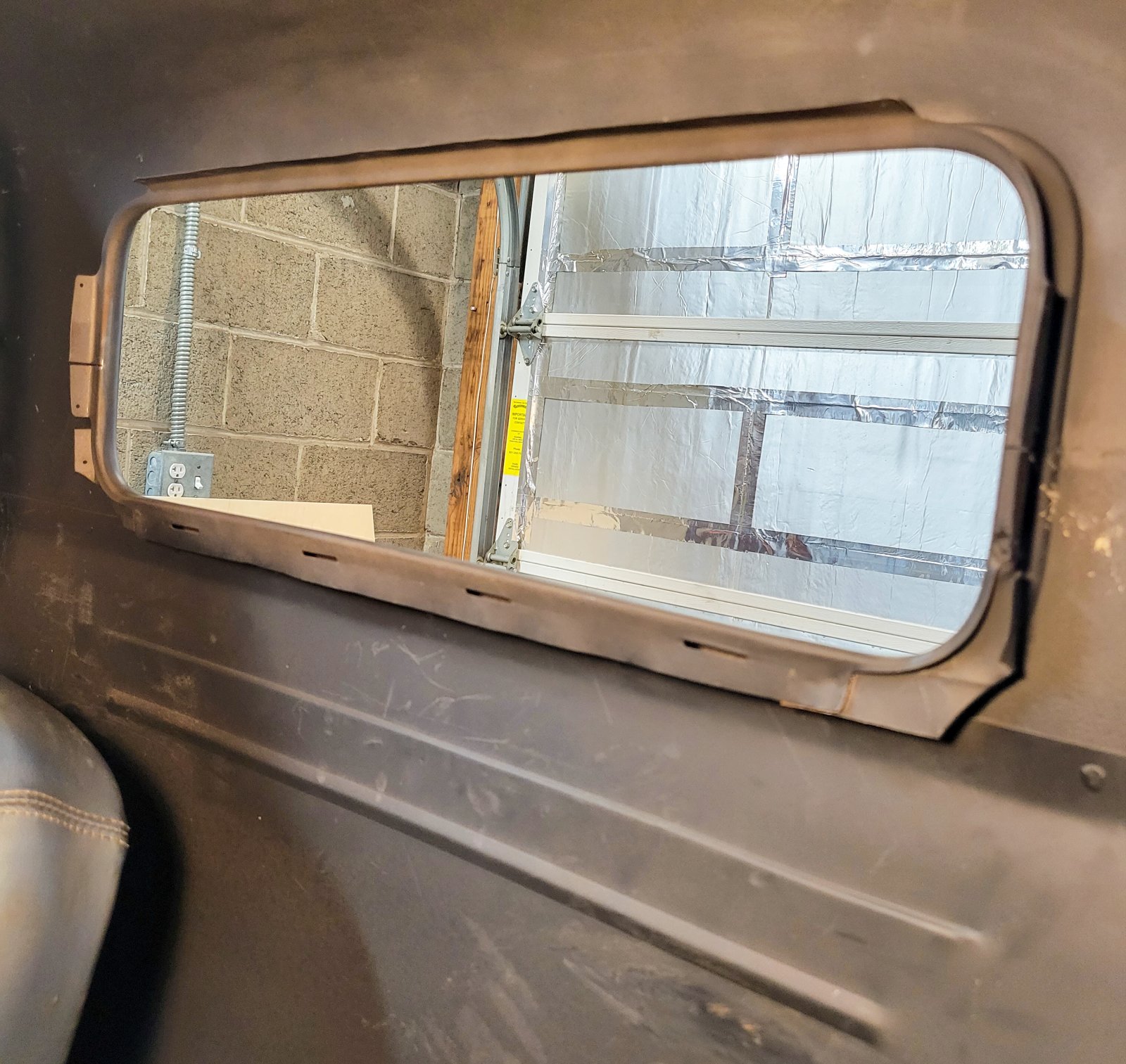

    Chopping Model A Rear Window Wood (Part 1: Converting a Deluxe Roll Up/Down Window Opening to Standard) :
    Hey, remember how I said:
    Well, I should have just kept that thought to myself. Hahaha!
    Last night as things were winding down at home, I went out to the garage to get the rear window wood chopped and fit into the coupe. I set the top piece in place and no issue, it made sense. When I went to test the lower piece, something was off.
    I'll be honest, I've NEVER paid any attention to the details of a rear window opening beyond casually looking at pics or, just recently, looking to see which way the wood is oriented.
    Because I was genuinely stumped, I went online to search for detailed pics. Again, this isn't something that a lot of people are chatting about. I made a post here and over on FordBarn and the HAMB came through late at night and confirmed what I was assuming after my searching - this body originally had a roll up/down window.
    Model A Window Opening For a Roll Up Down Window.jpg Deluxe Model A Coupe Rear Window Opening for Roll Up Down Window.jpg
    Since that doesn't fit the plan, I had to figure out what to do. The bottom of the window opening, where the metal has horizontal slots, that's for a window clearance and such.
    I want a standard, no frills, back window. I want simple and the most space as possible. I figured I should go about replicating the top side of the window opening.

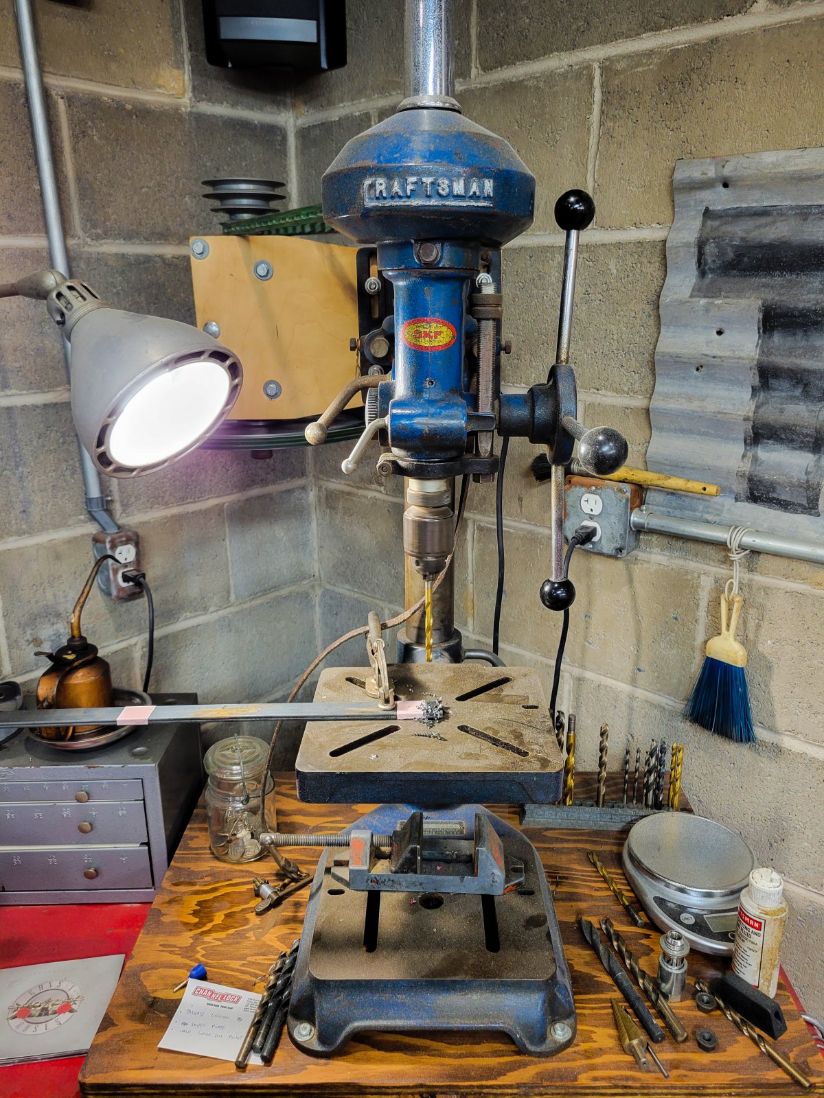

    With that gone, I grabbed a piece of 1/8" thick 1" flat stock and cut 2 pieces just a bit wider than the area I was working. I drilled some 1/4" holes and put some hardware in. That way both pieces would sandwich the sheetmetal the same.
    (The old, trusty Craftsman/Atlas drill press.)

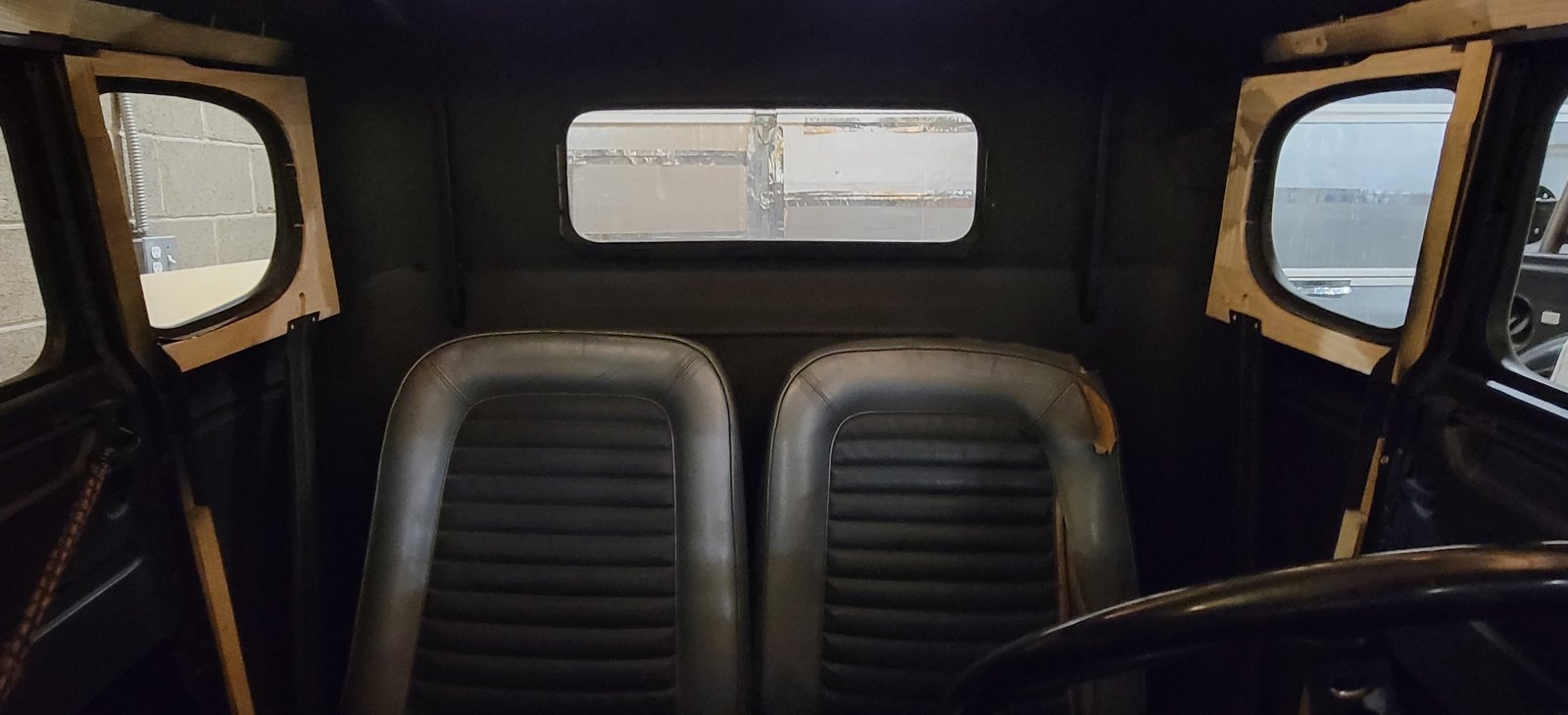

    Chopping Model A Coupe Rear Window Wood (Part 2):
    Back at it.
    First thing, I spent a minute and fixed the bend that didn't match up quite right.
    Then I got after fitting the window wood.
    Here's how the top joint fits. Since I was shortening, I figured I would make it fit all the way in the joint.
    I laid it in and marked it.
    I pulled out the table saw for this job since the pieces are flat and way easier to work with.
    When I got the top section set, I refit it and laid out the bottom. Then it was pass after pass on the saw.
    Chopped vs full height:
    I tested the chopped piece on the other side of the frame and it was close enough to copy.
    After both pieces were done, I sanded the lap joint sections with 150 grit and test-fit everything. If you look at the upper lap joints you can see how there's no gap anymore but they are a tad too long.
    Close up. The header portion and the side pieces were taken over to the bench and the contour was marked.
    Now we have another detail that nobody but us will ever see. Hahaha.
    And mocked into place:
    Before I can make this all final, I need to address a few pinholes in the chop and a little ticky-tacky weld stuff that got missed. All simple stuff for another day.

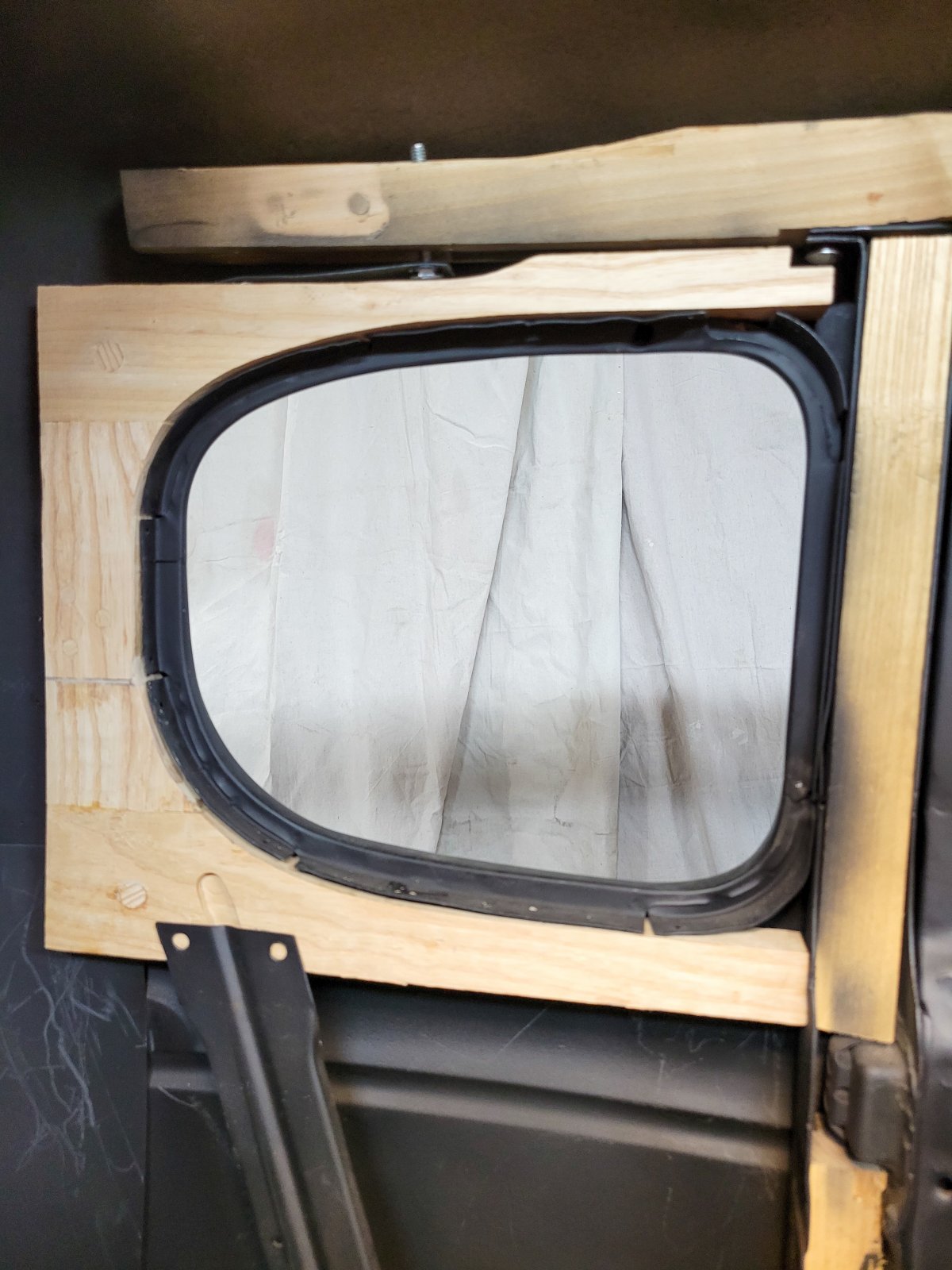

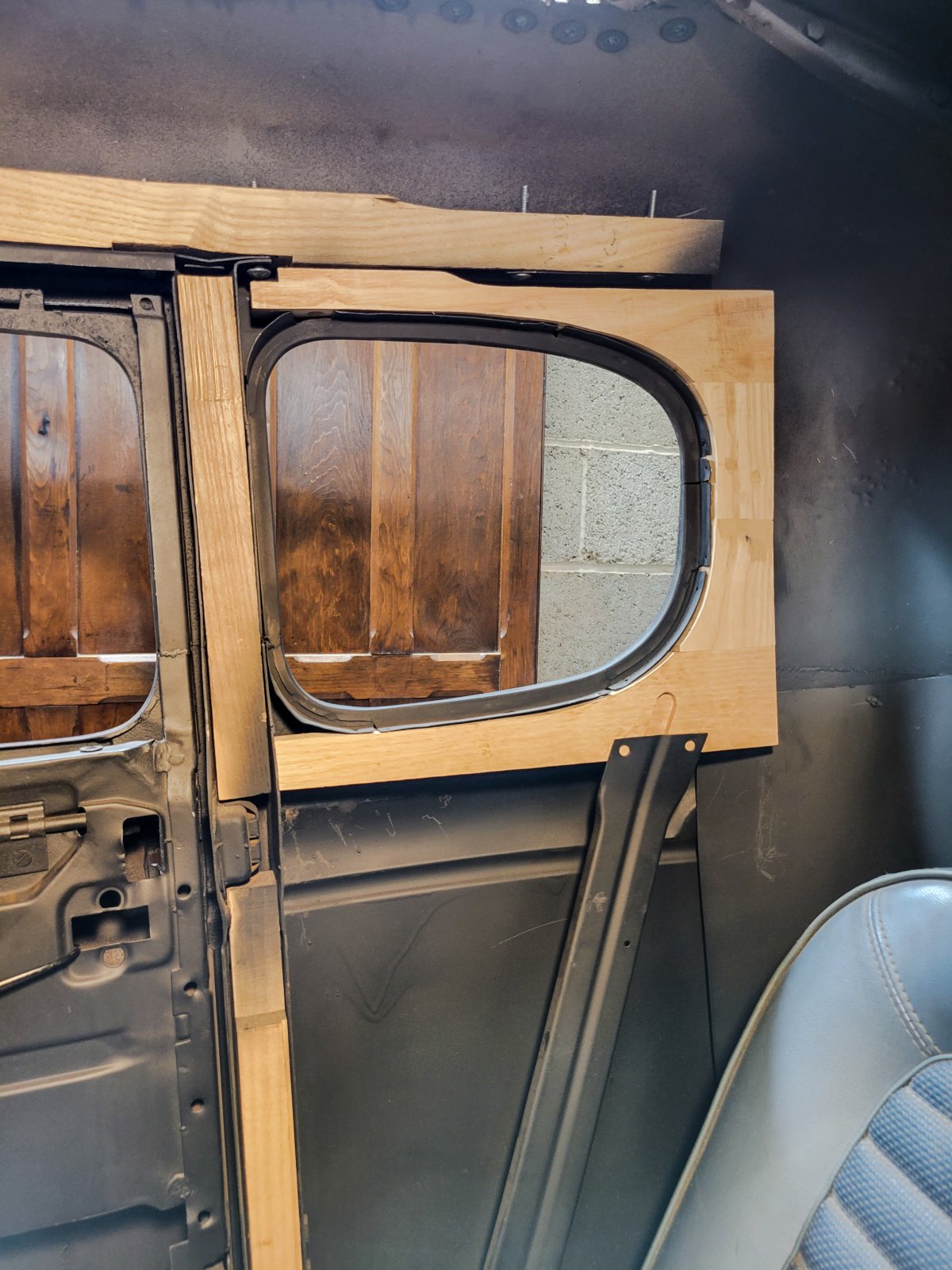

    Tonight, I put in an hour or so getting some random things done.

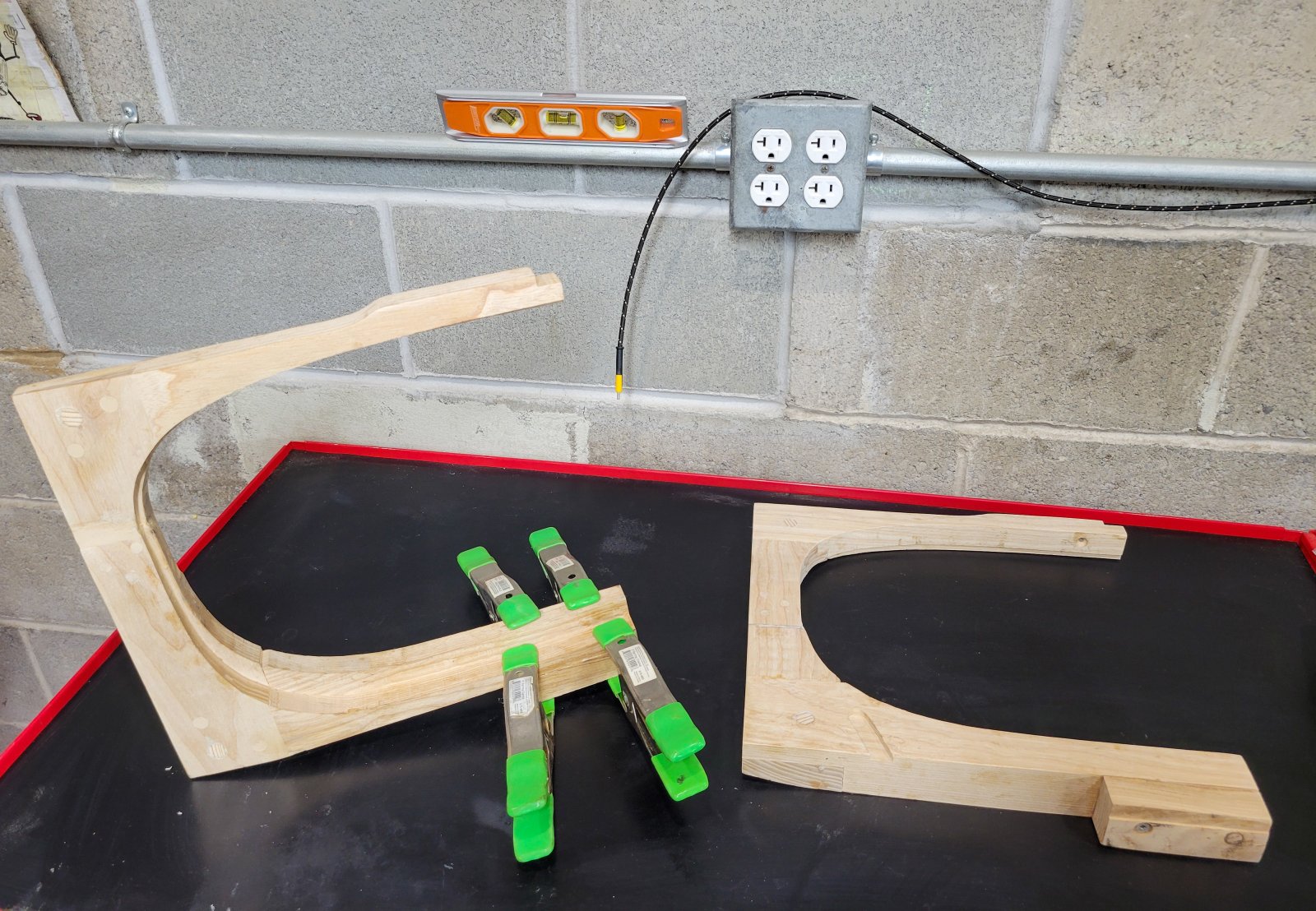

    The lower block/spacers that allow the bracket that connects the B pillar to the quarter window wood are done. I put dowels where the bracket screws may come close or hit.
    Quarter Window Blocks Clamped 2.jpg Quarter Window Blocks Clamped .jpg Quarter Window Wood Blocks Installed.jpg
    There's only a few things wood-related left to do.
    I drilled 3/32 nail holes, 8 holes to match the top.

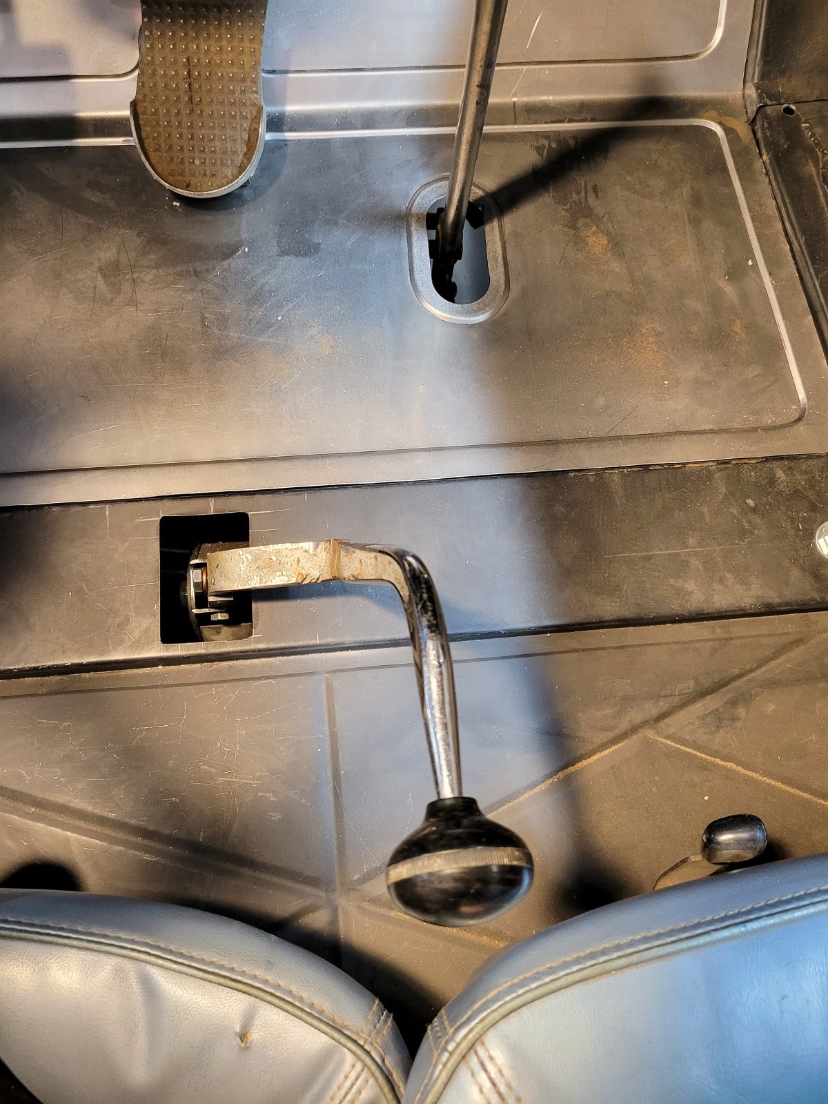

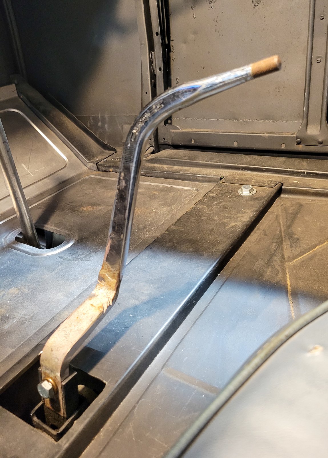

    One of the next projects is figuring out my shifter offset and height. I found this old, bent, and well beat-up Hurst offset shifter stick. I think the offset is probably the best it can be but the bend and height are wrong. The shift knob lands just under my knee when in reverse... haha.
    It had to be ground down to fit before I could bolt it in. Then, I cleaned up the threads and threaded on an old truck knob I had. I'm going to mess with this a bit, clean it up, and bend it so it's straight up from the second bend.
    Offset Hurst Shifter Stick Model A with 4 speed 2.jpg Offset Hurst Shifter Stick in Model A with 4 speed.jpg
    I'm still going to run the diamond shifter stick and I have some plans for that. I need to get some gas for the torch to bend some bar stock for an offset bracket.

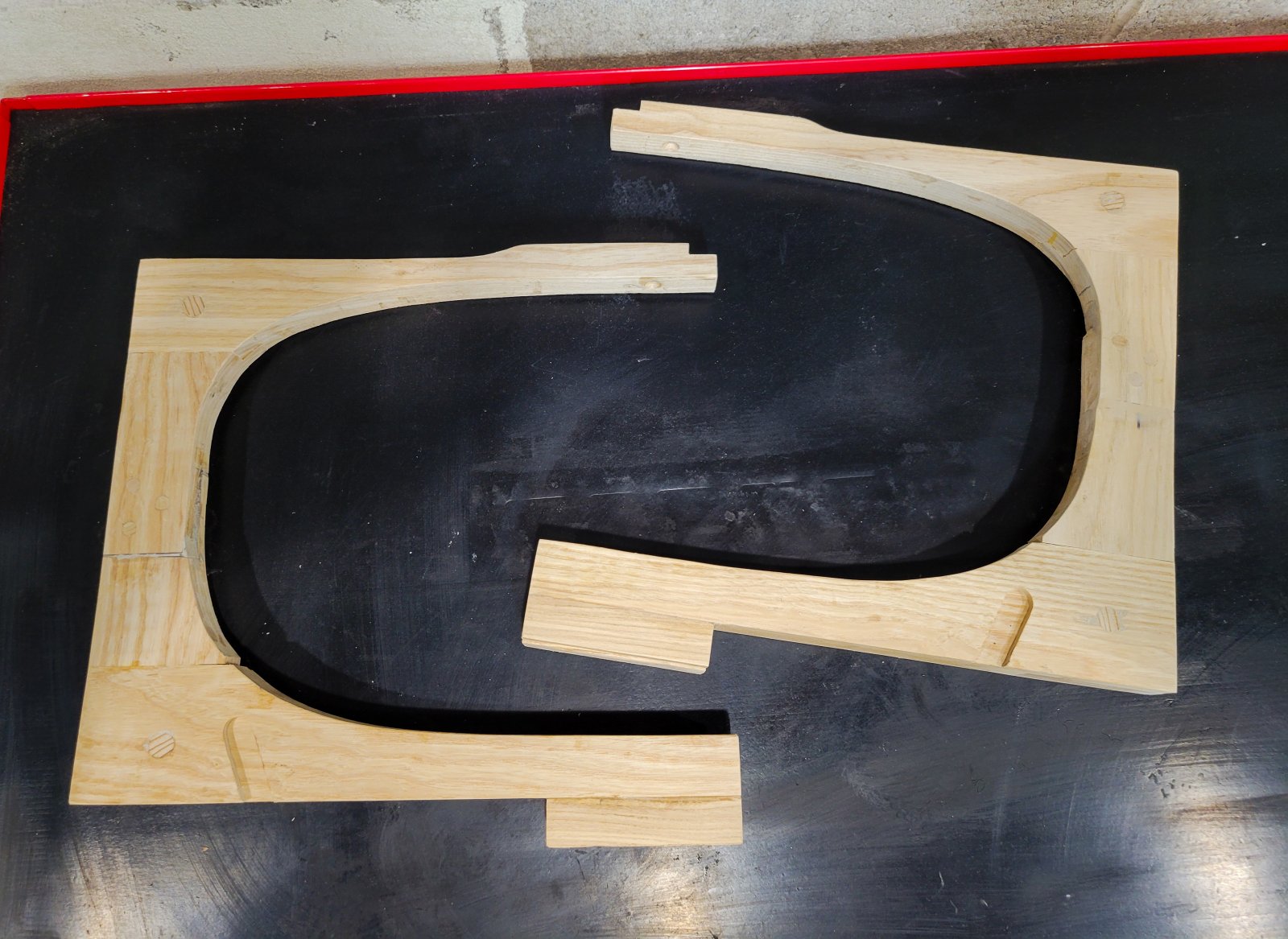

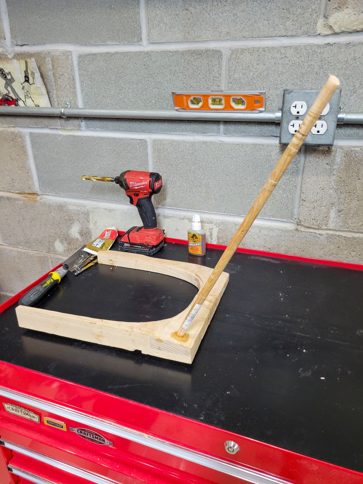

    I’m very green when it comes to real wood work. So to clarify you’re drilling a hole then inserting the dowl- press fit or glue?- in spots where a screw may land. Is this going to give it better bite when you screw into it compared to an untouched spot?
    Stogy, loudbang, Thor1 and 1 other person like this.
  24. -Brent-
    Joined: Nov 20, 2006
    Posts: 7,367
    -Brent-

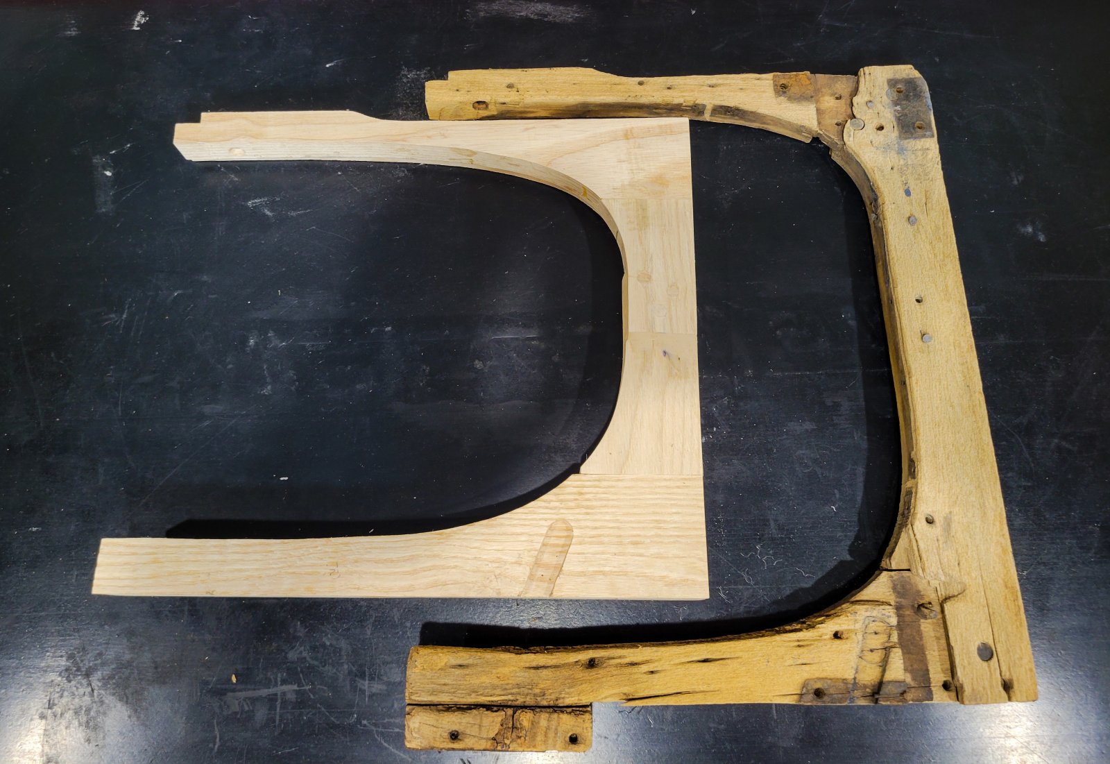

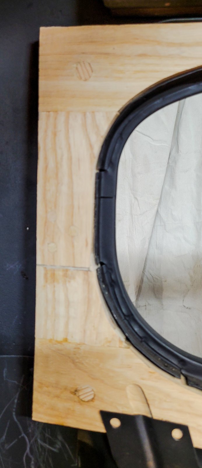

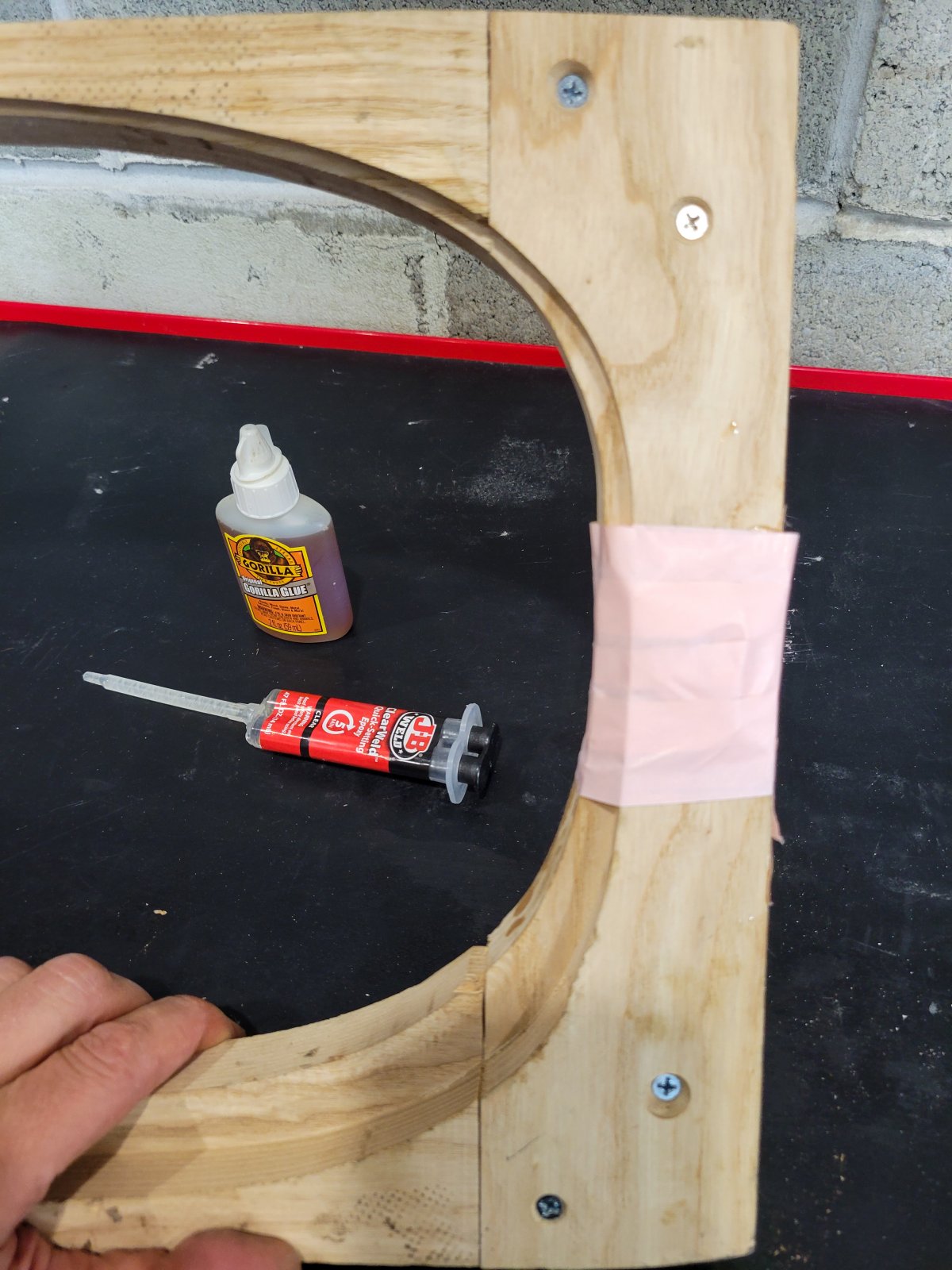

    I glued my dowels.
    It doesn't give better bite but in the case of these spots, there would be screw heads where the bracket mount screw would go. It's an old way to fasten a joint.
    Originally, Ford used dowels in their quarter window wood, too. (Ford's joints on the quarter windows were tongue and groove with dowels inserted.)
    Here is an original:
    Original Ford Quarter Window Wood .jpg Original Ford Wood Dowling.jpg Dowels In 1930 Ford Quarter Window .jpg
    On the other areas of the quarter windows I put dowels in to both fasten the joint (where it was chopped) and at angles in the corners to prevent screws pulling out.
