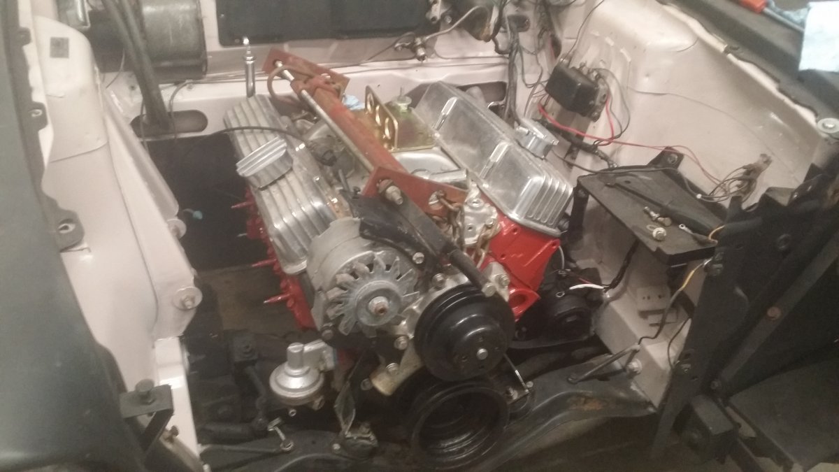

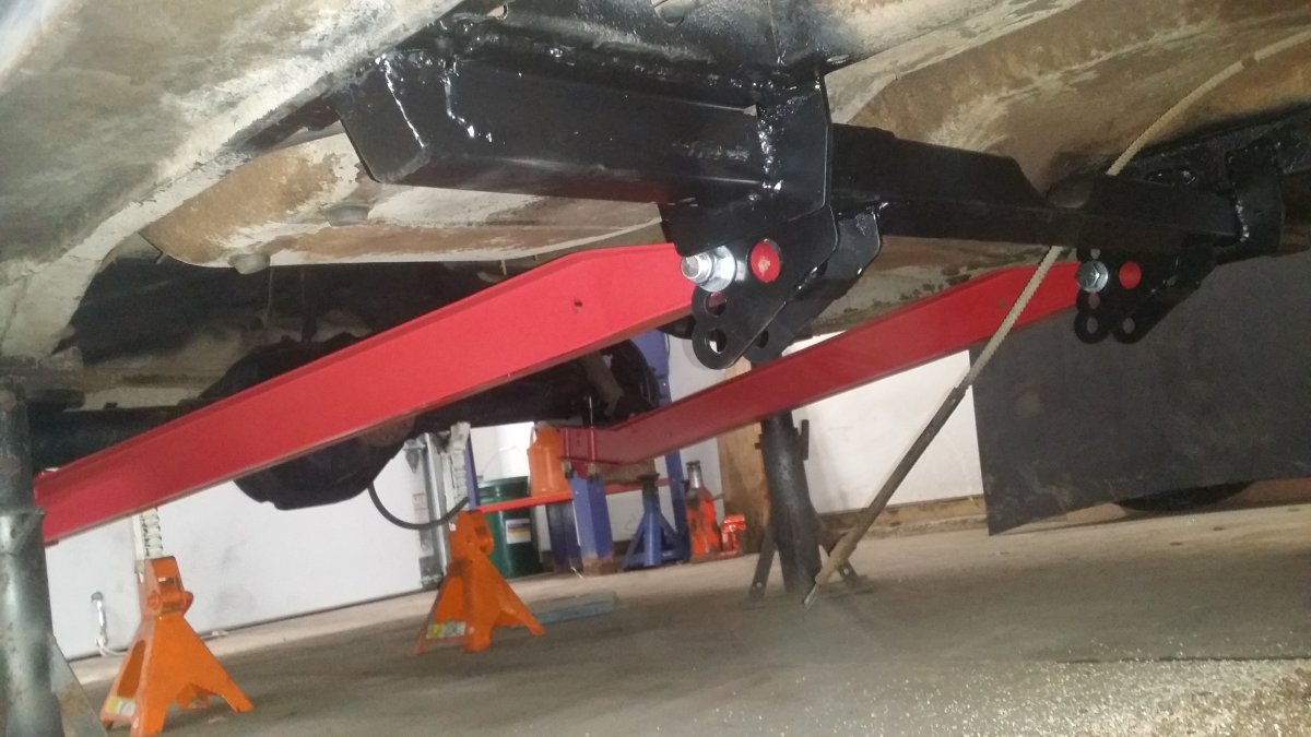

    Now this car had a torque tube driveline so I pulled it all out. I did a truck arm rear suspension with a Ford 8.8 rear end in.
    I put a sbc 350 with a turbo 350 trans in that my buddy had from a previous project.

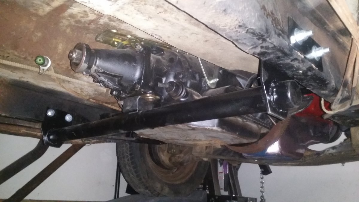

    Motor mounts were just tacked in at this point. I used the front mounts on the sbc to the original rambler rubber mounts. I also made mid mounts off the bell housing.
    So that's where im at now. Still have a ton of work and hours into finishing it but it's come along good so far. I'm going to redo the interior close to stock and am undecided about paint. There is some original paint under the rattle can primer so I may try and get back the primer off and show some of that. Not sure yet.

    I would be interested to know how well the front mount/rear of tranny mounts work for you. I've always heard you shouldn't span from the front clear to the rear. Either side engine mounts with a rear tranny mount or front engine mounts with a mid/bell mount. Love the Ramblers!

    Read it again, he said he made side mounts off of the bell housing.
    54vicky, Tim and Hnstray like this.
  20. Rambler man Dan
    Joined: Mar 24, 2018
    Posts: 40
    Rambler man Dan
    Yep fabricated mounts off the bell housing just in case. Cause I love overkill. :)
    20180324_210504.jpg 20180324_210454.jpg My buddy has a 56 Chevy with just the front and back mounts and has way more Hp than I am planning on. But I couldn't leave well enough alone.
    I used 1/4 " flat stock and a universal rubber mount bolted to angle I welded to the rambler frame members. Bolted to the bell housing with grade 8 bolts to.

    Personally, I've not had any issue with front mounts, and a transmission extension housing mount. This was a 56 Chevrolet Pro Bracket car, with a BBC and an aluminum Powerglide that had the cooling holes in the bell-housing. BUT, I had a Hurst saddle mount at the front that really limited any torque over. I know a few people who did things in a similar fashion. Using stock Tri-Five type front mounts , that are spaced very narrowly; that's the reason for the bell-housing mounts in the Tri-Fives. And, I've seen cars with a later model aluminum automatic transmission using front mounts, fabricated bell-housing mounts, and NO extension housing mount; those are the ones that bothered me; the transmission just hanging out there like a stock Tri-Five would have been. I'm sure there are guys who have problems, no matter how things were mounted. I think you'll be fine Rambler Man Dan.

    Every time I have seen someone use the front mount on the block and rear trans mount, they ended up with a puking front pump seal on the T350. I think you just saved yourself some headaches with those middle supports.

    Are you using a Panhard bar to keep the rear end centered under the car ?
