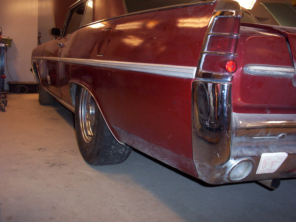

    Steve, I spent the day getting the rearend all in and the front end back on (seat back inside too) for a show tomorrow. It was nice getting it on the trailer with real steering. Last couple of times I had to kick the front tires to steer it. Kinda embarresing at the car show.
    Just some shots of the car.
