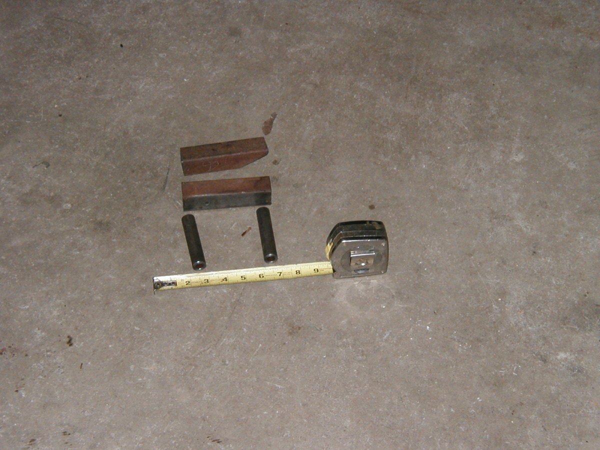

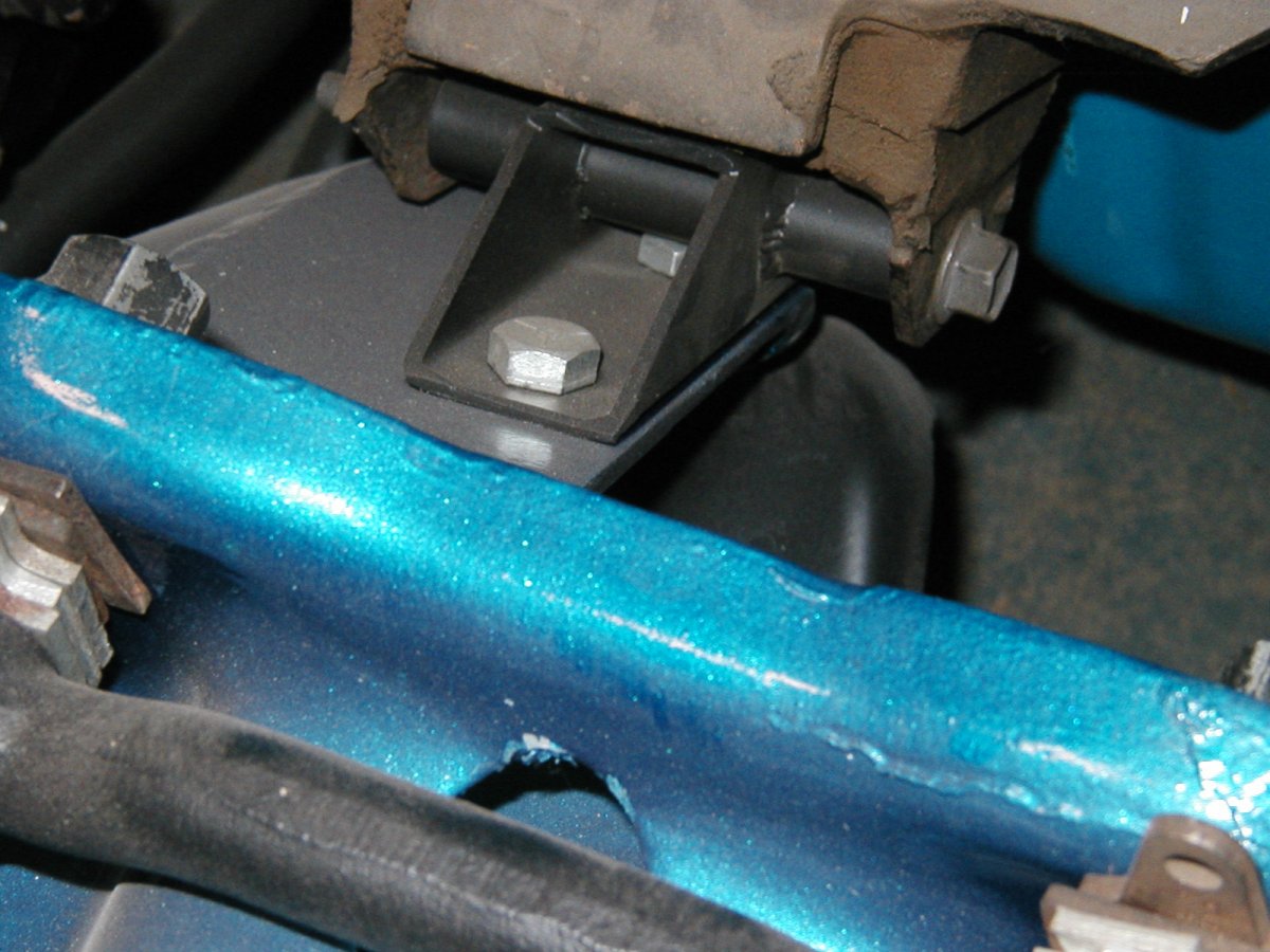

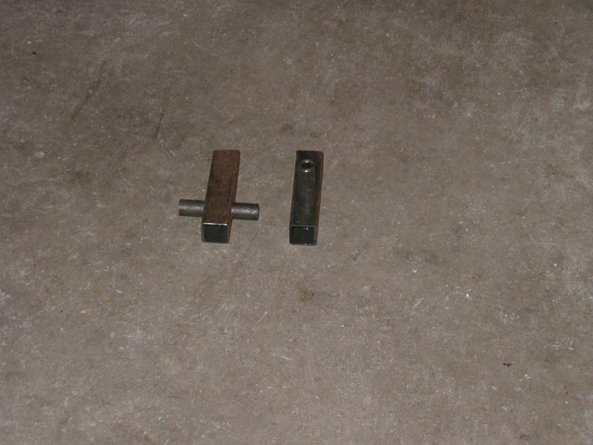

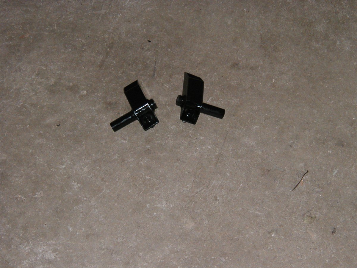

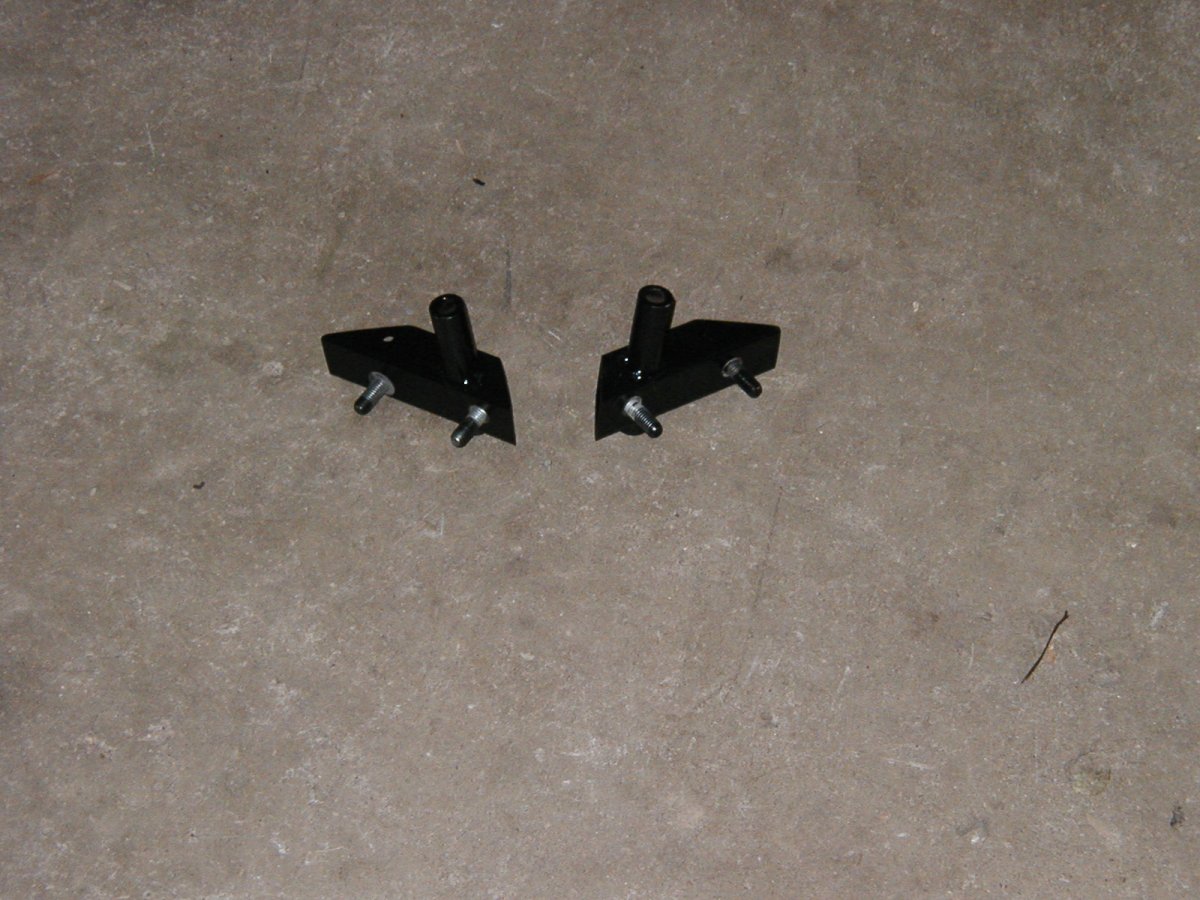

  5. Motor mounts are a walk in the park. Done them many times.
    57 wagon mounts 001.jpg 57 wagon mounts 002.jpg 57 wagon mounts 005.jpg 57 wagon mounts 006.jpg Mounts installed 002.jpg Bolts to existing holes with Ford mounts. For the AOD just get a 59 Cruzo-matic mast jacket. Eazy Peazy!

  6. Clint86
    Joined: Mar 15, 2014
    Posts: 93
    Clint86
    Those are frame side mounts? I was planning on using the rubber mounts already in the car and fabricating the engine side. It’ll probably be a similar process I’d imagine. I’m not keeping it an automatic, I’ve got a mustang 5 speed T-5. It’s going to become a manual car.

    The Wizzard
  9. Clint86, I understand your thinking. Something to know. 59 Mounts are 59 only. Getting harder to find. New ones that say they are 57-8 & 9 all made in Mexico. Not an exact fit. Actually don't fit any of the 3 correctly. What I like about the Frame side mount adapter is the angle is no longer in play. The through bolt takes care of that. You can also use Fairlane/Mustang rubber mounts. Readily available and covers many years.
    The Wizzard
    Hnstray likes this.

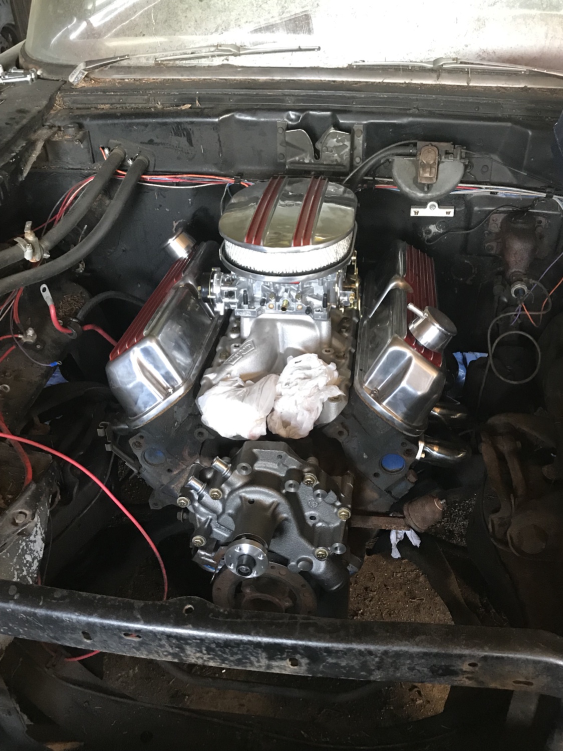

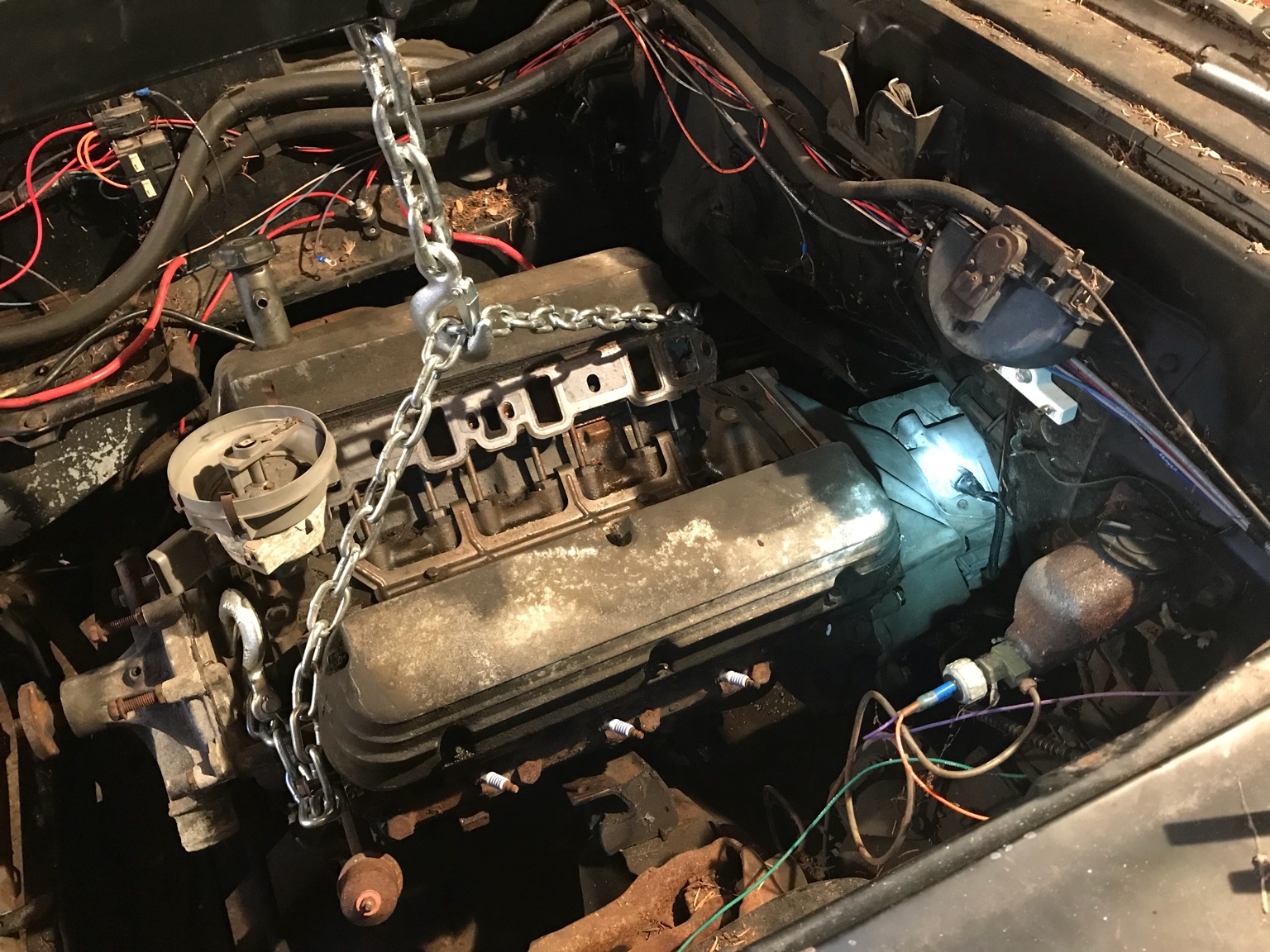

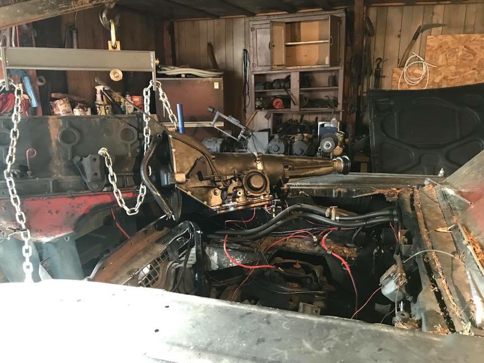

    So, still haven’t gotten to the engine mounts yet, but the old is out and I finally opened enough room to fit the new in. I had to ditch the truck oil pan and go with a front sump/pickup tube. Also found out that I have to fabricate a new trans cross member. Fun times all around at any rate. If it was easy I’d probably think I did something wrong.
    Out with the old! If you look closely you’ll see the #2 connecting rod next to the dip stick.

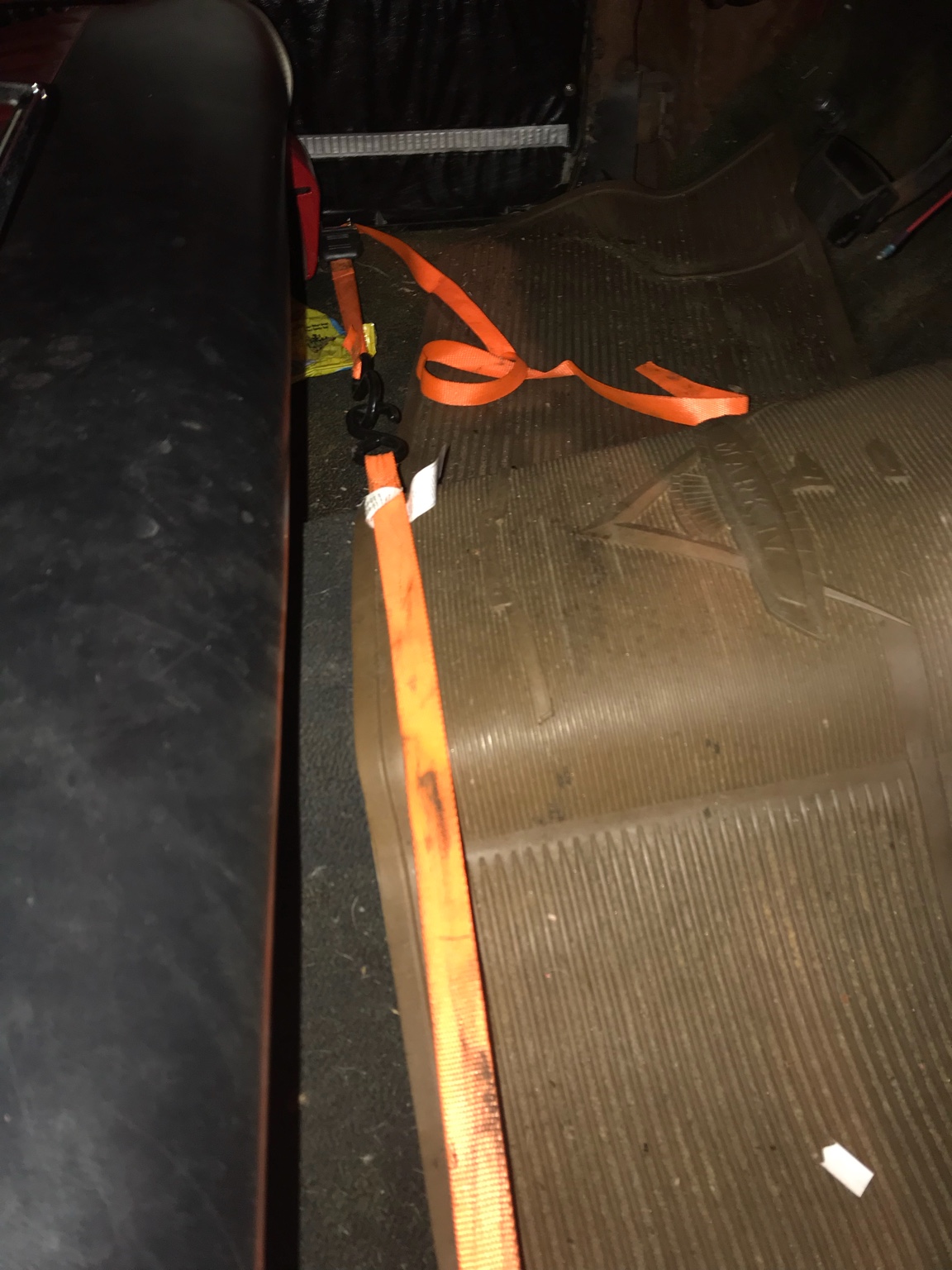

    In with the new! The orange strap shows where the back of the shifter base is located. Perfect location, I was dreading that it would end up under the seat.

  12. Excellent engine choice Sir. That "289" looks right at home in that big Ford.

    Nice but I might have given it all a bath first....

    For a split second I thought you had the engine in backwards. Not used to seeing the distributor. Anyway, good luck with that crazy Ford in a Ford thing you got going. :)

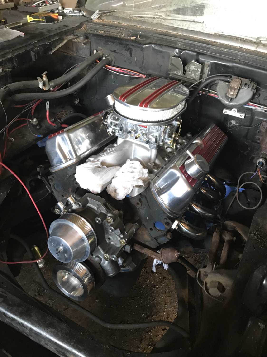

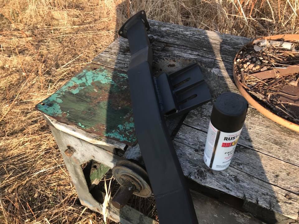

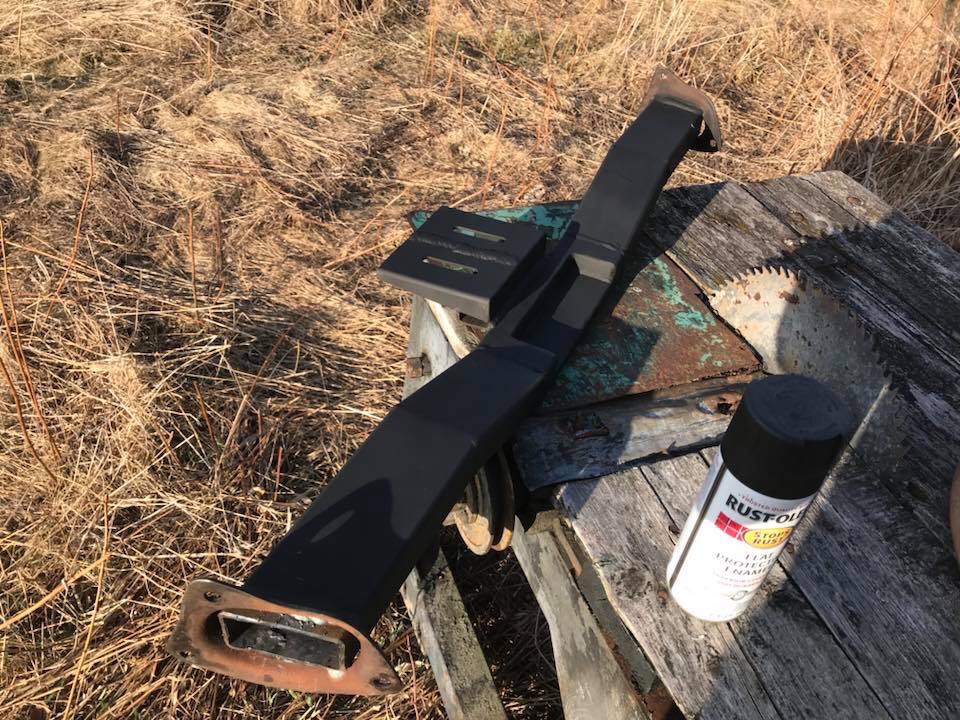

    Progress has been made finally. More steps are being taken in the forward direction than are being taken backwards. I’m sure you’re all familiar with this feeling. I’ve opened the block up a bit and looked further into it’s condition. Turns out it’s an 87 pickup engine, factory machined for a roller rocker system, can anybody confirm that about the 87’s? Timing chain was almost at the 1/2” of allowable play, replaced it with a cloyes double roller. New timing chain cover, new carb, new valve cover air intake combo, custom built trans cross member, new water pump, and a new serpentine belt system. My original idea of a budget build went out the window.
    Cross member beginnings
    Cross member revision
    Cross member final
    Getting closer to the final bolting in of everything. Lots left to do however.
    Pist-n-Broke and BAD ROD like this.

    More work done, I heard it fire. Still needs fuel plumbed up and the radiator installed, plus timing. But hearing it fire is encouraging to say the least.
    All set to make a little bit of noise.

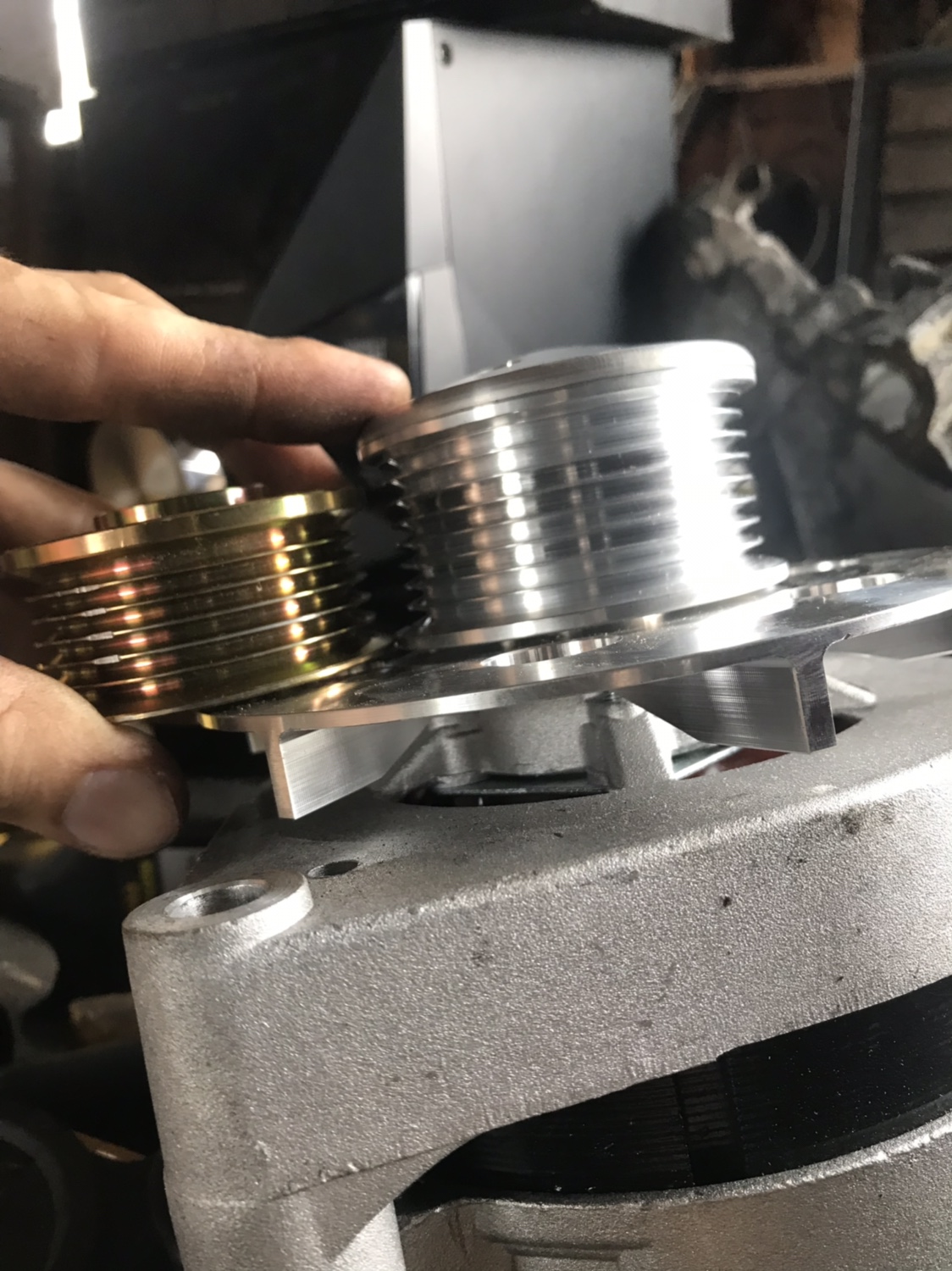

    Billet aluminum 8 groove pulleys, should do the trick.
