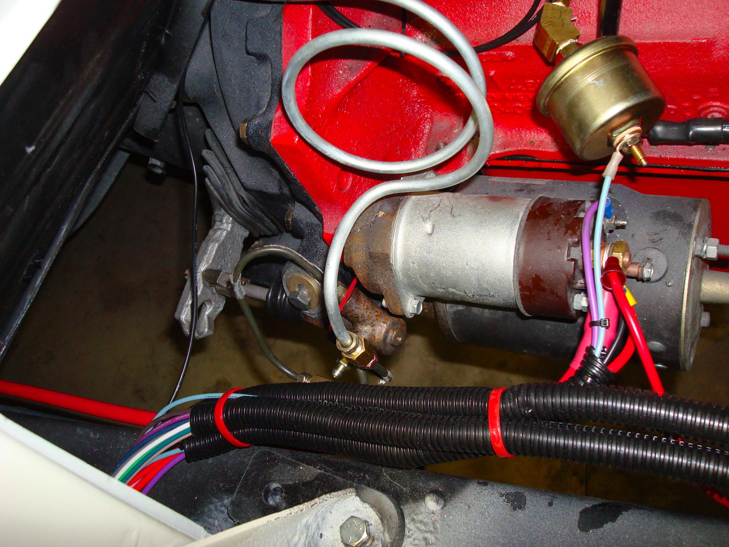

    I had big plans to run a small block fly wheel that I had laying around. I had it resurfaced and stuck it up there only to find it was too small. So I had to buy a 292 flywheel. The 292 uses a starter that bolts to the block, but of course the old bell housing uses a starter that bolts to it. I think my starter was for a 409. Yours looks a little different than mine and I was just wondering if you knew what it was out of, or if it was some high torque aftermarket job. Here's a build picture. Are the starters the same?~WX1

    Hey wolfex1 when I bought the motor the starter came in a box with it and it bolts right up to the 62 bell housing here are some pics, I've never even herd of these started but it looks pretty cool

    No doubt someone here on the HAMB will be able to identify this type of starter for us. Looks like a gear reduction from here. ~WX1
