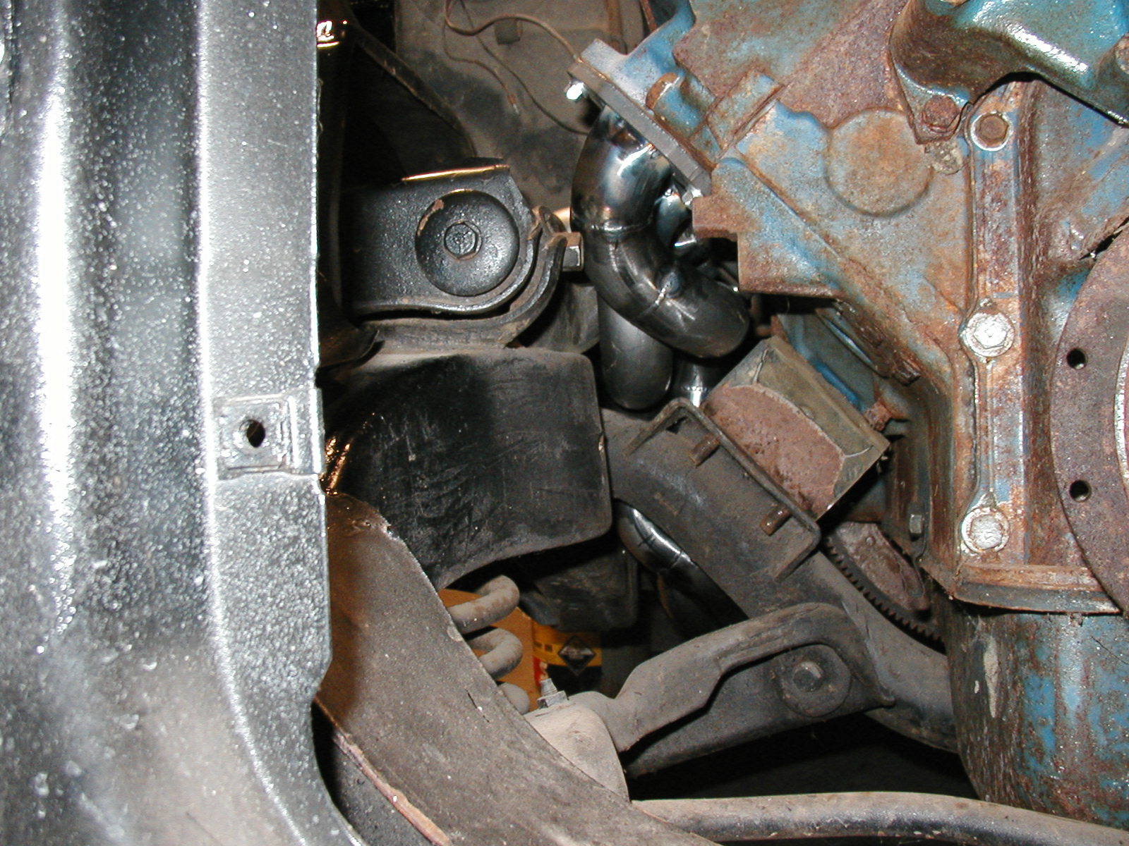

  7. Make sure your motor mount is turned so the opening is facing to the rear as in the photo or you'll find other issues as you go. See photo. No you will not find a mount to directly bolt the Mustang trans to your stock trans mount (I've tried all stock trans mounts) . Rotating the cross member is totally out of the question. Just go look at it, it's self explaning. I use the stock 57 Ford trans mount and a piece of 3/16 plate and drill 4 holes. 2 for the stock 57 U bracket to bolt to and 2 that fit the tailshaft holes. Quick, Simple, No big deal. Also I've learned not all Ford FE bell housings are created equal. Also you need a 58-59 left bank exhaust manifold unless you are doing some kind of headers. Make sure you have the correct one for your "Car" not just the motor or you will have clutch issues.

    I have the mounts as pictured and there is no way in high hell the crossmember can be flipped. it's not a straight lined frame and angles in towards the front. i'm thinking i'll just make an adapter out of plate like pist-n-broke.
