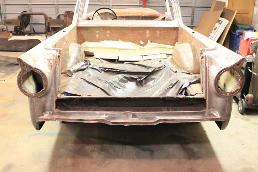

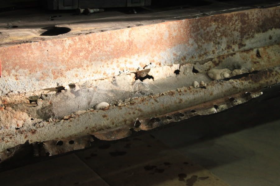

    Okay here is my 1957 Ranchero build. This is my first 50's style mild custom build and by far the most metal work I have ever done on a car. It is pretty minor to most of you on here but big for me. Alright here is the plan:ffice:eek:ffice" /><O:p></O:p>
    -Mild Custom (shaved (not sure about the door handles yet) and lowered)<O:p></O:p>
    -390 with a 4-speed<O:p></O:p>
    -9" rear<O:p></O:p>
    -White Walls with Olds Caps<O:p></O:p>
    -Mercury front and rear bumpers<O:p></O:p>
    -Very simple and clean<O:p></O:p>
    <O:p></O:p>
    I look forward to everyones input and suggestions. Like I say this is my first build of this kind so here it goes......<O:p></O:p>

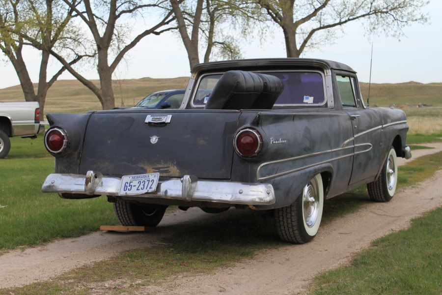

    Here is what I started with after I cleaned about a foot of dirt out of the back and inside, painted the engine bay, and put my wheels and tires on it.

    The engine all cleaned up before I found out it was completely locked up. Glad I got it for free and didn't have it in the car when I found that out. It was suppose to be a running motor.

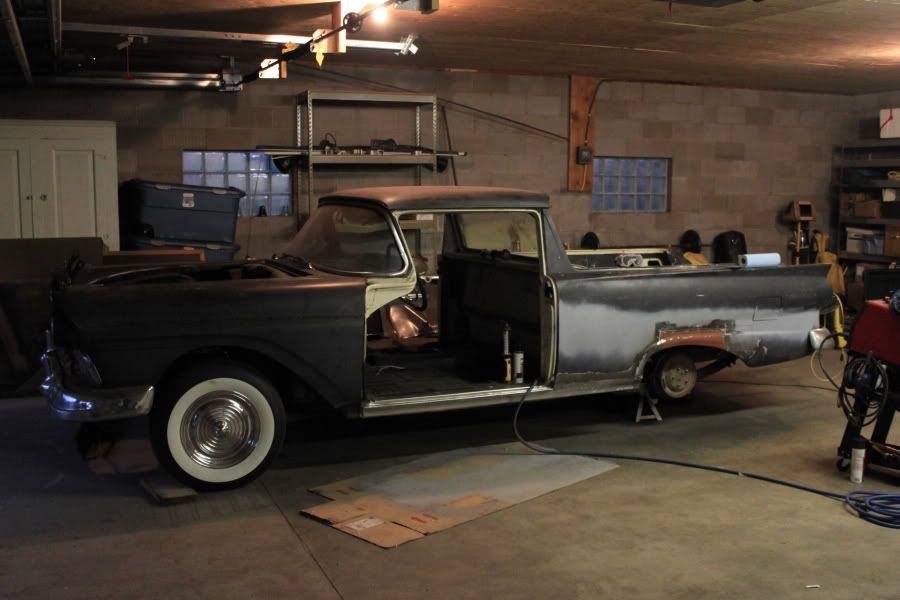

    Got it covered in the this last batch of pictures. Didn't want to ruin my good wheels and tires so I finally found some rollers.

    Lowered the front with Aerostar coil springs. Dropped it about 3.5 inches.
    Got the motor rebuild and installed. Should run really good.

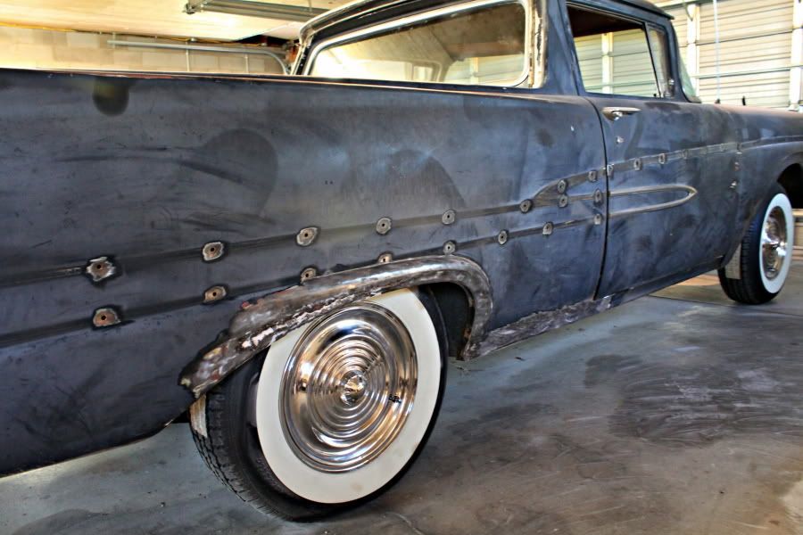

    Why did you ditch the side trim? Just curious

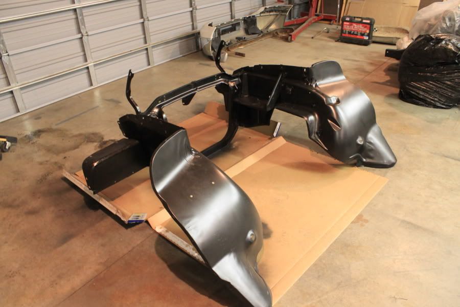

  15. Wow, that's a lot of metal work. You are doing a nice job so far, my '57 need's some of the same wheel well and rocker work.
    Who's patch panels are you using?

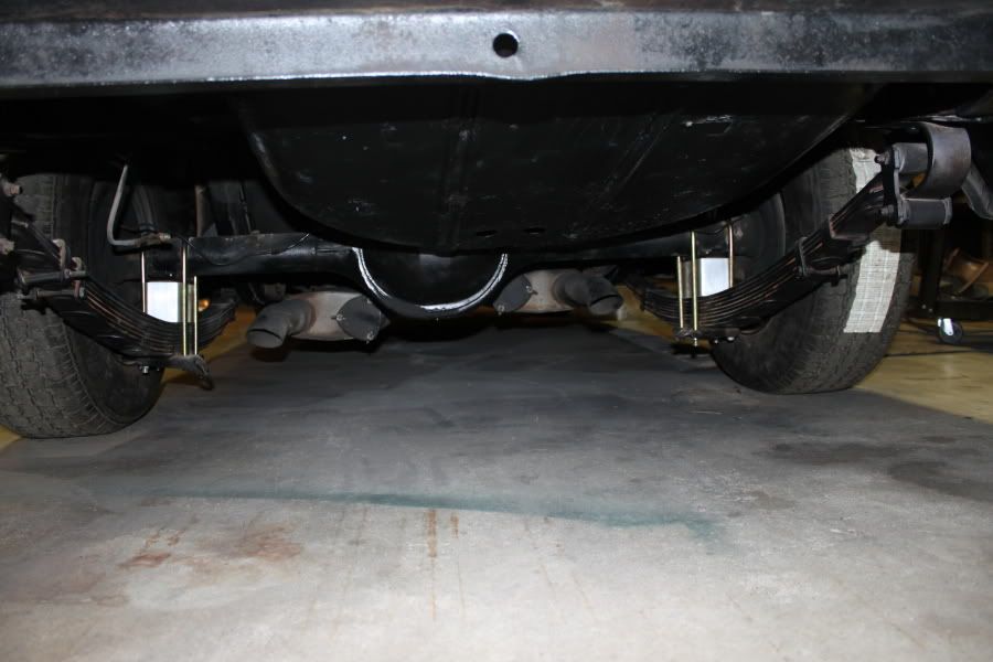

    Got the back dropped down to match the front.
    That pretty well gets the project caught up to this point. I will be posting more pics as soon as I get a chance.

    I know your gonna jump on me for saying this, but I think you'll regret shaving the side chrome.
    We have a '58 ranchero in the shop that we shaved the side chrome on really takes away from the car. We wish we didn't do it.
    I know it has a "Kustom" element to it, but I like the side chrome.

    I was going to put it back on but I just decide to go without it for a different look. You don't see to many of them without the side trim. Just being different I guess.
    I'll keep that in mind if I decide it is to overwhelming at some point.:D Thanks for the compliment. I got this one from a salvage yard, couldn't let it get crushed.
    I appreciate it. I have been using Dearborn patch panels. Not sure if the panels are theirs or if they get them from somewhere. I have liked everything I have ordered from them so far.

    I understand what you are saying completely. I am still not sure about it. I have 57 chrome to go on it if I decide to go with it. I also have a some 56 Buick side chrome that I thought about using. Still up in the air but it is going to be clean at this point.

    So is it a 58 with a 57 front clip or a 57 with 58 side trim.

    At first I was told it was a 57 with 58 trim but after running the number and the title it is a 58 with a 57 front clip. I am completely changing it over to a 57.
