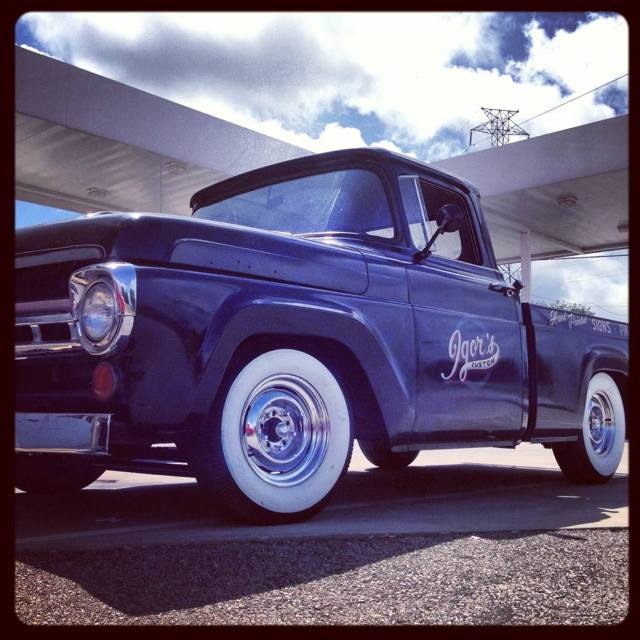

    Picked up dis 57 f100 from Rust a month ago. Dropped it a little and put some wheels n rubber on it. Slowly gettin the letterin done as time allows. Here's a pic when I got it ImageUploadedByH.A.M.B.1373409249.279879.jpg
    And here's how it's lookin after a month. ImageUploadedByH.A.M.B.1373409302.693382.jpg
    Tried to do a little thread on lowerin it but I didn't take the time to take pics as I went along. Sorry!

    Great stance, how far did you drop it?

    Thanks! 2" axle. 1 1/2" springs and back is just a flipped axle with a c notch. Drives great! Used dropped tie rod ends instead of orig plan of tie rod drops. Not a bit of wobble, bump steer or anything. Just straight down the road.

    Looks pretty level, I always thought when you flipped the rear you got around 6" of drop and would have a "rake" affect if you didn't come close to that up front. I'm gathering notes for mine and want to drop it, just nothing crazy. Your's looks spot on man!
