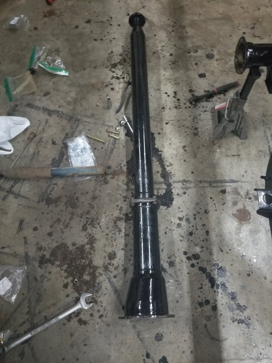

    a bit of progress today . Got the rear end housing in . New springs , shocks , grade 8 bolts . Got the torque tube tore apart and put in a new driveshaft bearing and U joint and got that all put back together. The U joint was a pain to find. I ordered both u joints oldbuickparts had listed for 57 and niether fit. Ended up just measuring it and matchimg it up. I belive the one I got that fit was from a early 60s galaxy. Strange. Rolling chassis is getting there.
