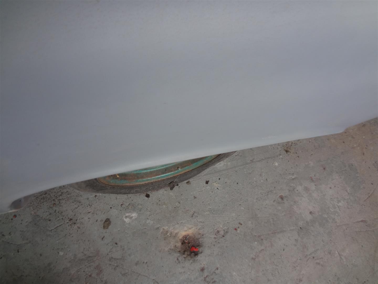

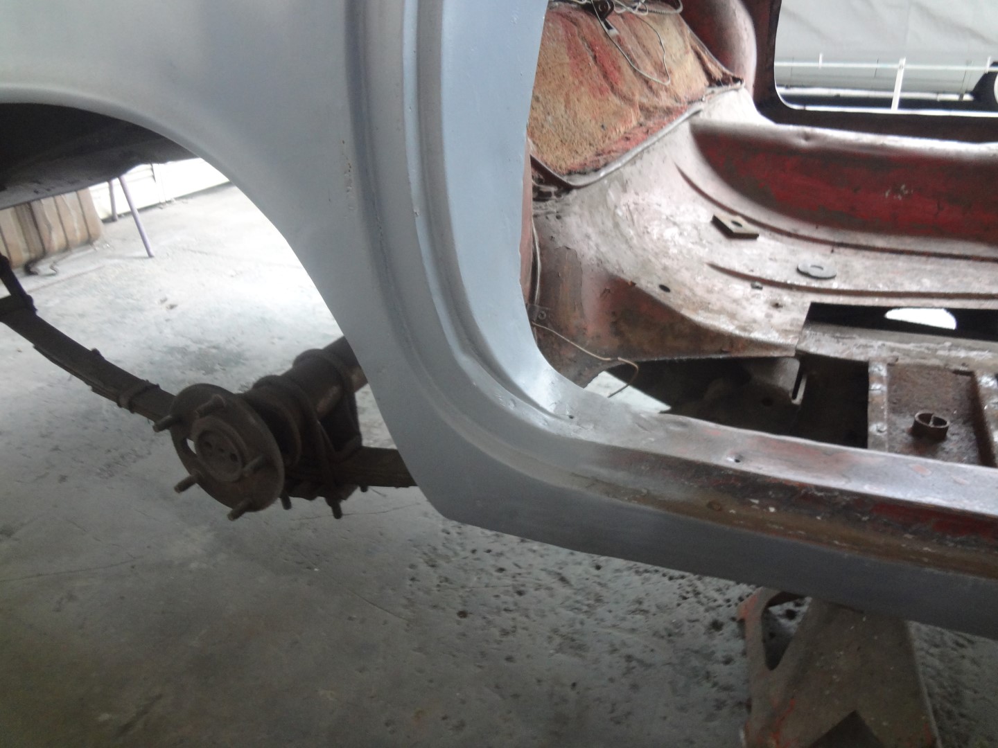

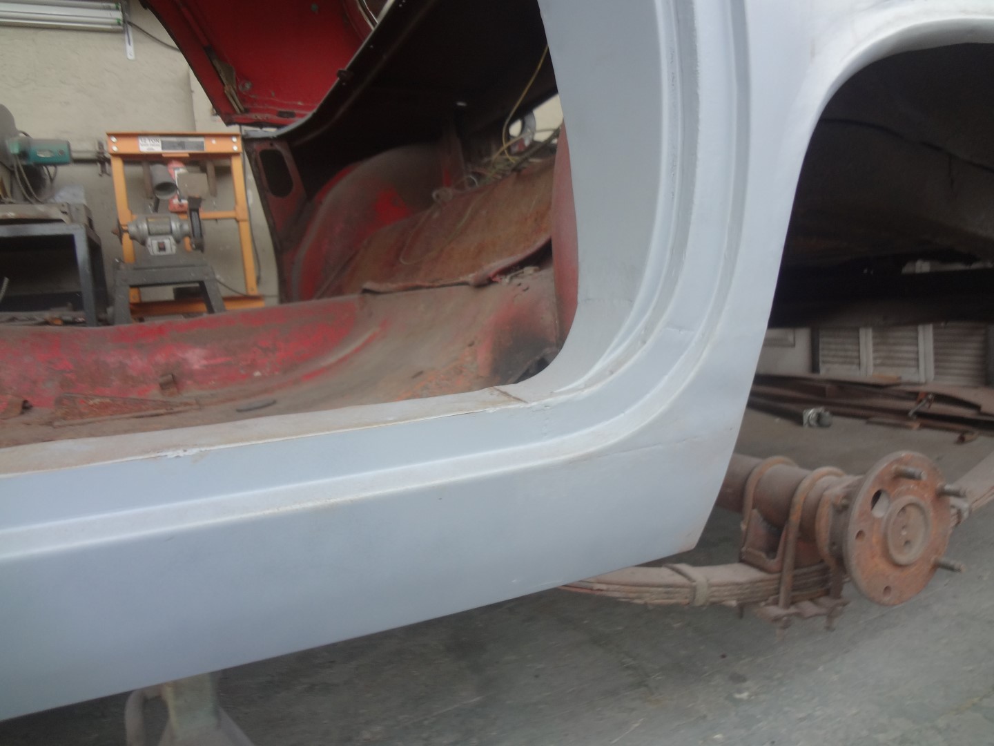

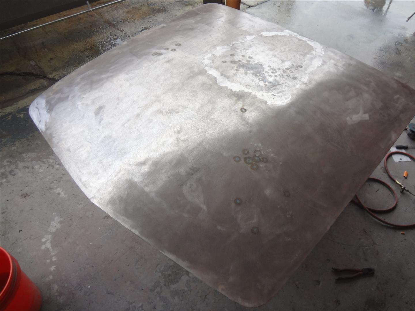

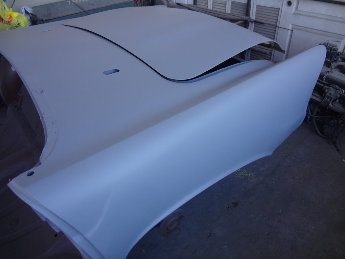

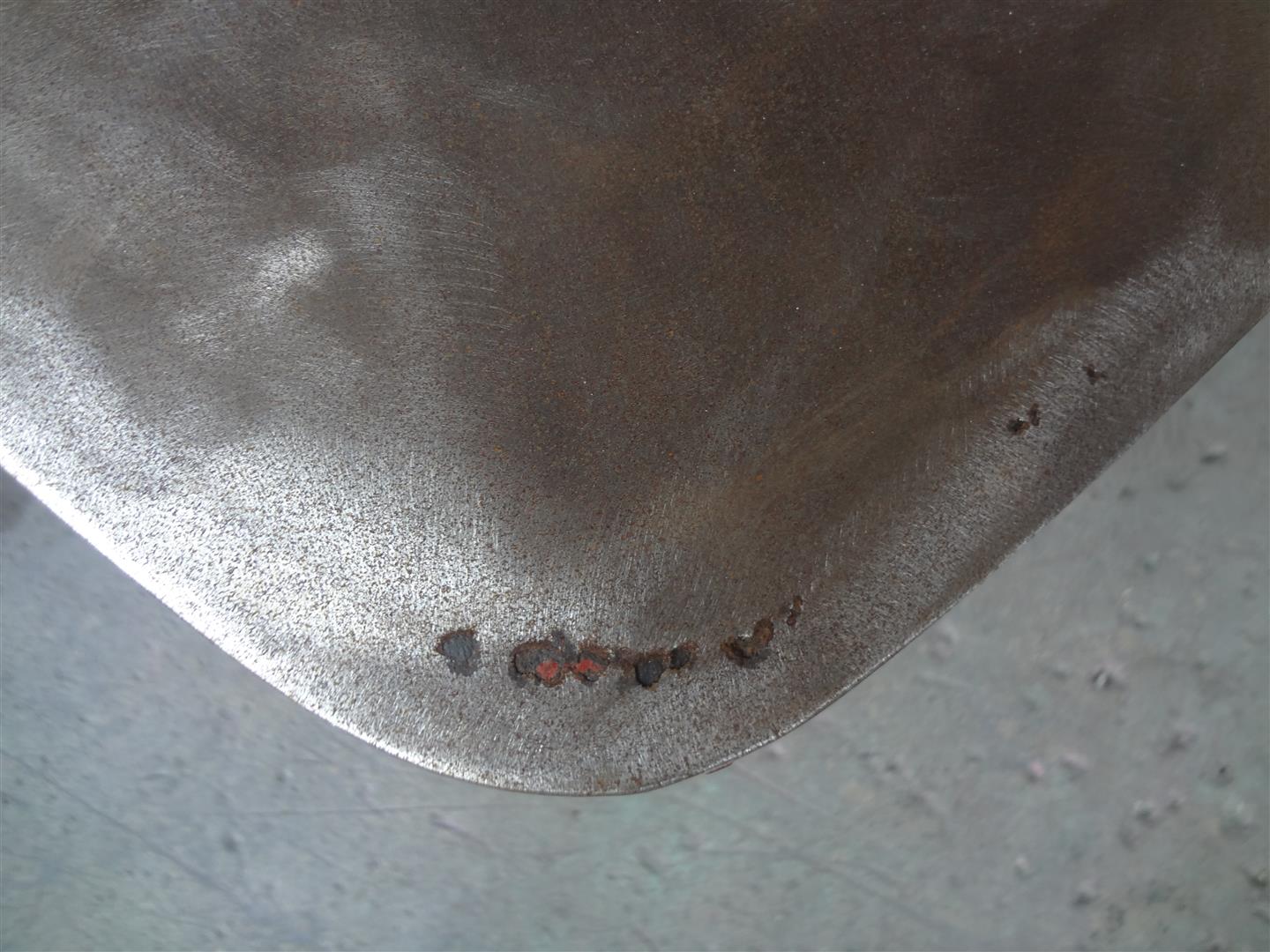

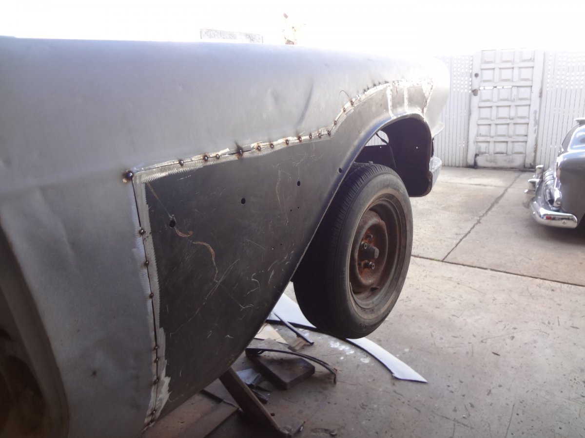

    now its time to start fixing all the problems we found under all that red primer and bondo! the hood was "out of shape" so a lot of hammer and dolly to get it straight again, making sure to keep the lead work. driver front wheel opening was really rusty and missing metal, so a section was hand formed and welded in, also that fender if you see pic was way in too (see pic with ruler). the passenger door only had small rust patch to do on the lower corner and the driver rear wheel opening if you look at past pics was also "out of shape", now its been hammer and dolly back to shape. the driver rocker repair was cut off complete! new metal is being made to fix it keeping as much of the original rocker as possible. we will fix the inner rocker when we do the floors and body mounts that need replacing.

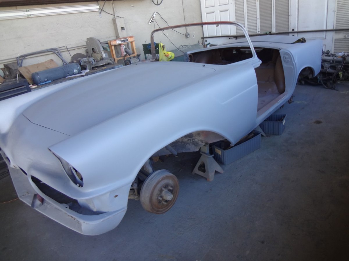

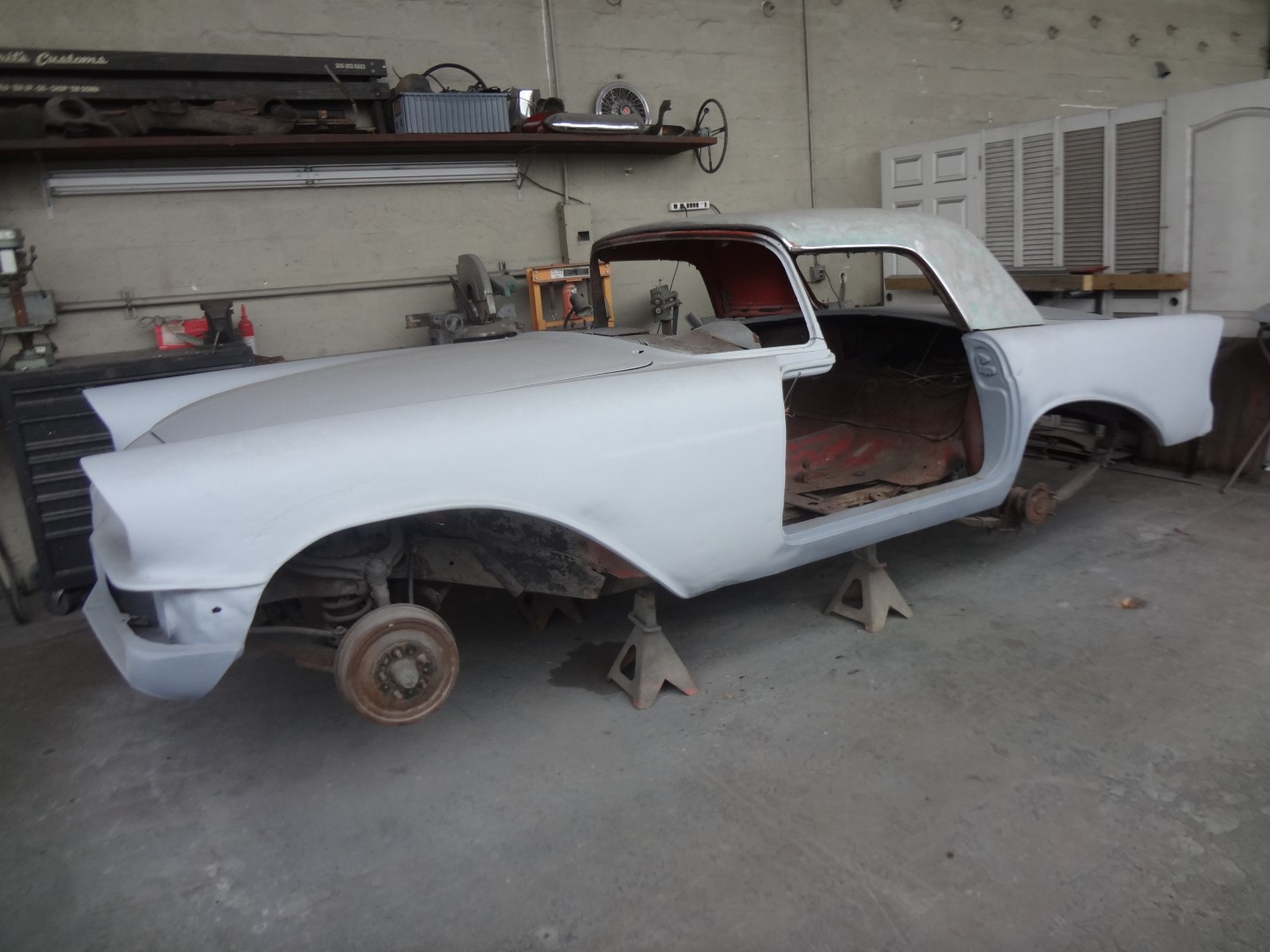

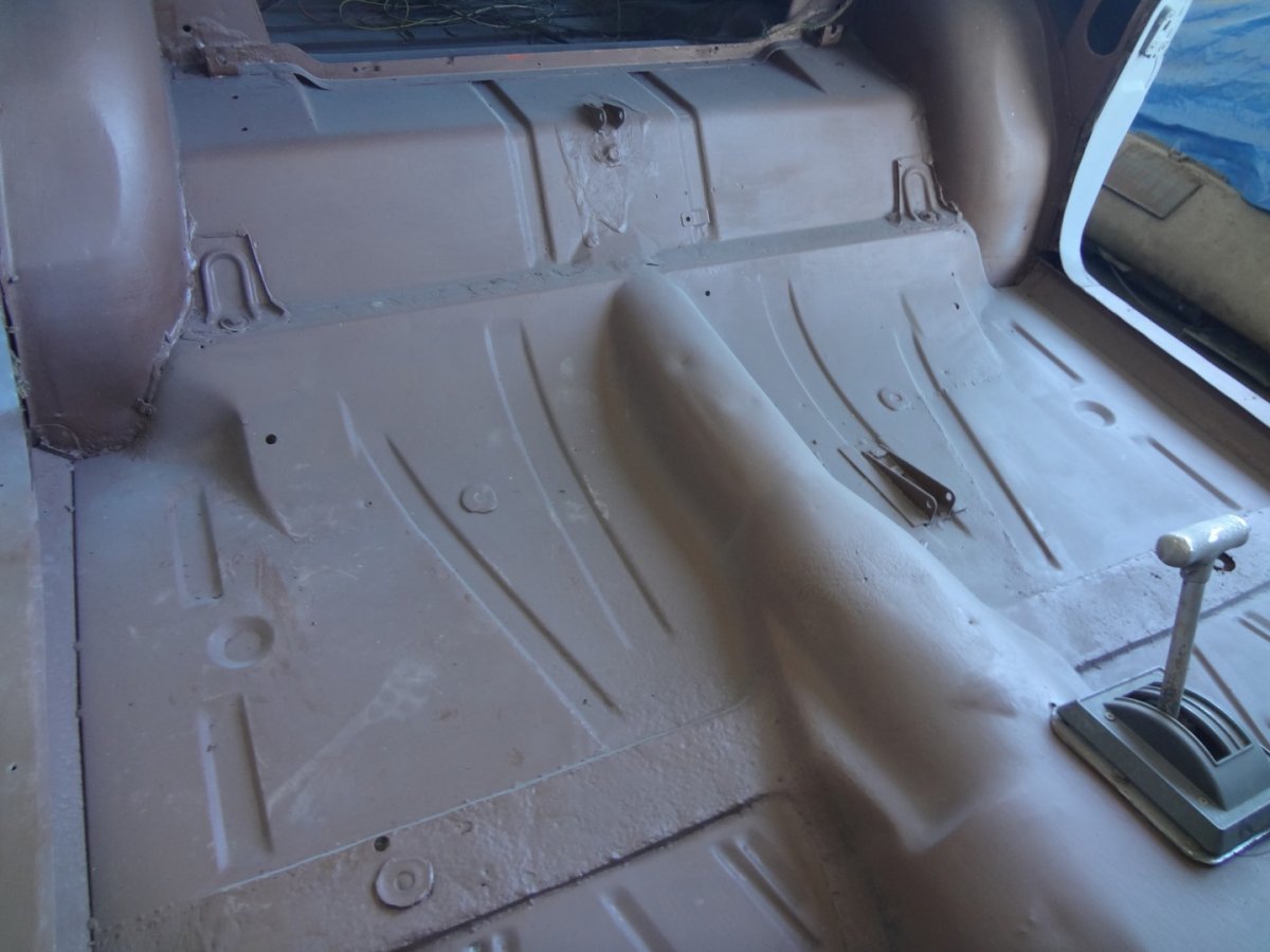

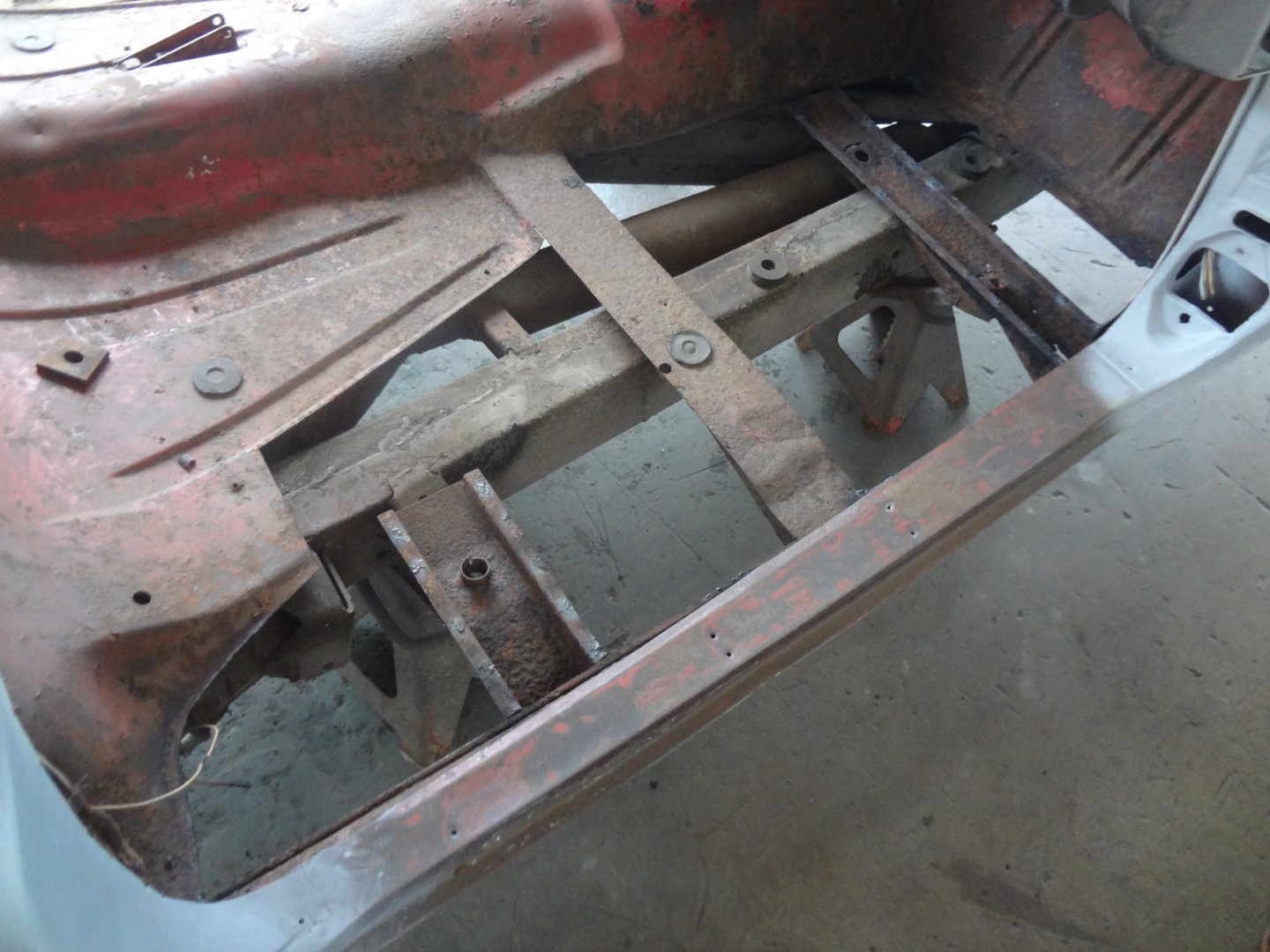

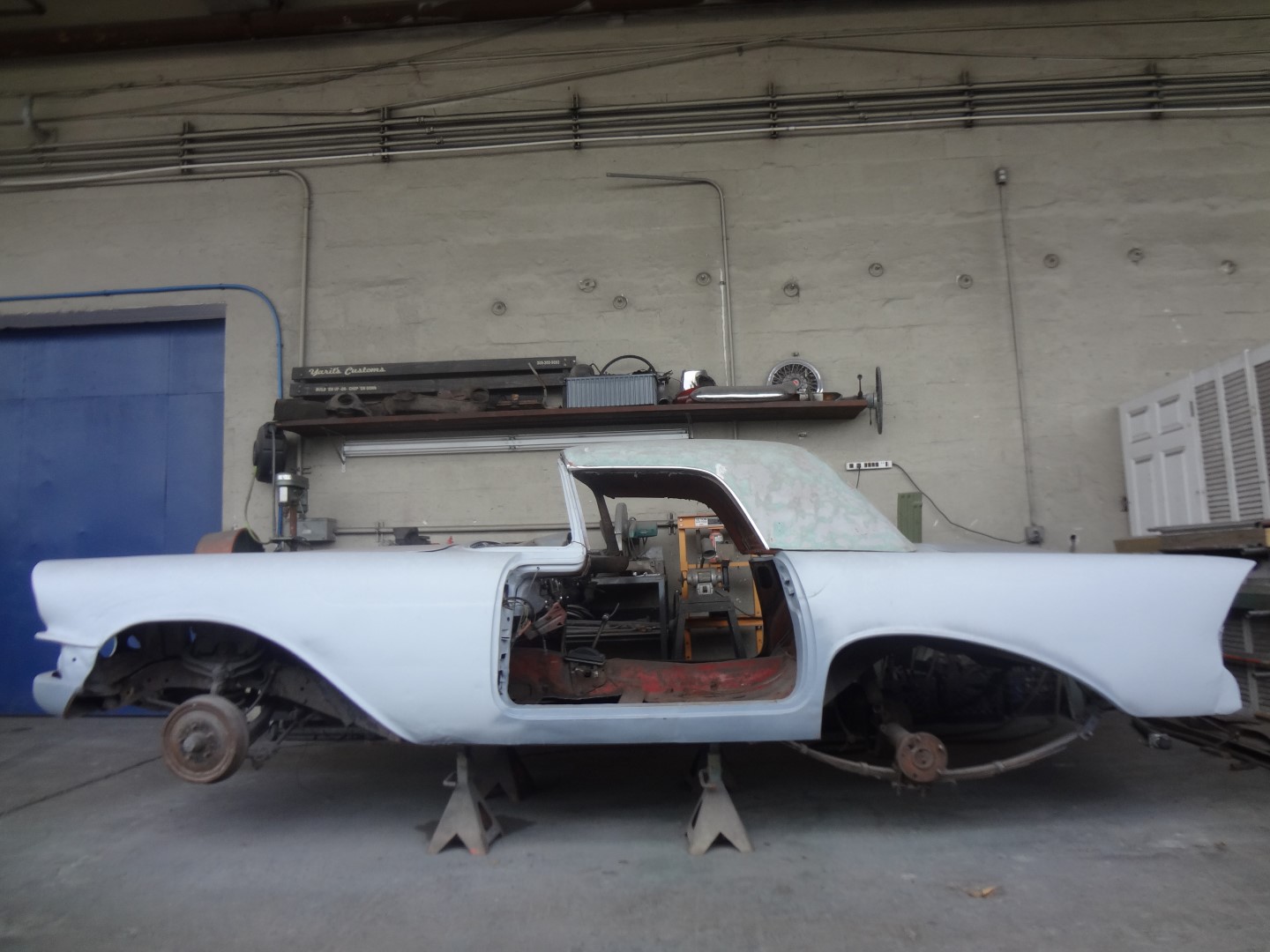

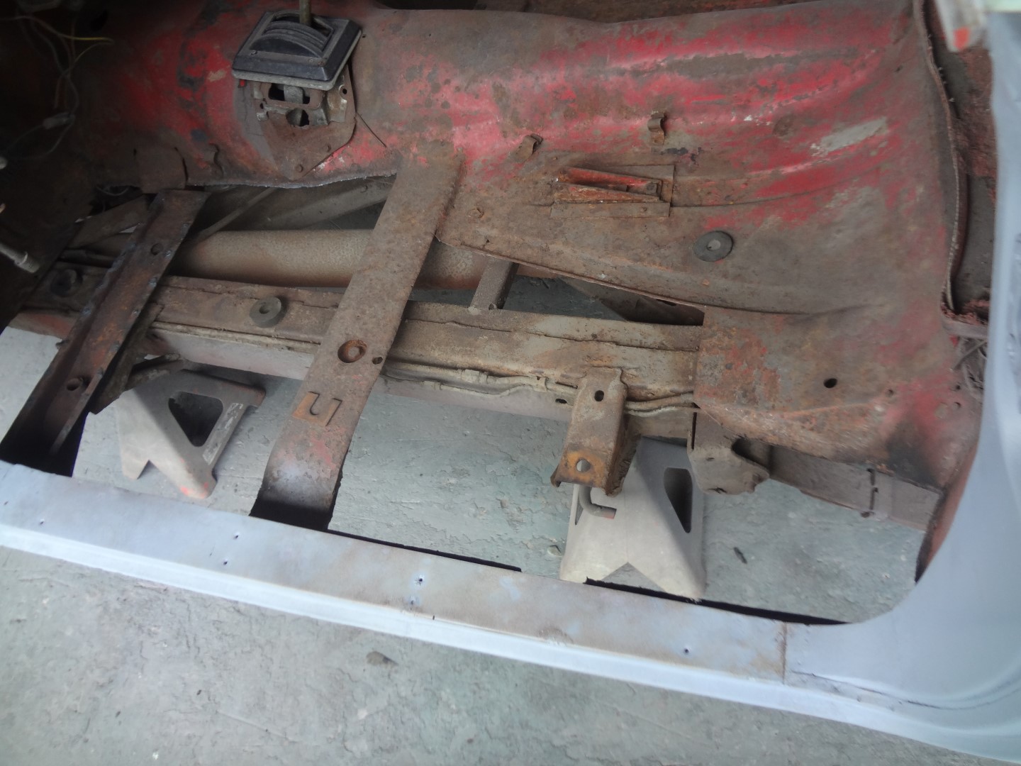

    as you last saw car was mostly hammered straight and shot in epoxy. now we have started some rust repairs and cutting out the rusty floors, as well as shot a coat of high build primer on it to get a better look at it. unfortunately this car was not taken very well care of. some pics...

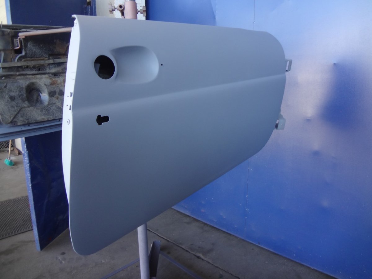

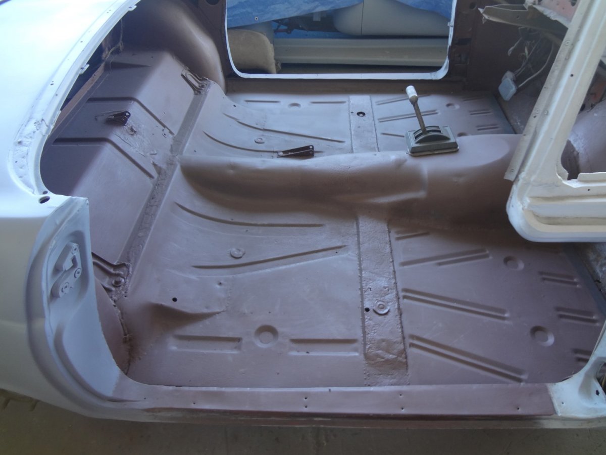

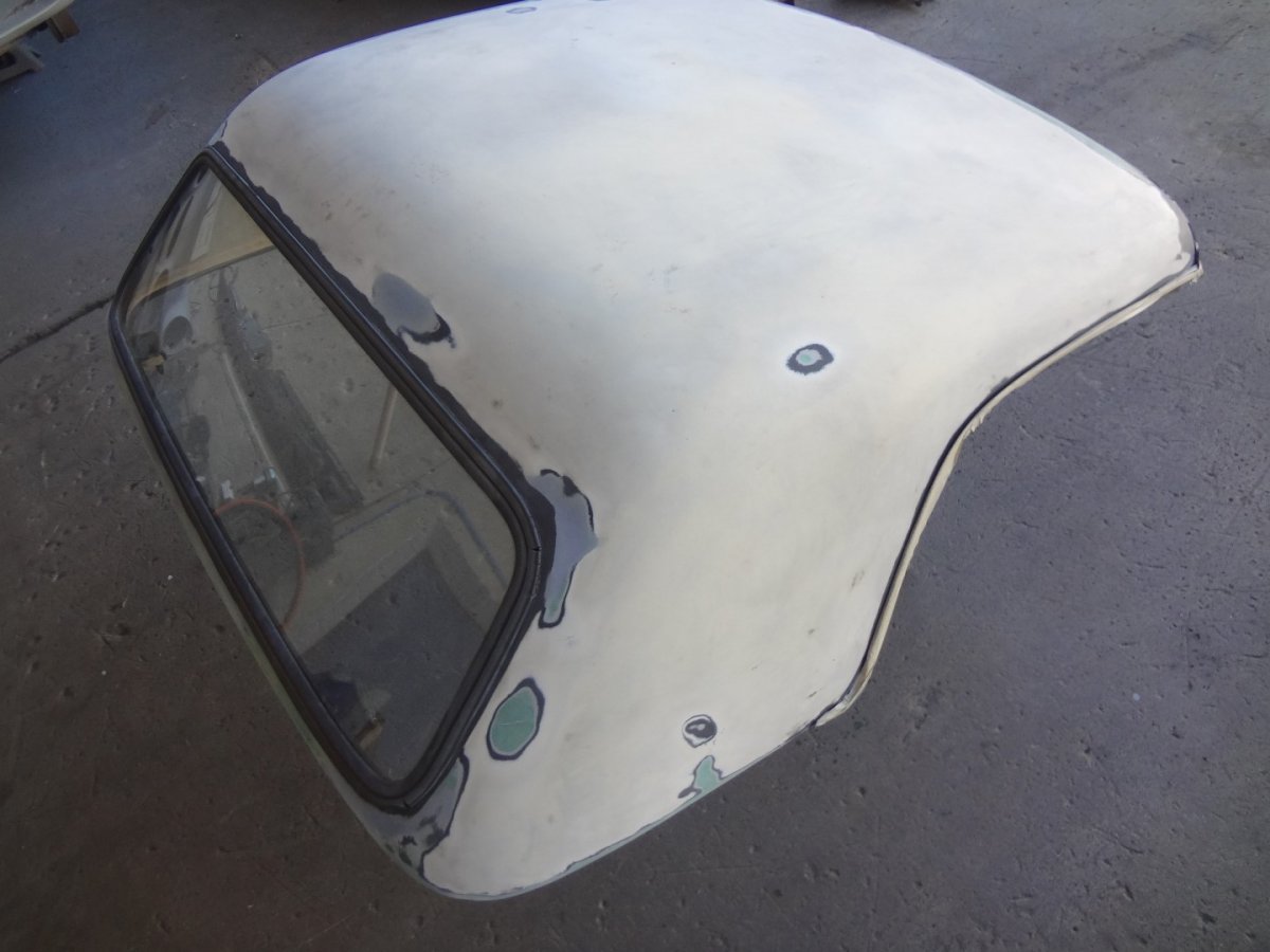

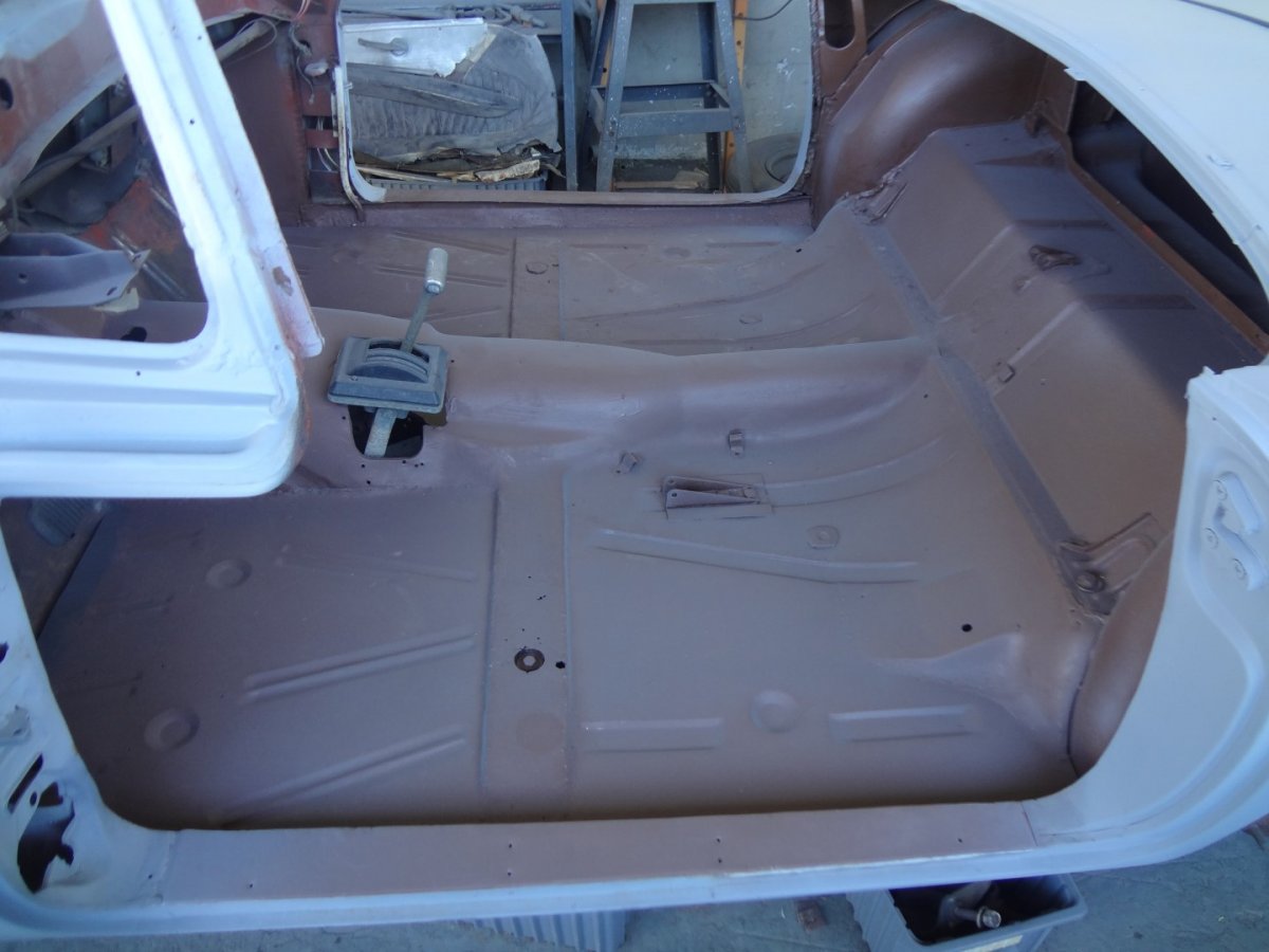

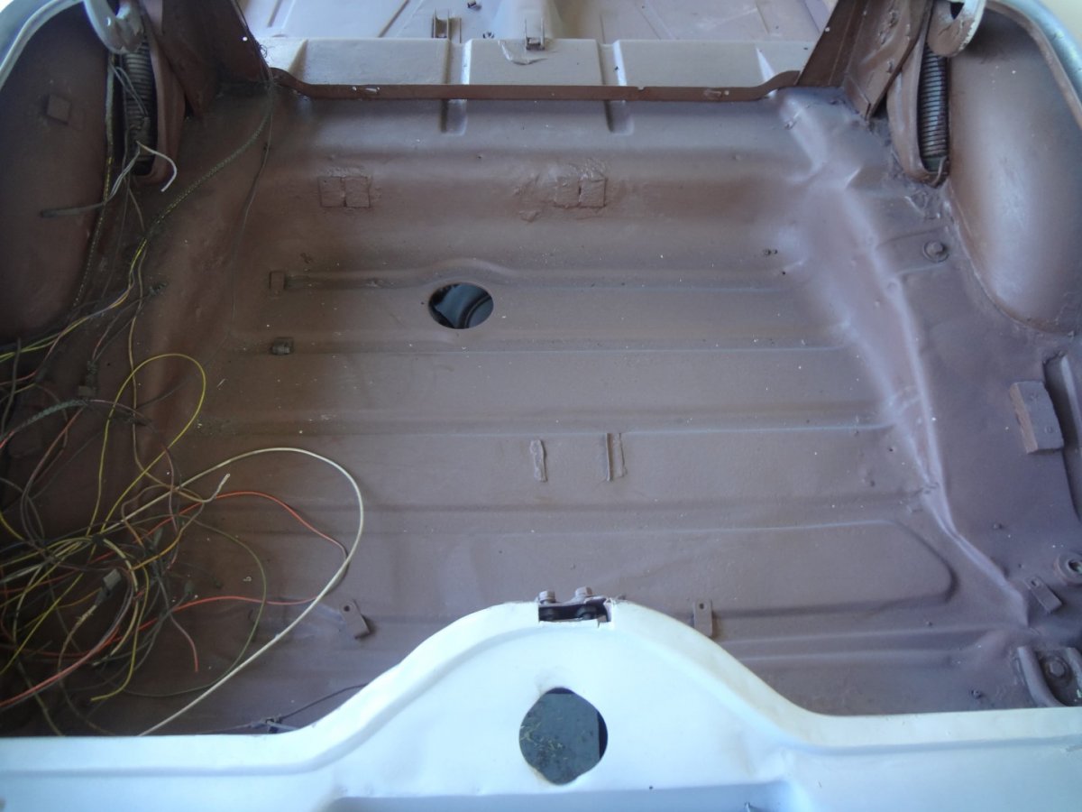

    so just wanted to drop in some more progress pics of the T-bird. we took the driver door off the donor car (the Ayala Tbird came with a rusty empty shell of a door) worked it a little to make it straighter, and started disassembling the internals. we took the fiberglass roof off the donor car, being that the Ayala roof has no kustom work on it and the back window frame was broken into pieces, we didn't see why struggle to repair a stock fiberglass roof, the donor roof only had some cracks from the sun beating on it that's an easy fix. we took the trunk off the donor car, the original trunk on the Ayala car (if it is "the original trunk") had the complete back lip reconstructed by some armature metal man, inner lip was rusted out and was pitting with rust very badly on flat surfaces. the donor trunk was shaved of its gas fill hole and its key hole, providing the same look without the rust. the new floor patches are all welded in place (except at the toe board, ill handle that when the body is off the frame). we have welded them completely closed and gone over them with a metal rust preventive primer.

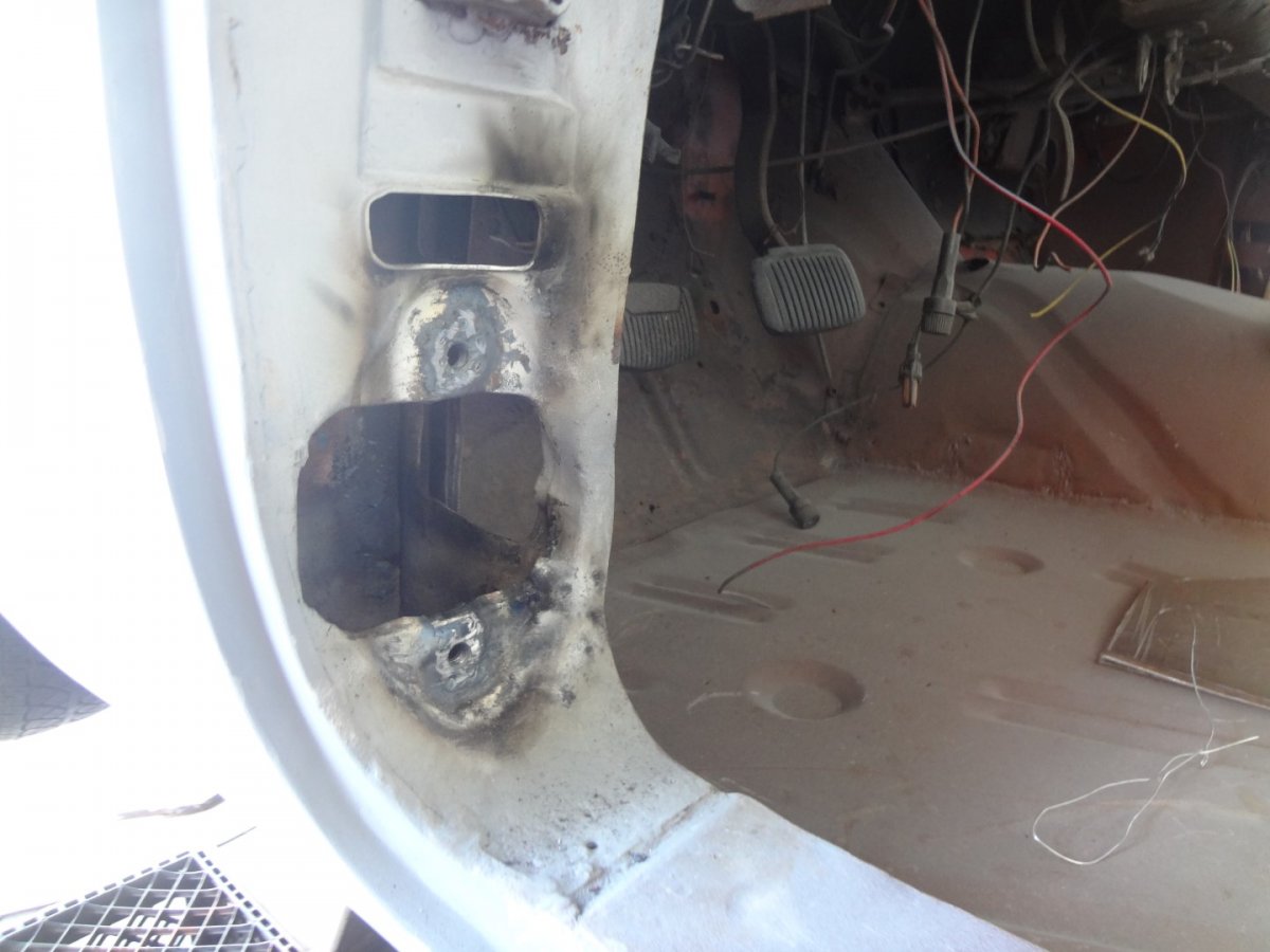

    so whats next? we are stink blocking the body, it will require another few coats of high build primer to achieve a surface good enough for paint. we are also going to fine tune the gaps on the trunk and doors (btw a lot of the "nuts" that are suppose to be in the door jamb to hang the doors are missing! ill have to weld in some nuts to properly mount the doors). then we will be ready to take the body off the frame for underside cleaning and resurfacing.
    we are still looking for passenger front fender to cut and weld.

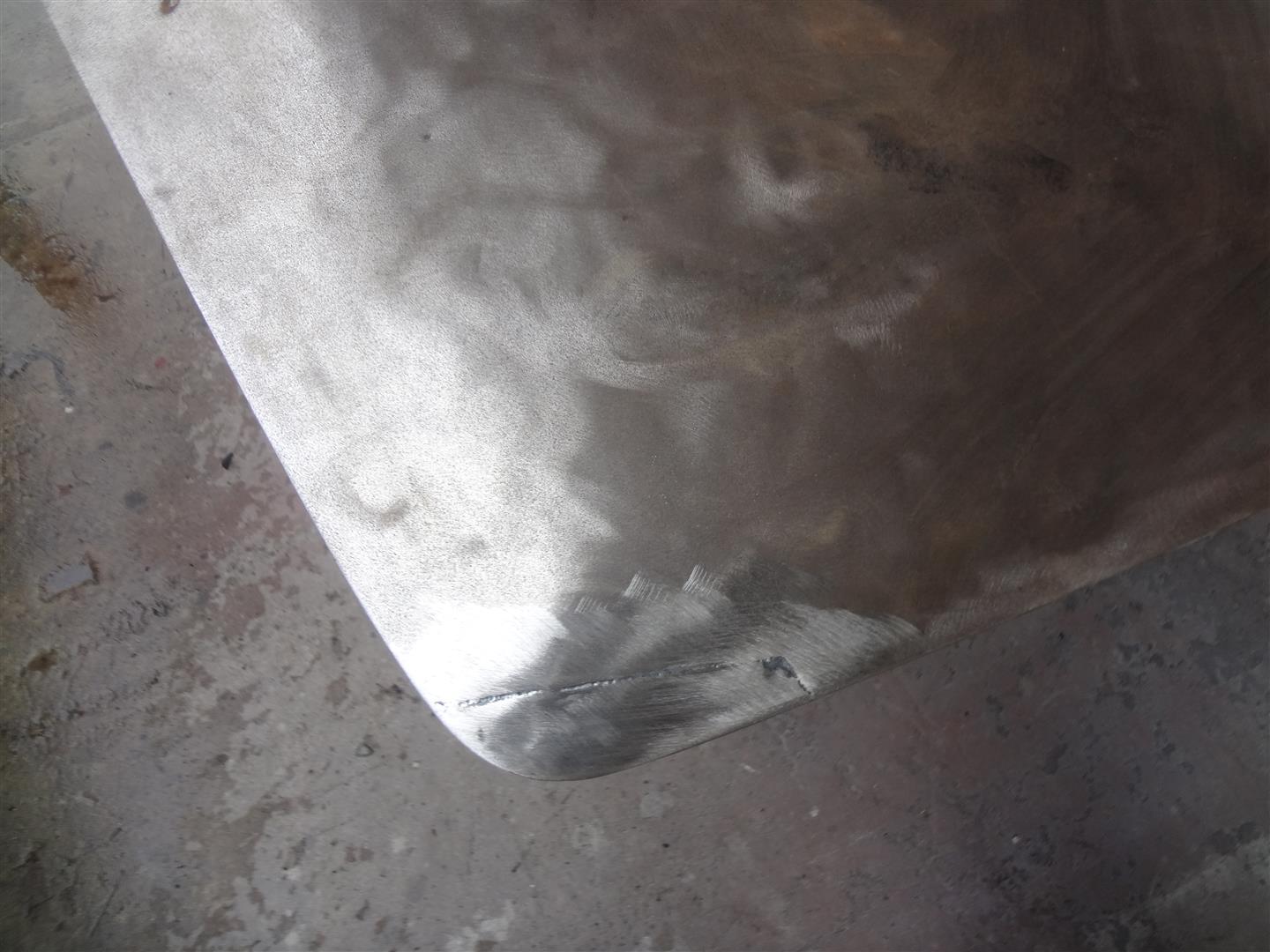

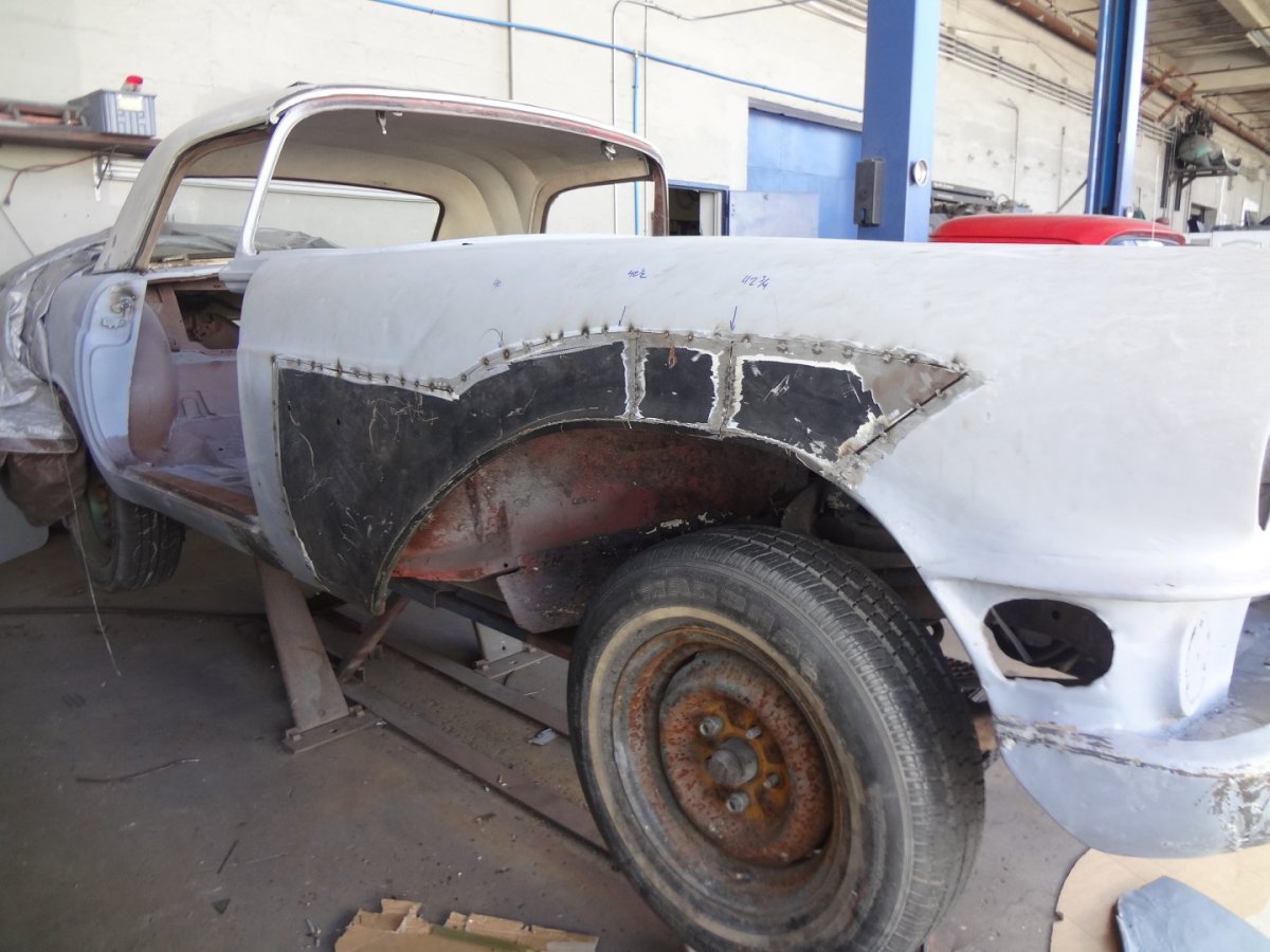

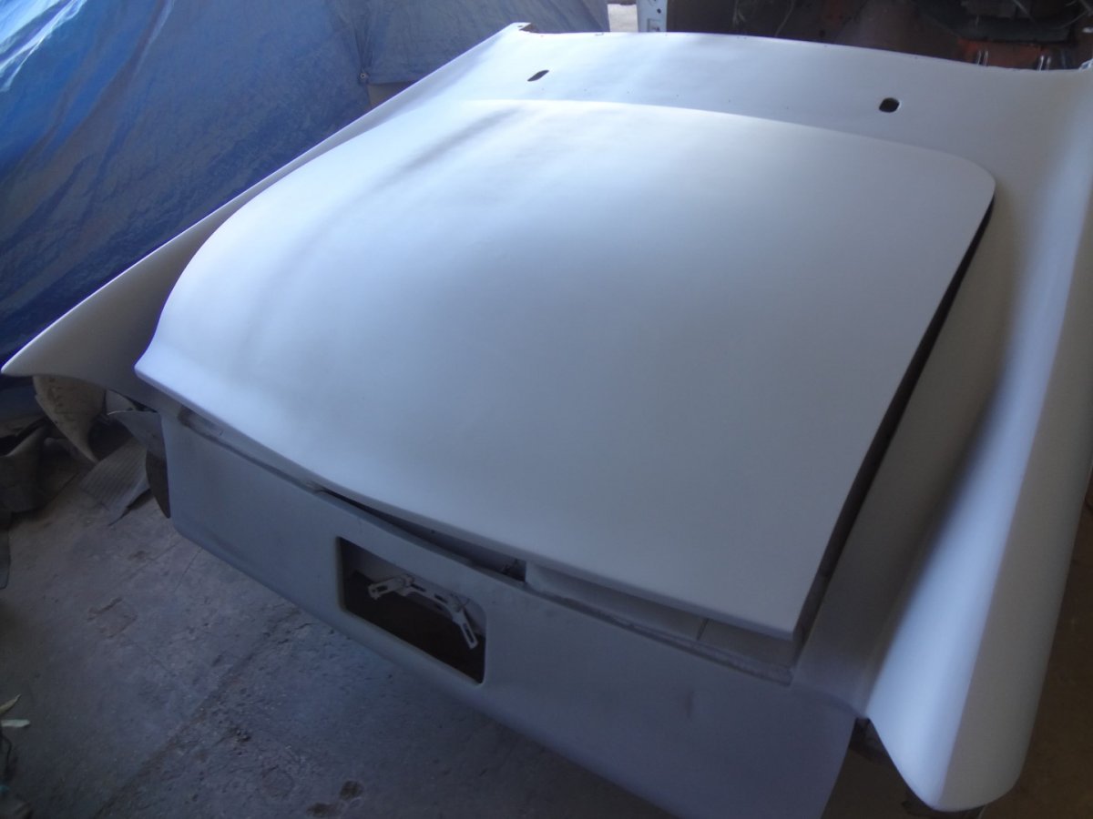

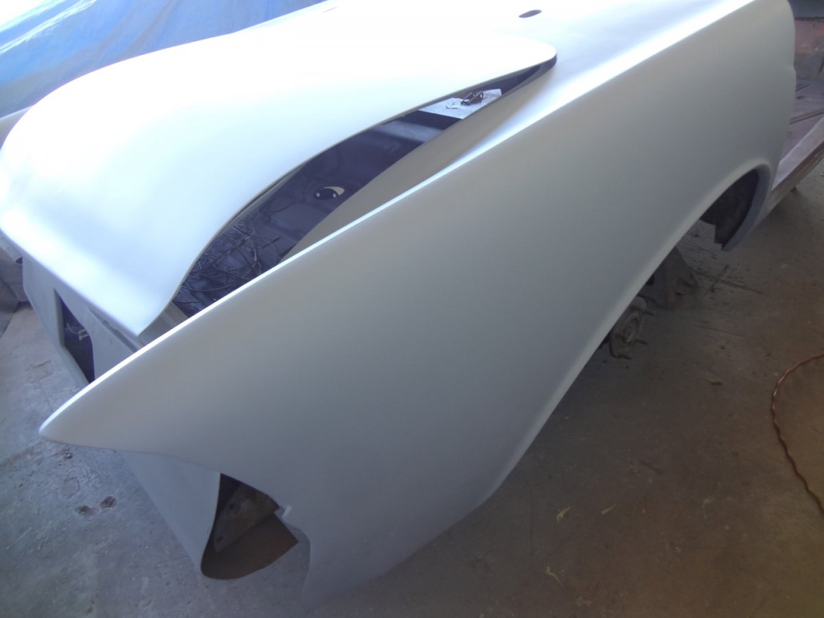

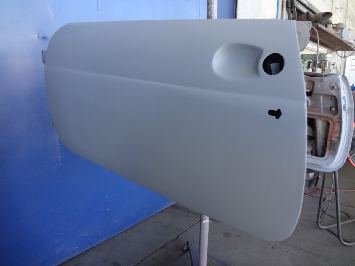

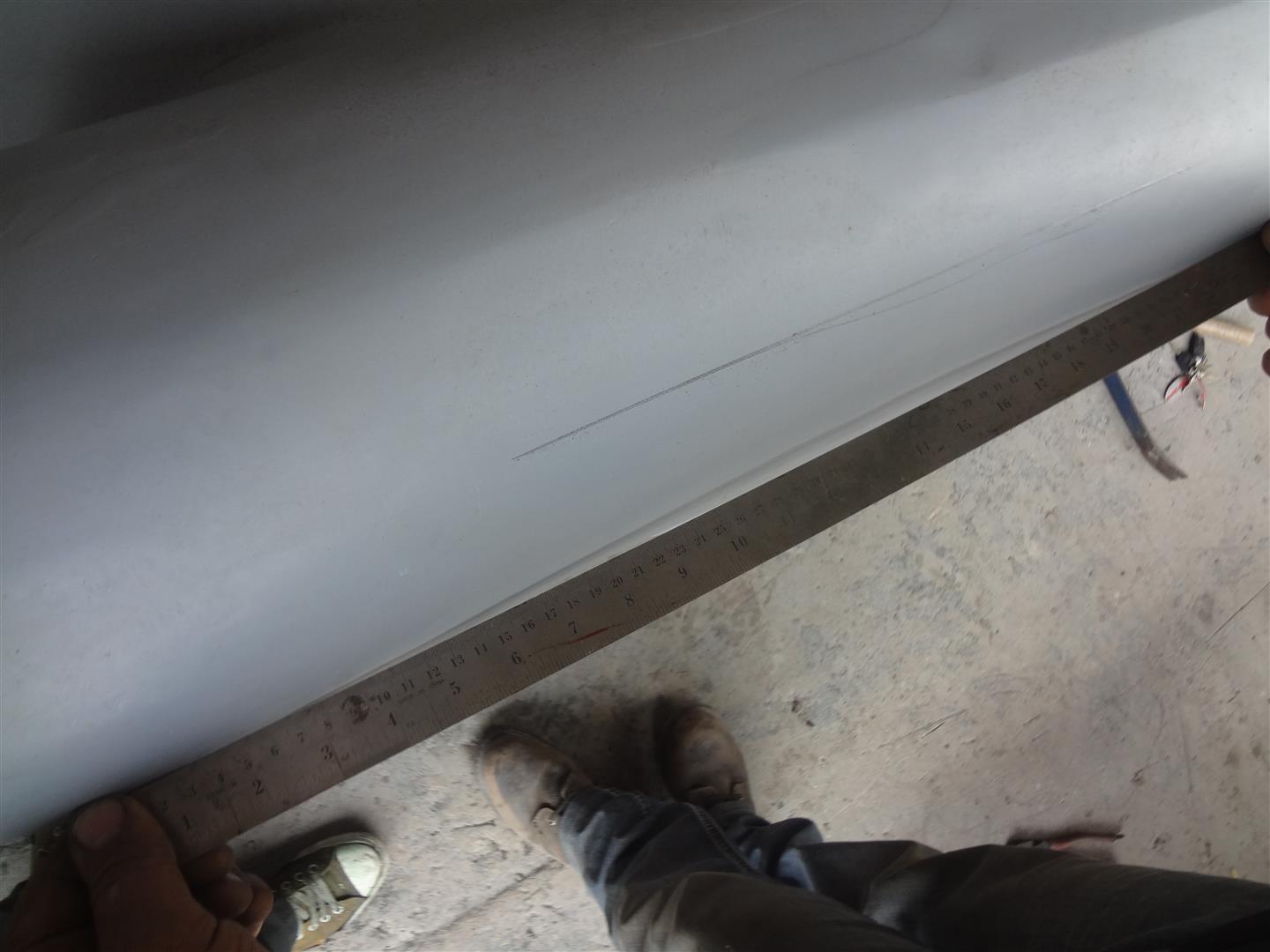

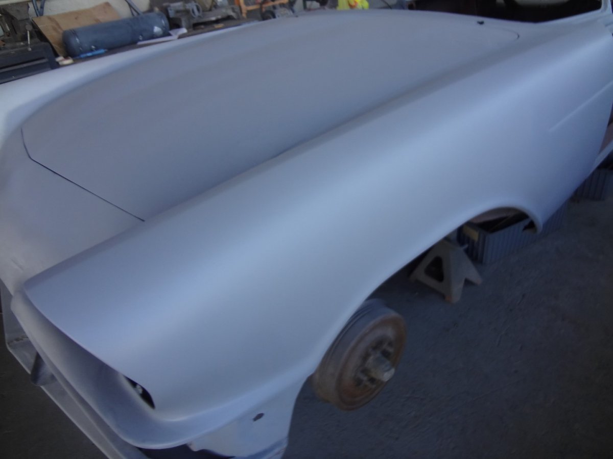

    some more progress on the Ayala t-bird restoration… we finally sourced an Olds passenger fender to repair the wheel opening. it looked to have been hit, and somebody welded another fender over the original, and there was also some round bar at the edge of the fender (all that was covered in bondo to make the shape look correct). most of the rest of the fender was well banged up too so we tried to use as much of the new fender to smooth things out…
    also almost all the receiving nuts in the pillar were completely missing! we had to get creative and weld some nuts in order to mount the doors!
    currently the body has been braced inside and is ready to be removed from the frame. we will spend just a little more time while on the frame to finalize fender metal work and another round of blocking and primer and tweaking panels.

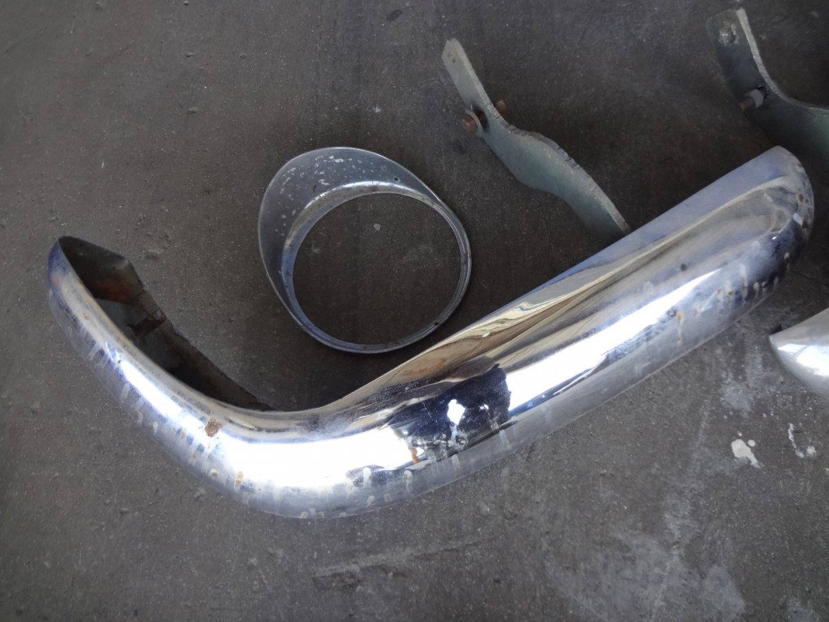

    original chrome parts are also getting ready to ship out to the plater!

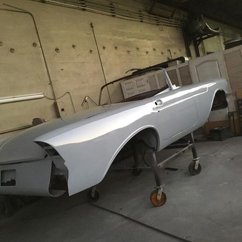

    So here's some new pics. Paint and assembly time!!! :D

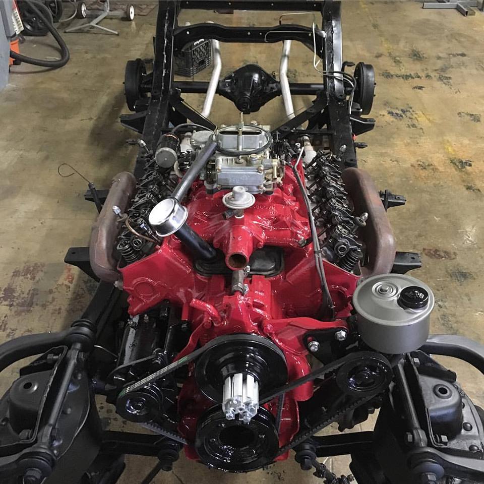

    Chassis getting together. Great job Yaril!!!

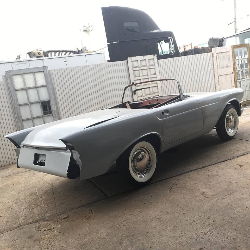

    Floating T-Bird body about to land on frame! Big milestone for this project [​IMG] 17155671_1281704598575357_8243622201127841275_n.jpg
    Body on!
    Loving the way the engine bay is turning out [​IMG]
