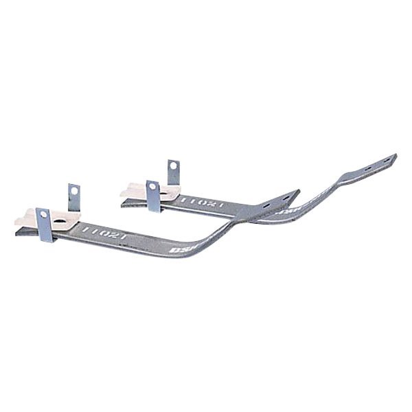

    Just thought I would throw this out:
    My 57 had lakewoods for traction bars when I first got it
    was not real crazy on the looks but they did work good
    One week we were building a 55 210 del ray with a high winding 289 sbc that dude had its own sound very cool.
    4.11 gears with short g60's
    well the dad was a old racer he came walking in with a pair of leaf spring helpers like the ones in the pic I asked what are those he explained and they were cheap
    they take the rabbit hop right out I went out and bought some for my car
    have any of you used them before I just found those old dudes in the cabinet and the old lakewoods were out in the other shop buried
    for you budget racers this could be a cheap traction device it worked for me 11-1020_1.jpg

    Yep, I have a pair of those that I kept when I sold a hot rod pickup. They do work well for keeping the bunny's from getting too excited. I may use them on my current build.

    The helper spring in the first post does nothing to strengthen the front half of the spring, and the front half is the side that has to transfer all the power to the chassis.....the rear half is the half responsible for holding the body up is all(load).
    The doubled up main leaf section on the front half is a long known "cheater" trick that works.
    The cut off and added main leaf piece should be put under the original main leaf though, not on top of it.....you want that cut off front eye end supporting the original main leaf directly under the eye....You can even leave nearly 1/2 the eye still on the cut leaf, to cup under the original leaf.
    Basic premise is to turn the front half of the leaf into an inflexible bar so it can't bend and hurt traction.
    Old wolf likes this.

    if I remember right (we) being me and my friends 55 installed these helpers springs facing forward on the front half just like a Lakewood they really worked with out them or some other kind of traction device
    forget it jump jump jump.

    if this is a rearend housing this is how they were mounted on the front side th.jpg

    Ah, I see now how it cold help a little....I thought you were talking installing them on the back half like they would be for load helpers..
    Part of the old Chrysler Super Stock trick was also to turn each leaf(other than the main leaf obviously) around, as they are longer on the back half originally, nearly all leaf springs are. When they are all clamped back together every few inches on the front half this reverse bias also helped with preventing spring bending....spring bending and unloading rapidly is what wheel hop is.
    That fact is what makes the Cal-Trac so successful, using the link pivot it is pressing back down on the spring at the point the spring is trying to bend, right behind the spring eye, half way between the eye and the end of the second leaf. Same reason the doubled up front half of a main leaf and the Chrysler trick help - stiffen the front half of the main leaf is 90% of the battle.
    If you look at Calvert's or Landrum's Split Mono race spring, the front leaf half is very thick, and the rear leaf half is much thinner, overlapped and bolted together in the center..

    The old Traction Masters are NOT the same as Cal-Tracs….Traction Masters did not have the pivoting front bar mount that change the forward push on the barinto downward push on the spring right behind the eye where the spring is trying to bend. That is the big feature that makes the Cal-Trac work so much better.
    Competition Engineering's Slide-A-Link is the next closest thing to Cal-Tracs, kind of bridge the gap between Cal-Tracs and Traction Masters in design, just adding the slip tube and bushing into the bar.
    Smith RaceCraft Assassin Bars are a variation on the Cal-Trac .
