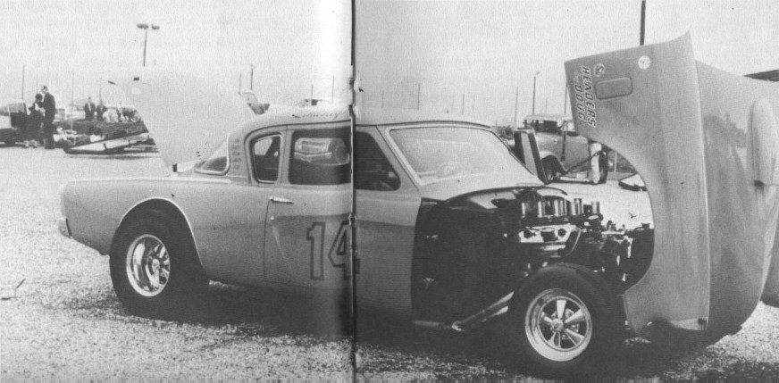

  11. Here is a picture for some inspiration. This is scanned from a book printed in 1966, called Drag Racing- quarter mile thunder.
