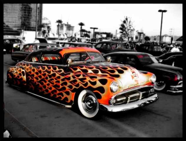

  4. I keep posting this
    SintownKing and turboroadster like this.
  5. LongLiveFlathead6
    Joined: Feb 20, 2015
    Posts: 49
    LongLiveFlathead6
    I'm not a flames guy, but that is fucking bad ass!!!

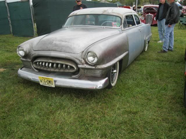

  26. mikhett
    Joined: Jan 22, 2005
    Posts: 1,400
    mikhett
    from jackson nj
    The Second pic of a 53 is KENNYS FROM N.J.
