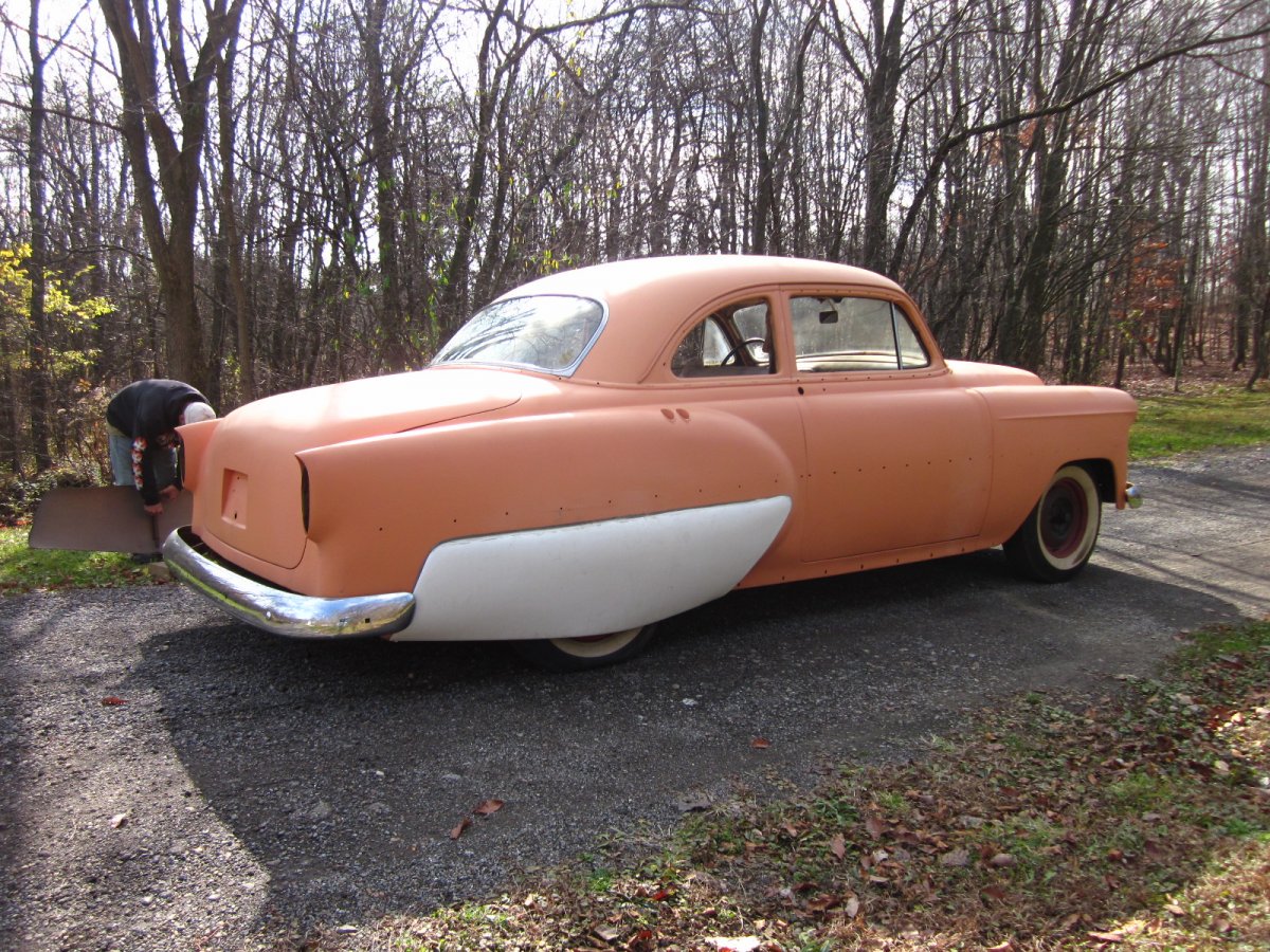

  1. Just picked up this fine 53 Club Coupe 210 Model --- This dude did some nice work to it.
    Now we will finish her off. We will drop a SBC , Turbo 350 in it and we have a Chevelle rear going in as well.

    What kind of skirts are those
  9. The guy I bought car off of included these skirts - He showed me where they had to do a lot of glass work to form fit them to the body. I'll ask him what they came off of

    I know that car, you bought it in Cranberry, PA, correct? What year Chevelle rear are you going to use? Very nice car.
  11. Hi - I bought the car few months ago from a guy in the Pittsburg,Pa area He said he did the car,sold it to a guy who never finished it and he bought it back from him and put it up for sale I saw car online and we bought it.
