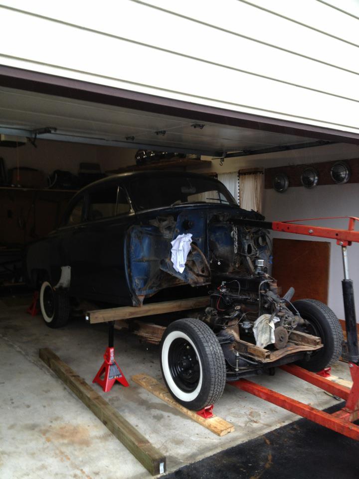

    So finally got my project off the ground today. Got the body of my 53 pulled off and will start tearing down the chassis soon. Then onto notch and 4 link and start the airbag setup. More pics to follow.

    That's a pretty clean old Chevy...

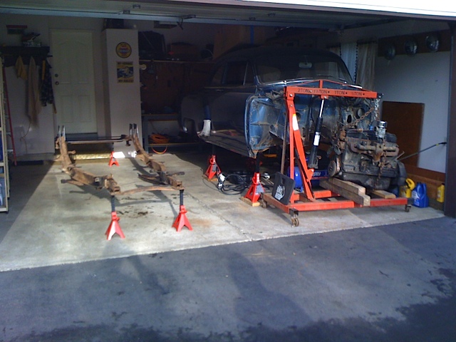

    So more progress on the car today. Got the whole chassis degreased and the motor pulled out today. I have already organised a newer rear axel to get away from the torque tube factory one. Question i am asking is, once the closed drivline is removed, how do you convert the back of the transmission to accept a normal style driveshaft? If anyone has done this or knows of anyone who has information for me. Please help?

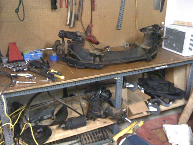

    So got more progress on the car done this week/weekend. Got the rest of the chassis torn down and got all the bits off i dont want to keep. Got my notch cut out at work on friday and ended up getting the sides tacked on as i wanted to get my axle center lines before i pulled the rear end out. Today with help from my buddy, i got the torque tube rear end out as well as the gas tank, and transmission crossmember. Plan to get the rest of the front suspension stripped this week so I can take it all to the sandblasters before Christmas. After the holidays, I will start all the main fabrication to the frame; triangulated 4link, new raised crossmember for 700r4, notch front subframe and modify lower control arm for SS6 slam specialties air bag. Will update as much as possible.

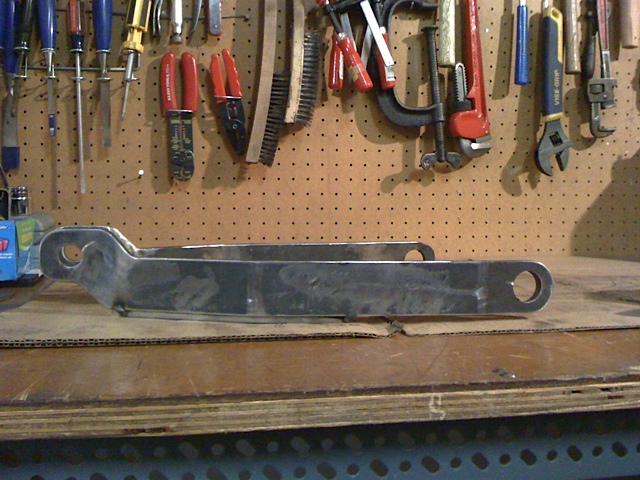

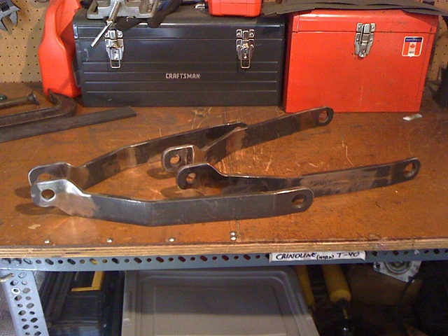

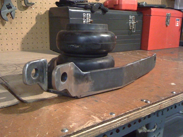

    Got a lot of progress done today as im now on holidays. Decided to build new lower control arms as the factory ones are junk and wanted something a little bit stronger and more suited for my airbag setup. Used 3/8" flatbar and bent up some new ones. I also stepped the lowers 1" so i dont have to cut out as much on the front subframe. Turned out better than i expected and should be installing them tomorrow to see if they work. More work done on my notch as well, hopefully have it complete before the weekend.
