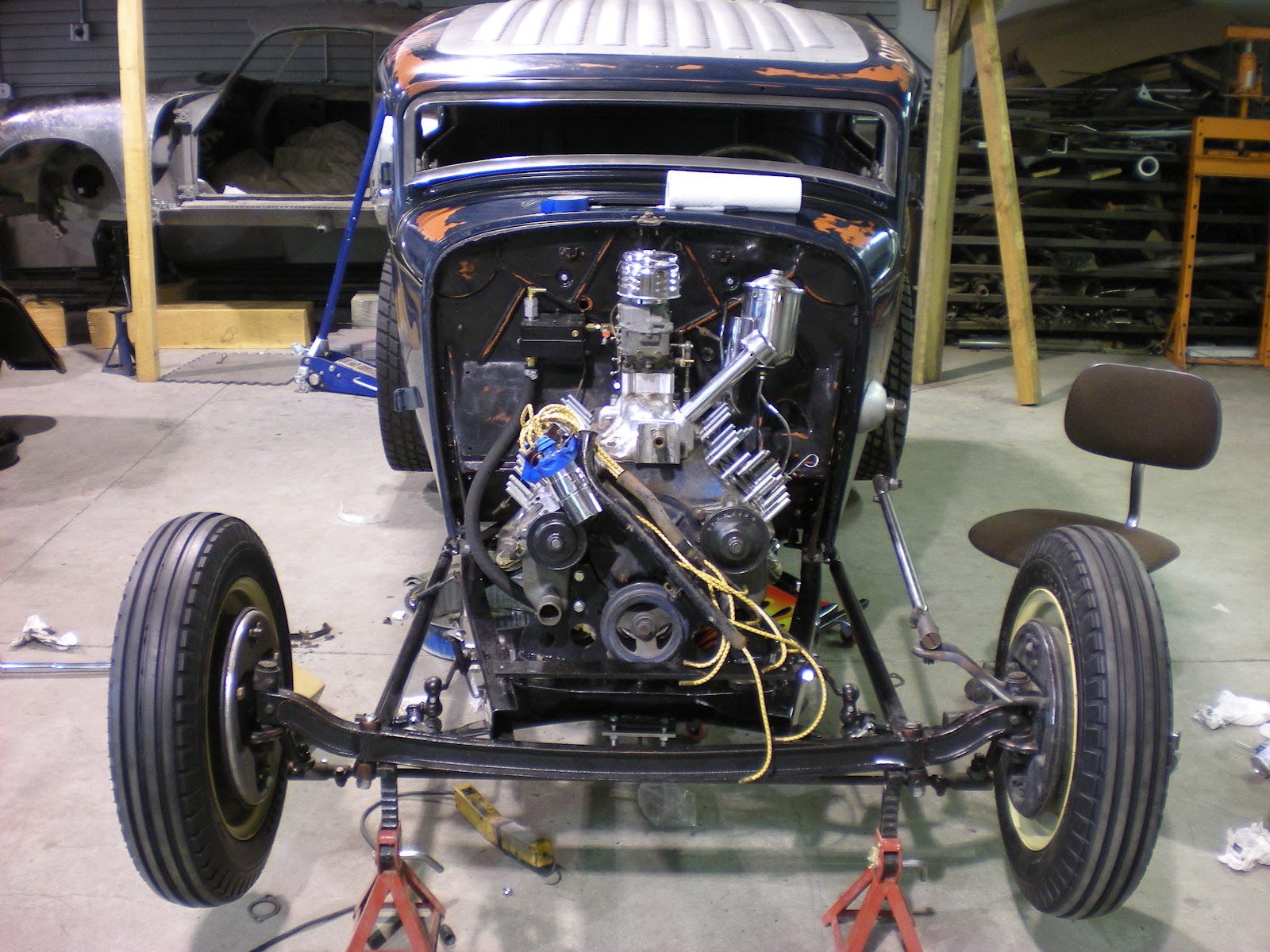

  9. Both are pinched
    rolling bones:
    saltflatspeedshop:
