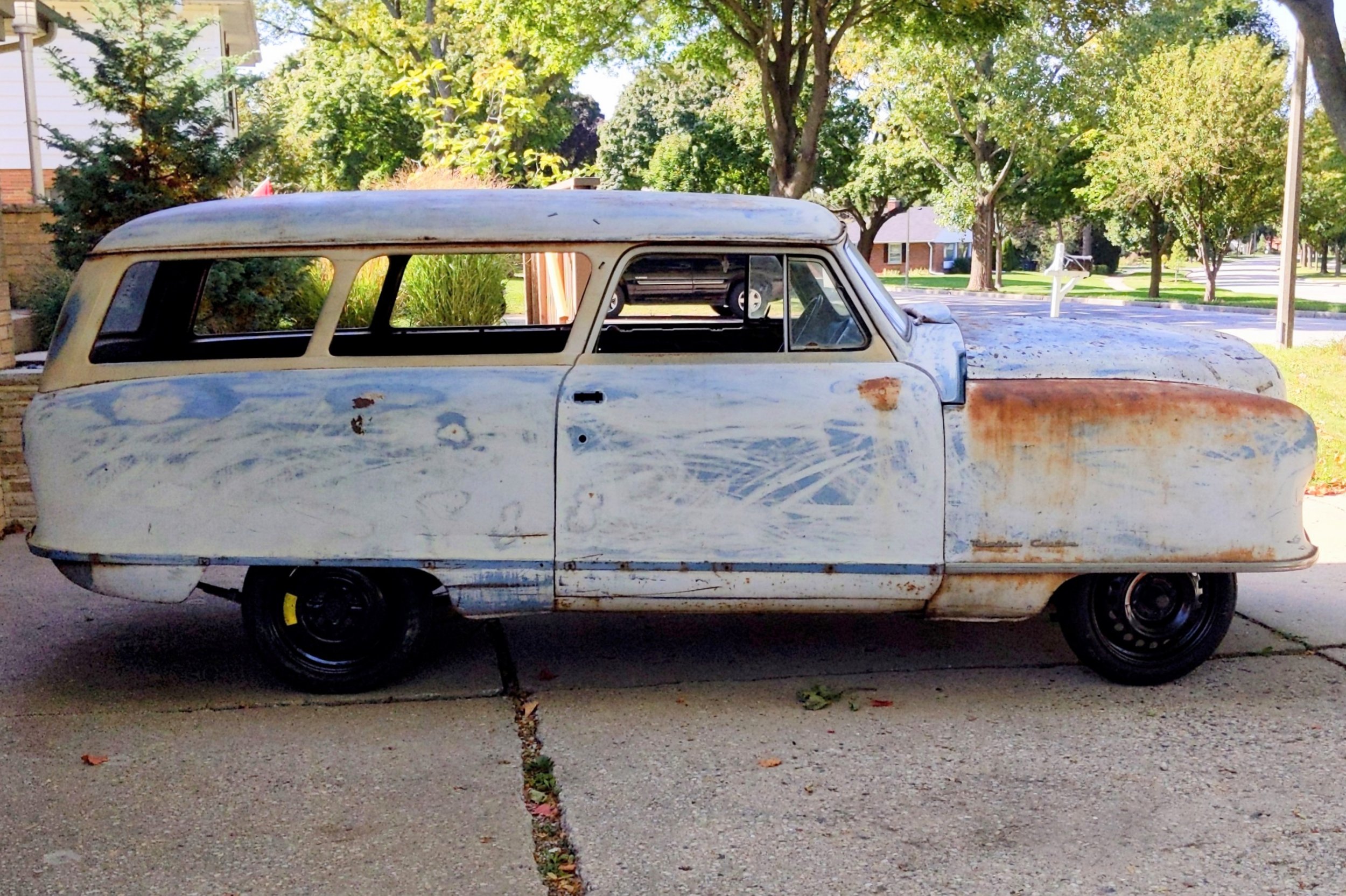

    While not technically a new member, I've only posted here a few times, so here's a brief introduction on my new-to-me '52 Nash Rambler wagon which I acquired in September 2022.
    Originally from the Mojave Desert area, the car is mostly solid, but it has a few rusty (Midwest rusty) areas. The first thing I did after pushing it into the garage was to strip it down to a (mostly) bare shell, taking stock of what was in need of replacement and/or repair. I had no intention of restoring it to stock, so things like the flathead six, O.D. three-speed trans, Dana 31(?) rearend, and the front bench seat were ditched. The carpet was already long gone, and everything rubber was brittle and crumbly, so that will all need to be replaced, as well as all of the glass, too.

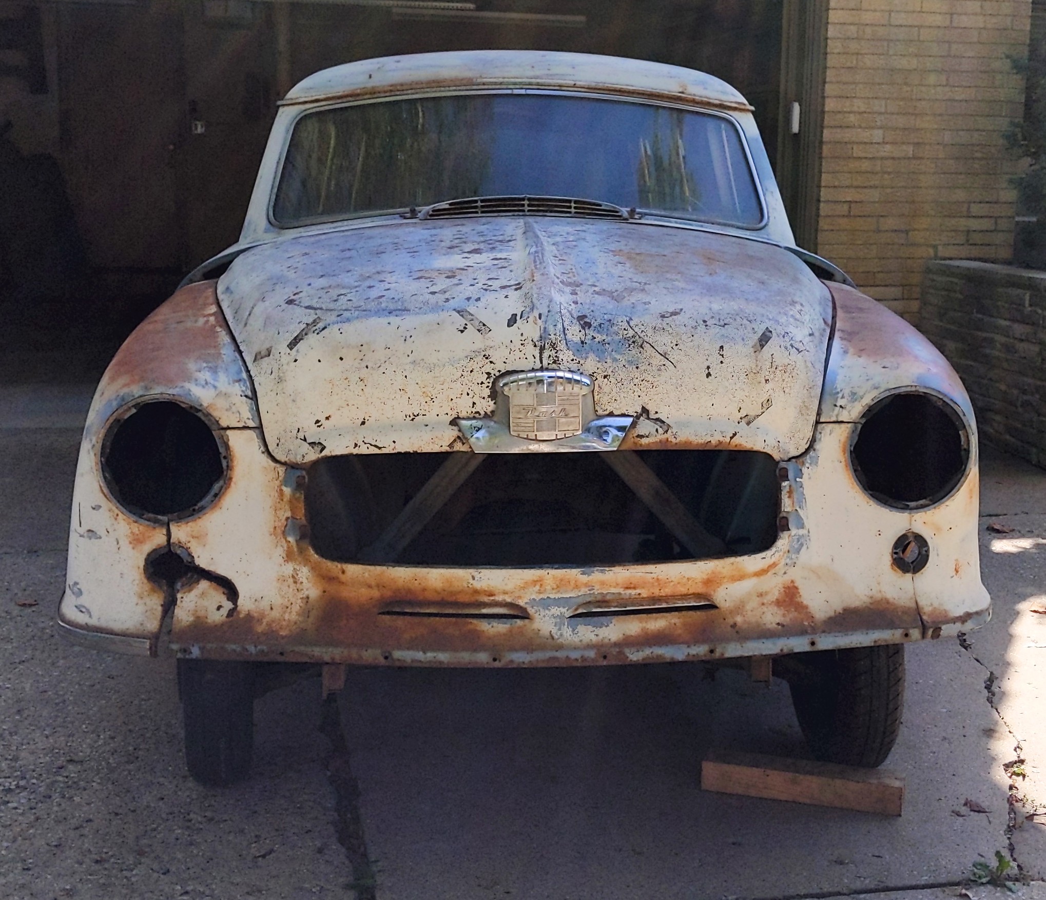

    Here are a few pics I took right after stripping it down:
    And after being pushed back into the garage:
    There's plenty of body work to be done, especially on the rear valance. The car sat with the rear end lower than the front, so any water (and I'm guessing ice, too, based upon the damage) which got inside flowed down into the cargo area, and eventually inside the framerails and out the lowest point at the rear valance panel...not great.

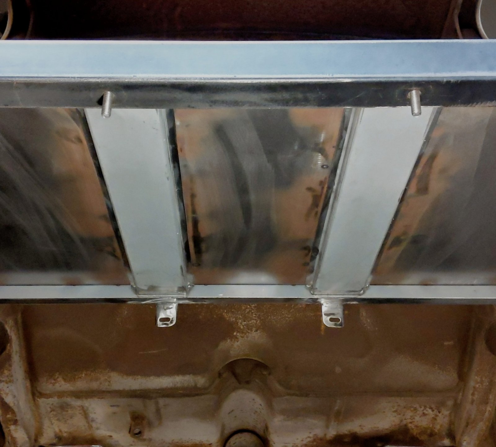

    Didn't think to take any pics while I was underneath, cutting out the rusted out frame rail areas, so pics of the trunk are will have to do for now. The under/outside of the trunk floor was in great shape and mostly protected by the fuel tank directly below it, but the interior side had a hole or two, and plenty of heavy surface rust from being filled with water at various times. The rear crossmember, which supports the rear edge of the trunk floor, the tailgate supports, etc. was totally rusted out and not re-useable. Knowing I was going to use a different fuel tank (the stock tank was tiny, and kind of pentagonal in shape), I decided to cut the trunk floor out, as well as the rear crossmember. Doing this would also allow me to remove the rear valence in one piece, as it and the crossmember were spot welded together along the full width of the panels.
    Here's what the trunk looked like at the start:
    Rusted out crossmember piece, with daylight passing through, visible on the left, rear bumper bracket bolt on the right:
    Rust colored factory primer still present on the underside:
    After a rough cut (early Ford Falcon leaf springs and Ford 8" rearend housing also visible):
    I wanted to retain the stock fuel filler location at the left rear corner, and discovered a '55-'56 Chevy tank had the same inlet location, was a more traditional square shape, and was very common, so that works for me. I got lucky and found a good used tank semi-locally, and got to work welding in a new square rear crossmember and some trunk floor supports made from 16 gauge pre-formed sheet metal, as seen in the image below. It's strong and stiff enough for the new flat trunk floor to be welded to and to support a full fuel tank and spare tire. Here it is, pre-floor and still in the test fitting stage, before I had the '56 Chevy fuel tank straps:
    I also added a smaller (1" square, I think) crossmember at the front to both support the floor and the new quarter round piece I used to mate the trunk floor and axle hump. I still have some final finishing to do on the floor, but it's mostly there. New front strap brackets were welded in place, and stainless carriage bolts were used to hold the straps at the rear. Still need to add a few recessed/depressed holes in the trunk floor for drainage/anti-oil canning, but I think something similar to a dimple die will work.

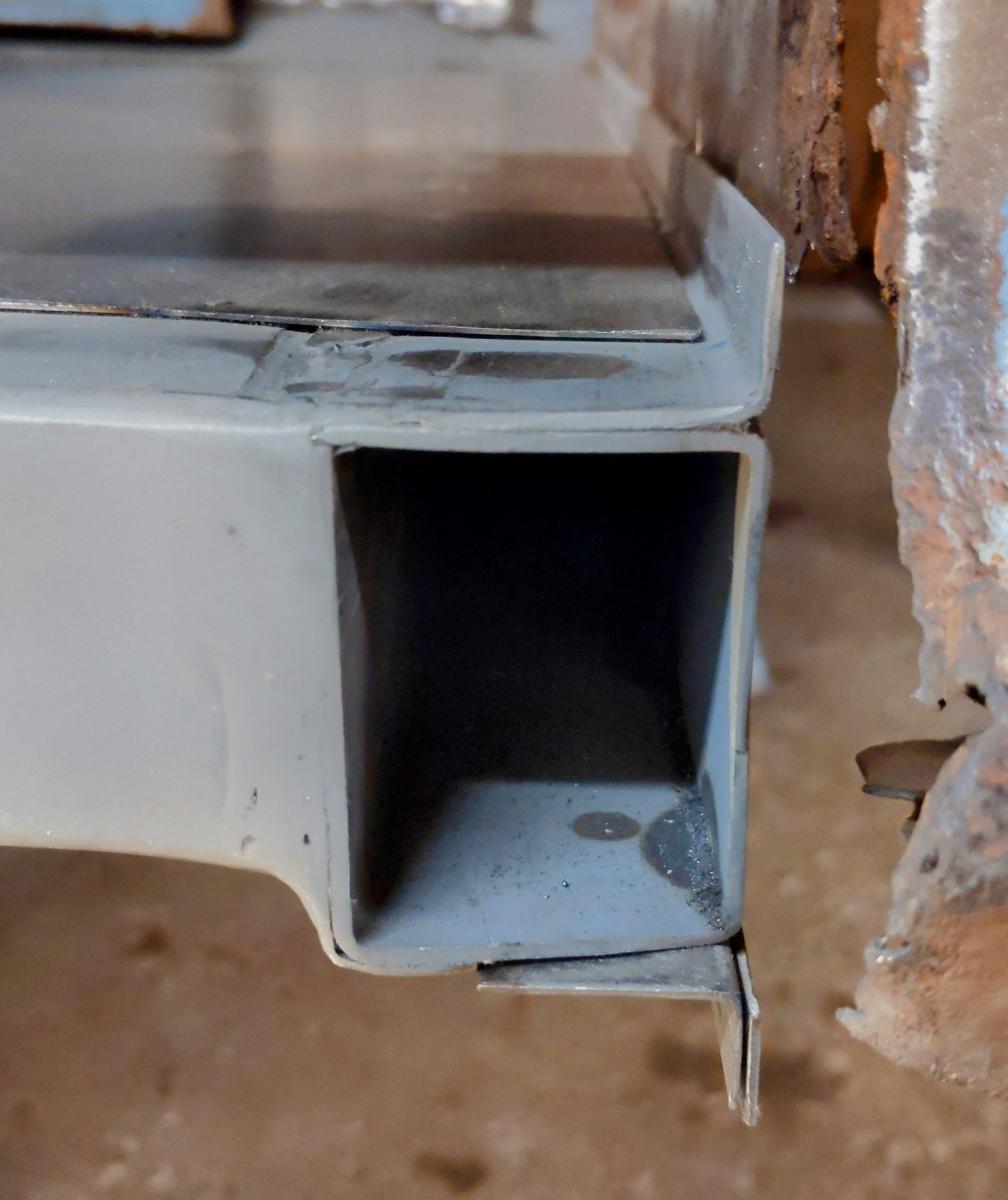

    Got after the bottom few inches of the right rear frame rail/inner wheelhouse (all one giant stamped piece) last night, and was able to get the patch tacked into place. Fortunately, this area is accessible with the quarter panel still in place, but access and space decrease significantly going rearward as the quarter panel tapers off, so the very tail end of this patch will have to wait until the quarter panel is removed. Every time I crawl under the car, I'm reminded of the reality of old metal meeting new, thinking both sides will be flat and straight, but that's never the case. In the case of this inner wheelhouse, it's wavy where it was originally spot welded to the inner trunk floor and frame rail, so getting a perfectly straight and even butt joint here is likely in the cards. A few plug welds near the bottom edge at some tacks across the top butt joint should be fine for now. I feel fortunate the rust was mostly contained to the frame rail channel, and didn't extend any higher in this area...well, the heavy rust at least. There's plenty of surface rust to be addressed once the quarter panel comes off:
    Below is a close up of the rear end of the right hand frame rail, with the rectangular sleeve I added and various other pieces need to match up to the original layers of sheet metal. I left some of the piece a bit long, to be trimmed later, once the rear valence panel is repaired and reinstalled. You can see the condition of the lower edge of the quarter panel isn't great, as this was the low point of the car, where all of the water drained when it was warm, and froze when cold, so, heavy rust.
    Better(?) shot of the underside of the trunk floor showing the two wide c-channel braces/supports, and the front strap hanger brackets. Nothing fancy, just something to make the trunk area strong enough to support a spare tire and a full tank of fuel, without hanging down too low, which was a major issue with the stock trunk floor.
