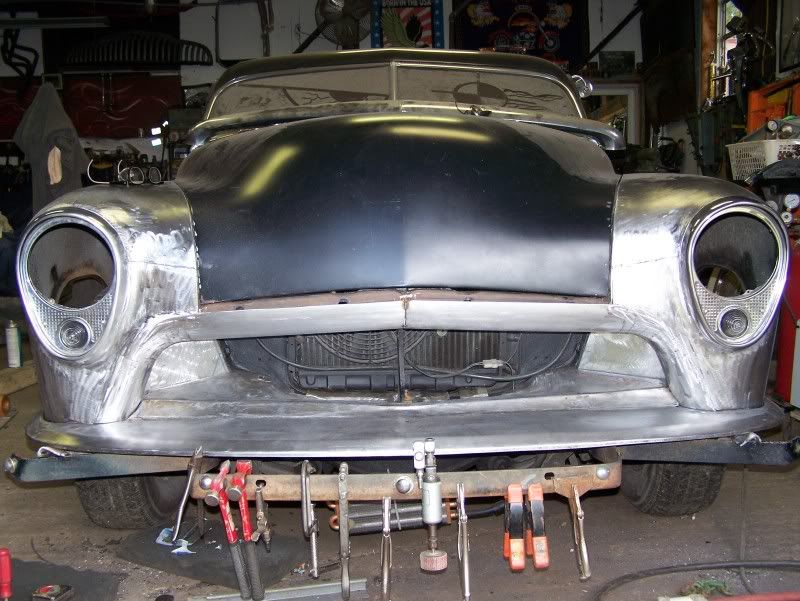

    This headlight / grill surround portion has taken quite a while, w/ all the planning, sitting back and starring and finally doing, they are finally welded in for good!
    Somethings may look a little out of square but for sure its the camera angle because thats one thing that was watched w/ a close eye (plus the hoods not lined up yet).
    Heres a quick tip for any one dealing w/ the buick headlight treatment. These cheap clearance marker lights are the perfect size. Just hole saw A 2" hole, tack weld in the metal "bucket" and install the trim ring
    I may even do a tech post on how I did the buick lights since all this will be buried in the build post.
    jeff

    Your grill opening is looking great! The 5in pipe looks way better than the 3in. Great job. The photoshop that JamesD did with the rear fenders reworked will look bitchin if you decide to go that far.

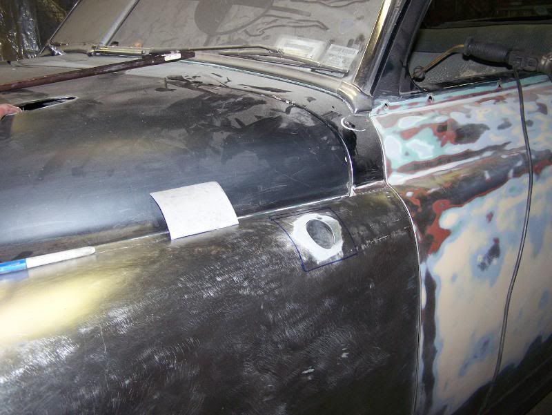

    I never did like the Frenched antena HOLE from the previous owner. All the the work Im doing to smooth the body out and then theres this big sunken HOLE. So I was forced to cut it out
    and fill it in
    then while wiping things down I found a huge bulge in the front fender. No idea how I never saw this considering the amount of work I did in that area, but Im sure that work resulted in too much shrinking and streching.
    The only way I could think of to fix this was more shrinking. Not really knowing what I was doing I figured just grab the torch and jump right in.
    Heres what we started w/
    just a little:
    Maybe a little more:
    Hmm,, maybe a little too much.....
    So I may have gone a little too far w/ shrinking but at least now I feel like I can smooth this out and have it look right.
    Its pretty neat watching the metal react to the hot/cold.
