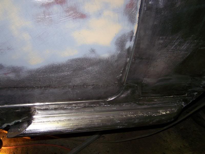

    Of course the door jamb has to be reworked for the radius corners too. In this pic you can also see the new rocker panels top edge. I found this to be a super easy way to get all the gaps nice and even, just cut off the old ones and weld new ones on straight :)

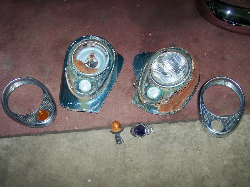

    The wind splints (I think thats what theyre called) that were added to the '49 ford lights where pretty crude. Once again I stared at them for a couple days , then just cut them off

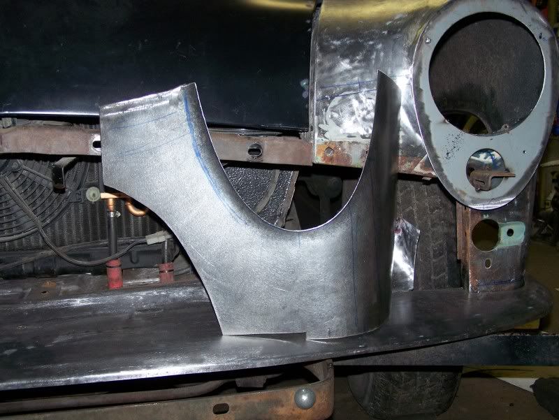

    Finally found a direction to go w/ on the front end. Im still working out some ideas in my head such as how I want the grill opening to look.
    So far this is all I got.

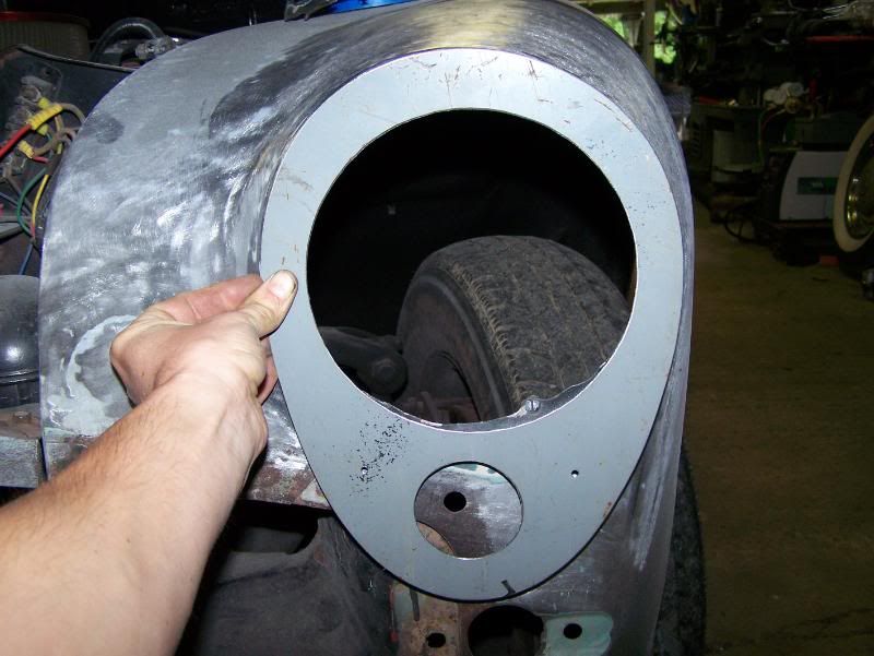

    I also started to blend the front fender into the '53 buick light.
    so far, so good
