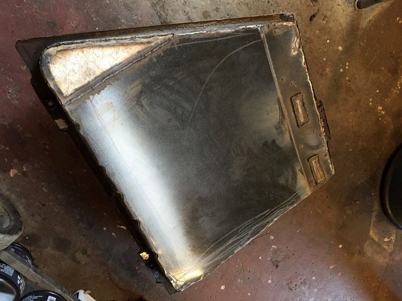

    Pulled the hood and front clip, worked the hood first cause its raining outside.
    All patched up.
    A coat of "All-Metal"
    Primer

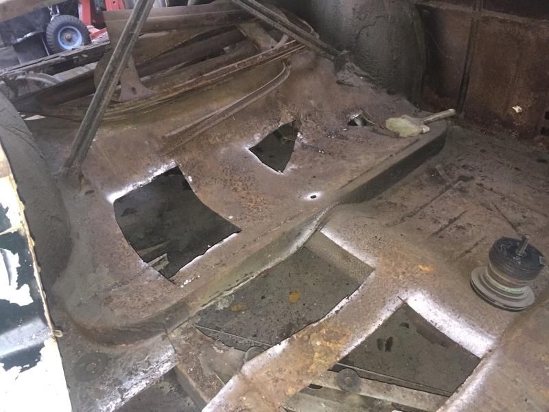

    So, Time to dig into these floors.
    Everything is marked...
    Lots of cutting...

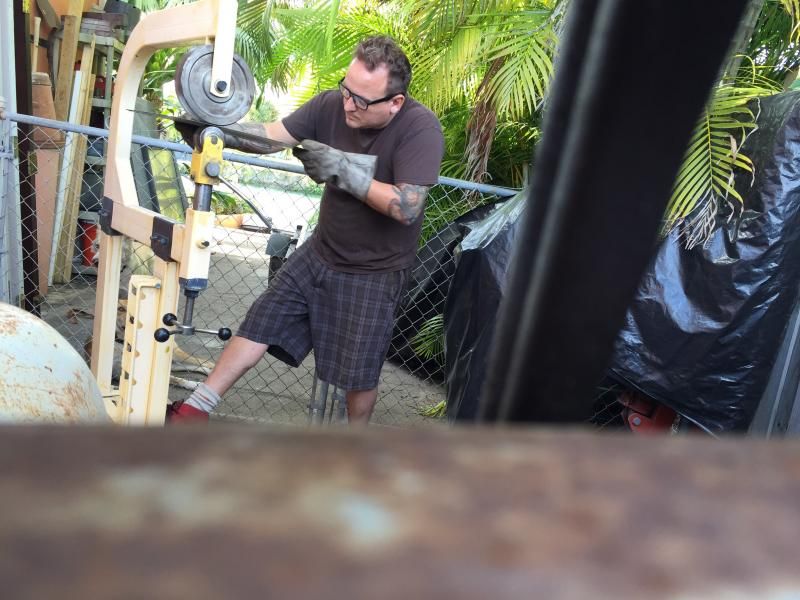

    Got to try out this old Bead roller (Thanks Sergio).

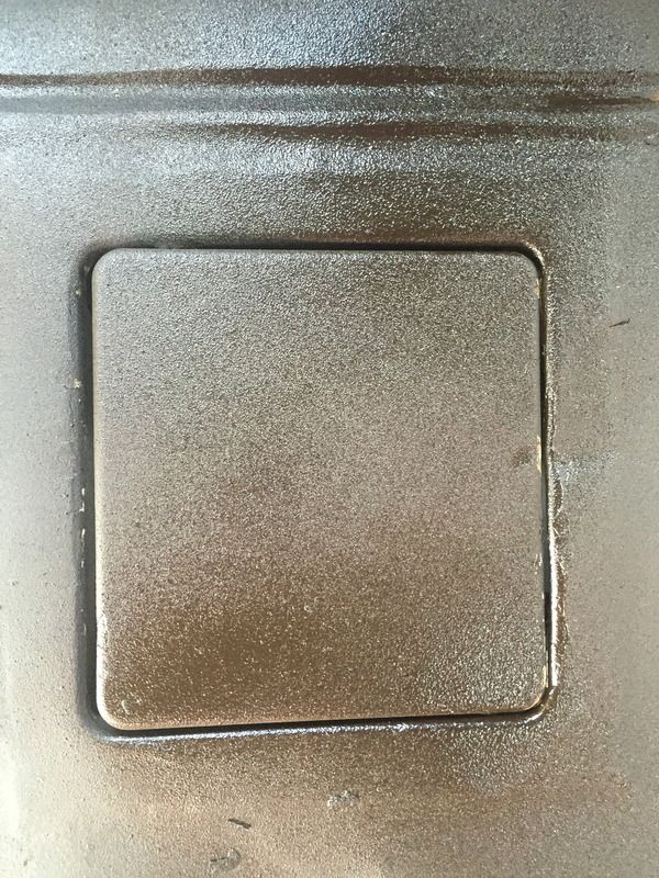

    Made a pretty cool spare tire well..
    Even put in a little trap door for access to the fuel tank sending unit...

    Floors and trunk are done. Not pretty but they should last another 65 years.
