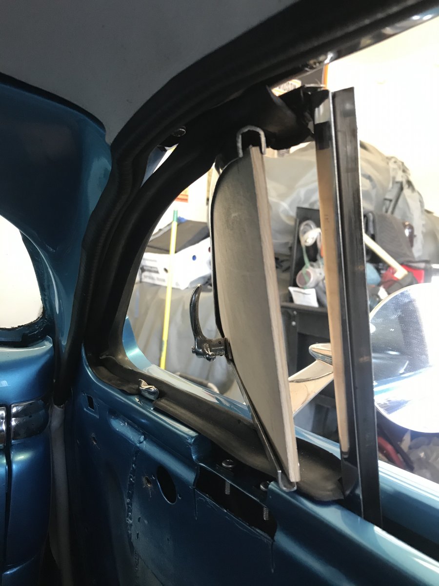

    2664D908-4FE3-4ECD-B432-39011B423CA2.jpeg 326179E3-E373-4C40-8665-7545D92E31B0.jpeg C96E3913-C8CE-470A-B580-4CCC28E93333.jpeg
    here are some more progress pics on the reverse opening wind wings. Still need to polish the window frame and have glass cut but working out so far. Tough project And it’s giving me more respect for the guys that do these a lot. You have to trim the rubber weatherstripping and keep cutting and finishing all metal so everything will work properly.pics show it closed, open and view from inside where are you see that it will drive plenty of air into the car nicely.

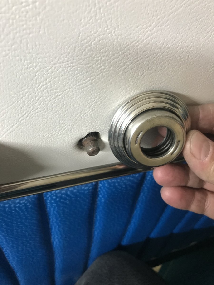

    D13B17B4-E671-4EF1-AFE7-823DFC86AAEA.jpeg FEE1032B-6F1A-4F8F-964A-8C25992BA793.jpeg B0A8816B-27A3-44D2-A917-68841FA2A515.jpeg 803C58C5-131F-4B0B-B388-C77CB677157A.jpeg 19362E89-D3E2-47B7-82BA-74559BF5C857.jpeg
    Hello, here’s another update and something a little different. I might not be the first person to figure this out, but again, giving back to the H.A.M.B. is important to me.
    While installing my door panels after all the fabrication on the wind wing frames and windows, I re discovered an age old problem with installing door handles and window cranks when using the additional decorative escutcheons. The issue is having to use the “pins” that go through the handle to hold it in place on the door shaft or window crank while at the same time trying to hold the sleigh loaded escutcheon collar out of the way. I know there are special tools for this task but even those are a pain to use at times. You also need a needle size drift punch to install the pins all the way in. Next, the pins also are typically a tight fit and if and when you need to remove them again, it’s just a pain! Last, guess what happens over time? They rust in place and then have fun getting them out!
    I decided to dilll and tap the holes using a 6/32 Allen head set screw since they fit flush and the escutcheons will work well. I also used anti siege on the threads so they don’t rust in place too and it is much easier to remove them for future repairs etc. see the pics above. finally, I decided to wake up the door handles and window cranks by painting the flutes in them themed to match my car-bid difference a little detail makes, huh? I used a “paint pen” by Sharpie with actual enamel in it and it flowes nice and will be easy to touch up later on.
    Hope this helps others, now back to the wind wing project

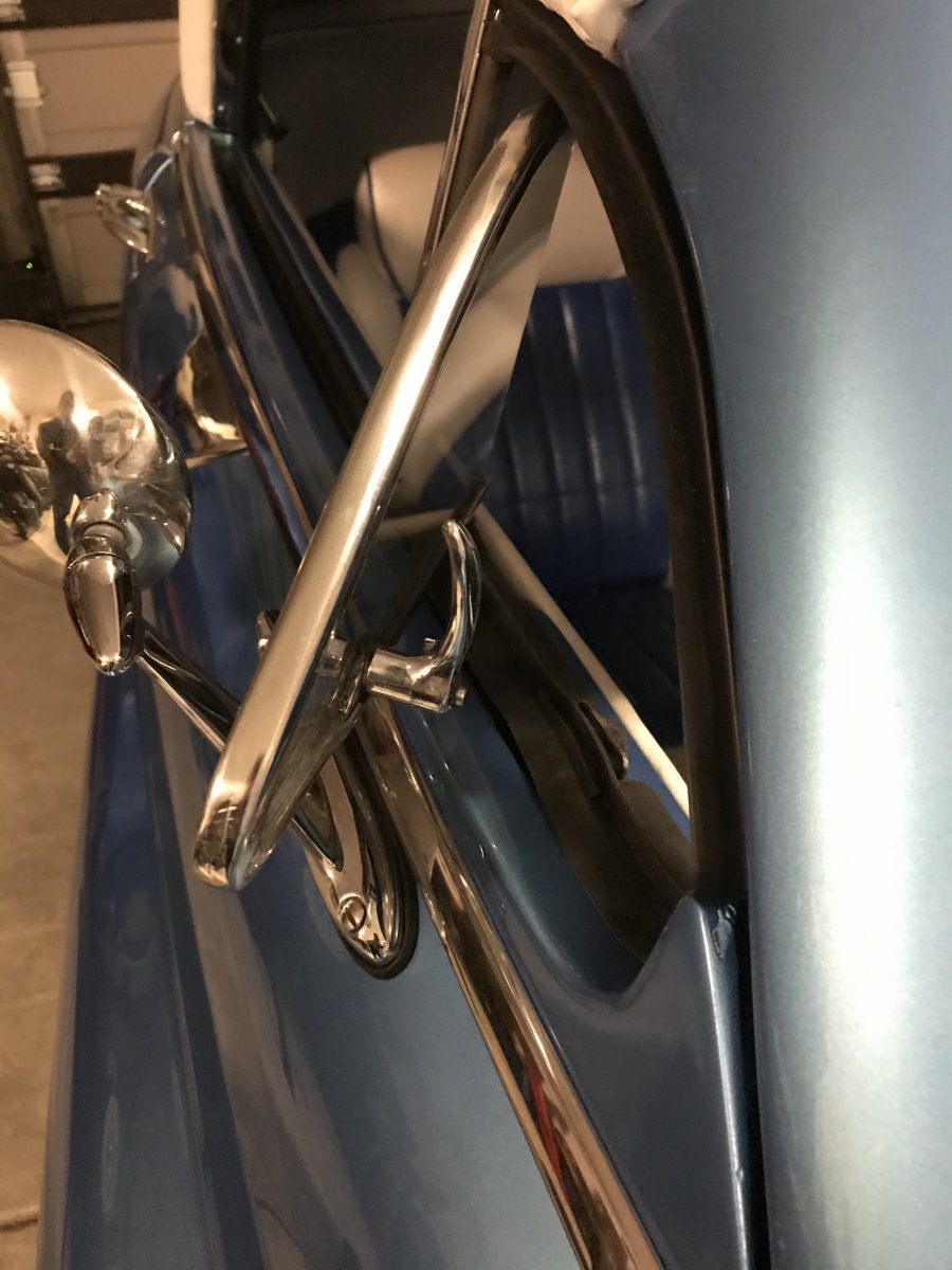

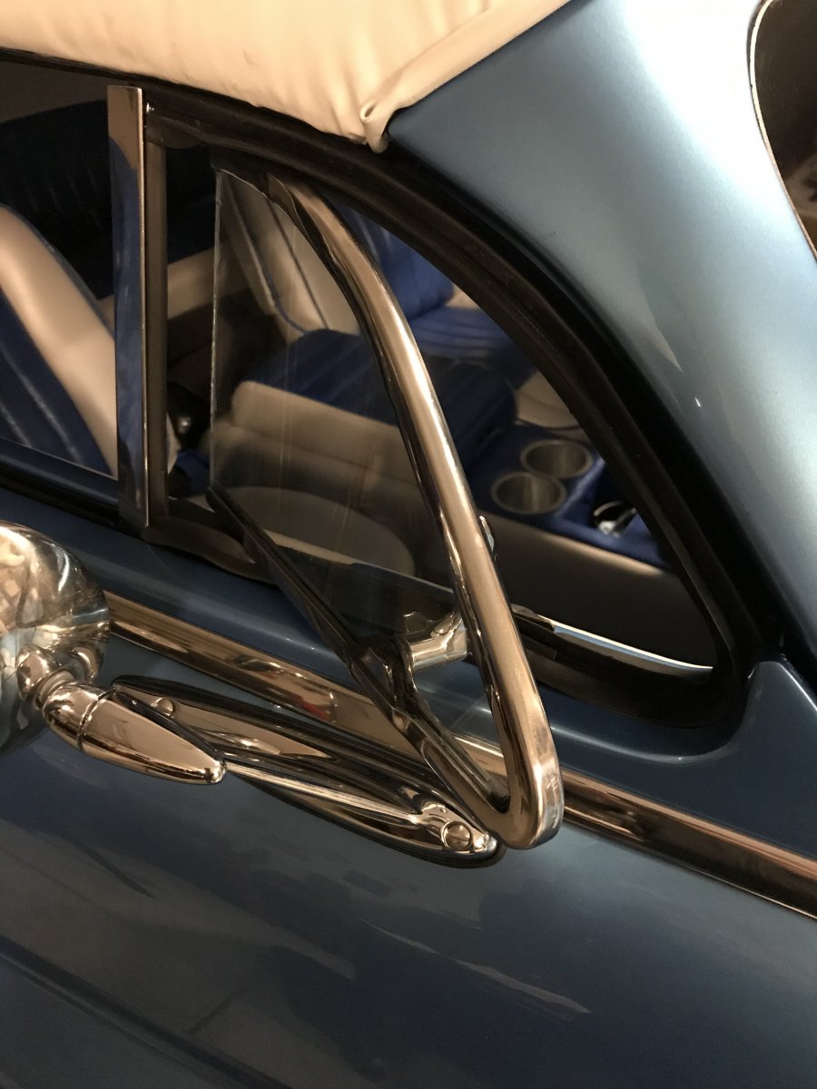

    Hello, finally finished the wind wing project. These work GREAT at any speed and don’t blast the heck out of you when open. Took some time to finish, polish and get the glass cut and final installed but way worth it for me and passengers C4821CFD-AD4B-4DB7-8CA9-9DD1CC7BF53F.jpeg

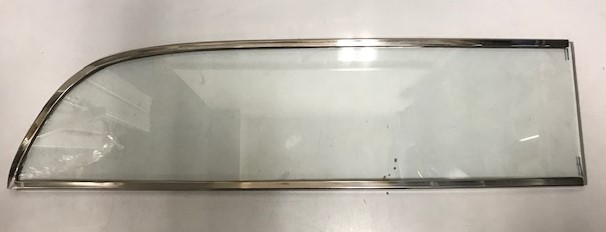

    Thank you very much Stray Kat, sometimes wish I lived closer to you guys so I could participate in your event. The door handles were a cool idea but in reality not well thought out, one of the mistakes I made building this car. This modification was purposeful so the door handles would lock and they serve this purpose, even though it was a lot to do as I also had to also graft the latch mechanisms into the pillars. The mistake was that I did not look into how the door windows would work in their tracks and most unfortunately, they do not work as the handle mechanisms block the window from being installed and working. With that, came another challenge. I was able to modify and install the wind wings to work but I still needed side windows for obvious reasons. So, I reached out to Craig Gilliam and the one and only Gene Winfield and their solution was simple and effective. I built some window frames out of 1/2" stainless steel tubing by first bending the tubing into the shape I needed. I used the stainless tube versus carbon steel tube like Winfield used in past projects so I would not have to have them chromed incurring big expense. The stainless tube is relatively easily polished to a mirror finish and will be easy to maintain versus chrome. Once Gene and Craig saw this, they were impressed and will look into this way of fabricating window frames in the future. Then, I cut a slot into the tube so the glass would fit into it and had my good friend Jon Hair, who is a master TIG welder weld it up. Next, was to make the glass templates for the glass shop out of 1/4" plywood, an easy task. Last, I built a channel out of 3/4" carbon steel for the door slots where the windows normally go and was able to attach it into the wind wing frame and door frame at the rear of the door. The windows frames neatly fit inside the door channels and lock in at the bottom and the glass is longer than the frame at the front and they neatly slide in and lock the front in place and will work excellent. I'll make a small bag to store them in when not in use although currently, I like driving the car without them as there is minimal air blast flow with the shape of the car, even at highway speeds. Just a bummer not to have roll up and down windows but these will work well, look good, provide sealing against the elements and security when in place too. Here's a couple of pics:
