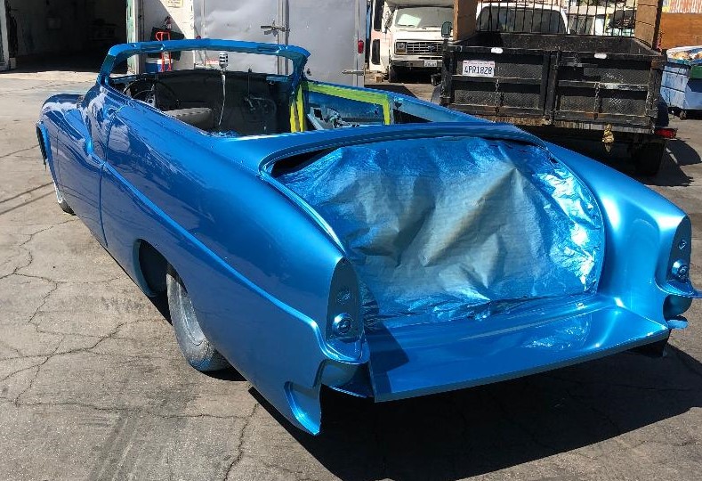

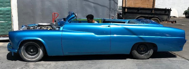

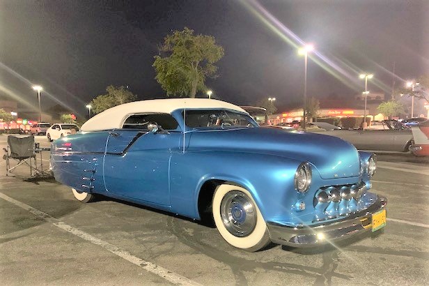

    This was a long time coming after a long battle with building a Kustom Merc! Finally, my first "Cruise Night" and the car made it under its own power. There were about 25 cars that night parked across from me and this very nice Baby Blue 41' Kustom. It was a great experience and a learning one too as a few gremlins showed themselves and have now added to my list of "to do's". These included the addition of Air Shocks in the rear, Gas Pedal rework, Trans Shift Cable adjustment and getting the side windows and wind wings along with Stainless trim to be made.
    What a rush it is to pull into your first cruise night and see other car owners stop what they are doing to check out your hard work and finished piece of rolling art. Then the questions start and you realize that all of your hard work was worth it to be part of the "car guy community" and meeting people like who are right here on the HAMB.
    Better pics to come at my next outing along with updates on the Stainless Trim we are making and the side windows and custom wind wings being worked on. Stay tuned.........

    Nice "first" too check off your list. It will never stop. Of course the car guys at the cruise-in checked it out, but when you're getting gas, going for ice cream, whatever ... you're going to have people want to talk to you about your wonderful Merc. You'll here about the one they had back in the day that was "just like yours", except it was a four door, and a Plymouth. You'll get the "how much you got in it?" to "I know where there is one of those sitting behind a building"
    Have fun, enjoy that killer Merc.
  6. No matter gremlins always creep up.
    There is nothing like that first cruise.
    Jaws will be sore for days, cause you smiled ear to ear.
    Enjoy that beautiful merc
    54delray, loudbang and chryslerfan55 like this.

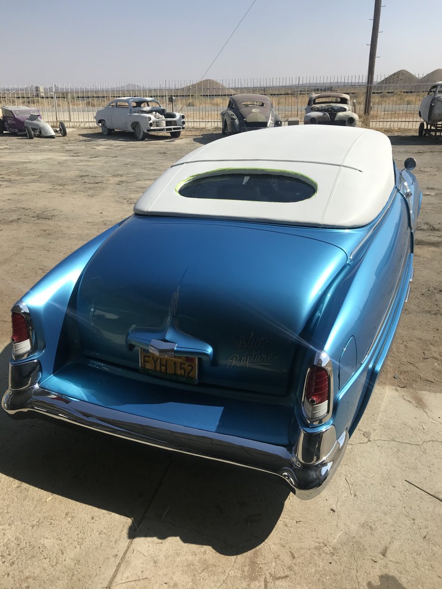

    Here is a pic in the daylight.......We think that the cool part is that this is a factory color used on a recent year car. This way, I can easily touch up when necessary and/or paint other parts like the motor components etc. The pearl in it and the way it changes color as seen here is what drew my wife and I to it.

    That looks fantastic on that car. A lot of the new car colors have the look of a custom mix that we would have had to have someone do only a few years ago.
    I've got to say that everything flows as one unit on that car from bumper and frenched lights to the rear bumper tips. I'm not usually a fan of bubble skirts on a 51 Merc but you got those to blend in as a contributing component rather than looking stuck on as an afterthought and that is hard to do. Well done on the whole car.

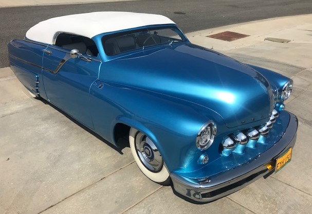

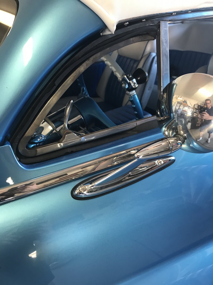

    Here is what I have been working on with the Vent wind wings. These were taken from a rear door Off a 4 door Merc and flipped to the other side of the car. You see that they ope the “wrong way” BUT I found if you adjust the nut in the spring and add tension it will not become a problem with the window flapping around.
    You may ask “why would you do this?!?”.
    Anyone who has a chop top car will attest that they do not ventilate well unless you are using your ac all the time. I wanted to figure out a way to get more fresh air into the car. This may be a good solution, as it will allow air to come in freely! So far I have many hours cutting these down and fitting them and hopefully I will be done soon and share more pics.

    Very curious how this works out, I need vent windows and this configuration makes sense to me.

    All good so far ZZ Top Chop, I will update as soon as I can find the replacement rubber for the rear door vent window from a reputable source, some of the ones I have looked at are saying that 49-51 area all the same-this is simply untrue and I need to get the right rubber as it is expensive.

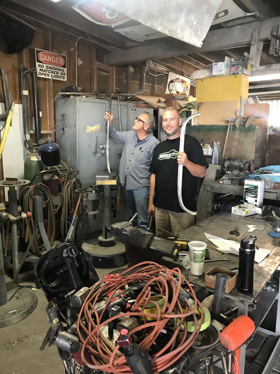

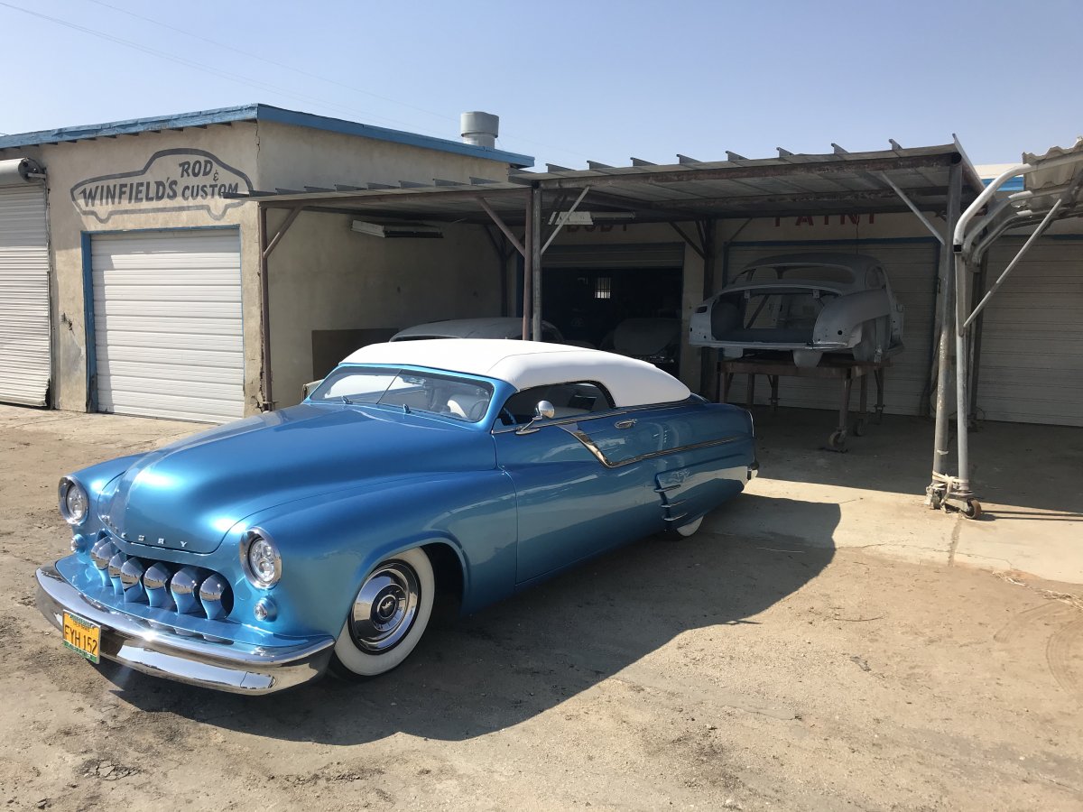

    9F39253F-705D-4C7D-BCDA-ACE973ED9C2C.jpeg 9B79A26B-D553-4F52-8FA8-E67AB7354819.jpeg 9F39253F-705D-4C7D-BCDA-ACE973ED9C2C.jpeg IMG_1143.jpg Hello everyone,
    Since I have the wind wings figured out for the most part, I am now waiting for the new weatherstripping to arrive for them to complete the job. More to come as I’ll show the finished product once completely installed etc. these will work great as during my road trip I used a small piece of wood shaped like the wind wing and simulated the action while driving at various speeds. These will be wonderful and the test has me laser focused on completing them after the results I got, were “cool”, literally.
    So.....
    Yesterday, I took a road trip to the one and only Gene Winfield’s shop to meet up with Craig Gilliam so we could begin making the Stainless trim ring trim for the back window on the Carson top.
    While there I met up with BJ from Louisville, KY and his friend Tim Koon from West Virginia as they were visiting Gene and making plans for next shows in the future. These two guys help Gene around the country when Gene does chops at car shows, especially Tim as he has done many with Gene in past years.
    While Craig and I were working, Tim took an interest and Craig asked him if he wanted to help and learn which he jumped right in!
    I believe in giving credit where it’s due as you can tell by this build thread so here are some pics of yesterday’s activities. Tim is building a bad ass sled of 297D32A4-D9AE-466F-9C79-F6141588B947.jpeg D19EA656-D6E8-48BC-9241-213F20D70D9A.jpeg 9B79A26B-D553-4F52-8FA8-E67AB7354819.jpeg his own and he’s a young man with lots of talent, watch him in the future.
    The pic on the old school bead roller is me in total concentration (funny to see the expression!) helping Craig G form one of the pieces.
    You can see Tim fitting a piece on the car and working with Craig on one of the forming stations in the shop. I’ll post more once this is completed, polished and installed.
