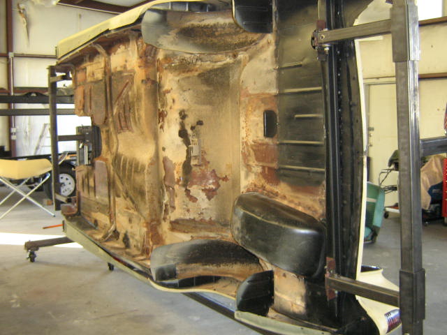

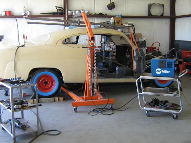

    Been working on this Merc for some time. Chop is complete, custom chassis by SlddnMatt is complete. Now it is time for the body to come off the stock chassis, prep the underside of the body, and install on the custom chassis.
    Yesterday, I took the plunge. Removed the hood and front clip, doors, and trunk lid. Removed all the body bolts, connected the body lift, and OFF came the body. In the process of securing the body to the rotisserie.

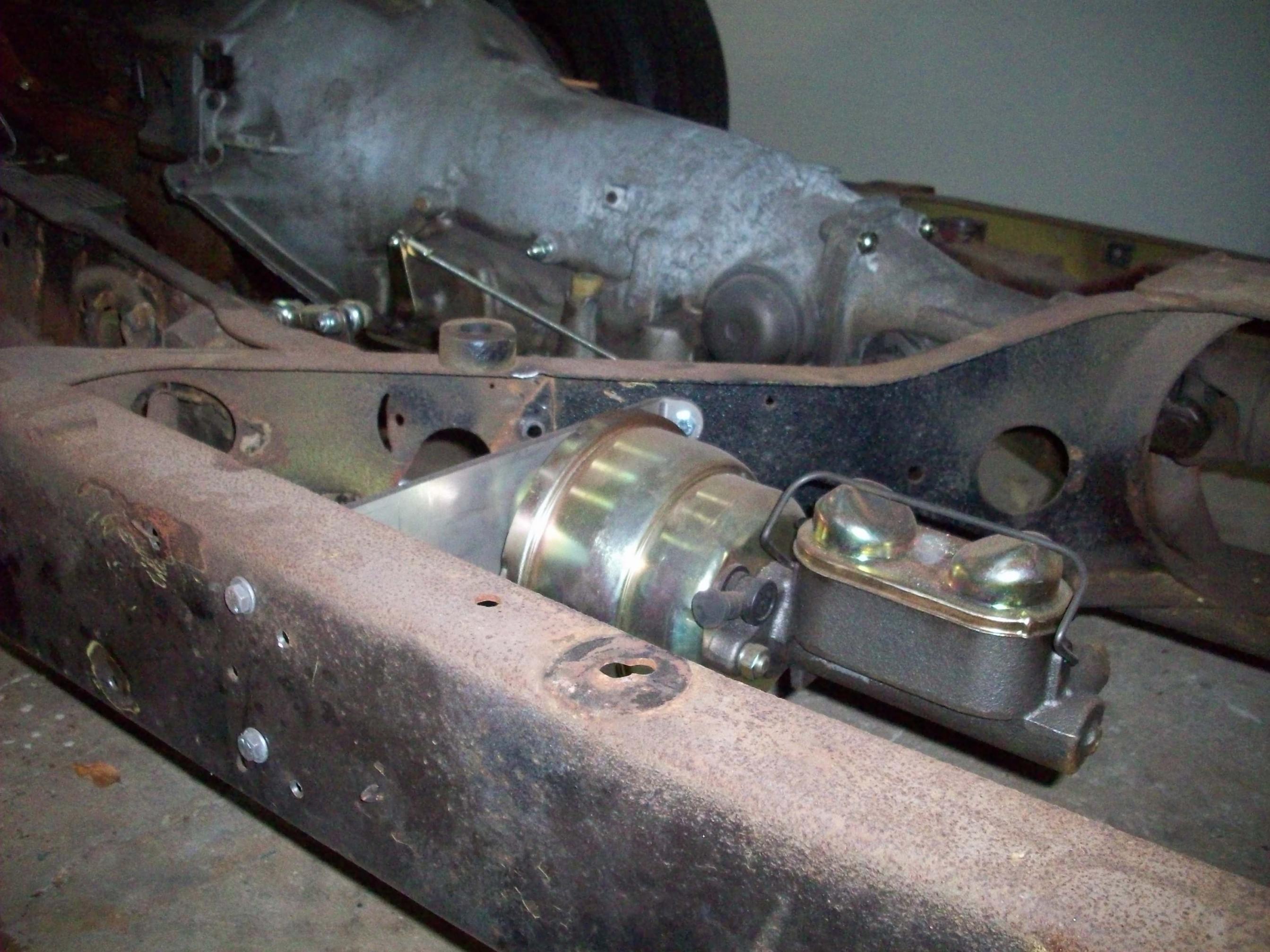

    Any chance you can take a few pictures of the frame where the master cylinder is attached, along with the pedals, and trans crossmember? I could use some better pictures for reassembly and you have just what I need.

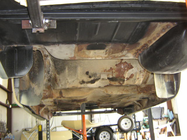

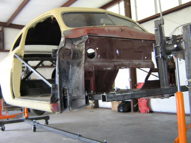

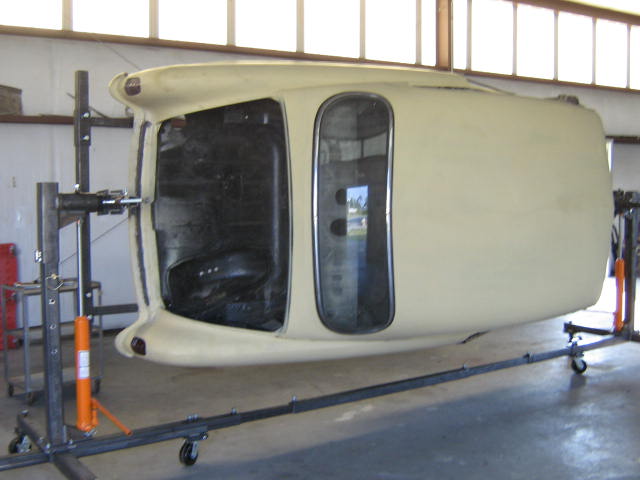

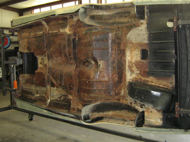

    Spent today securing the body to the rotisserie. Lots of work, but worth the effort because it will make media blasting the firewall and underside of the body very easy.
    Also gave me a chance to really inspect the floors. Noticed that the driver's side rear floor and passenger side under the rear seat area need some rust repair.

    Spent several hours this morning scrapping the factory undercoating from the underside of the Merc in preparation for media blasting this week. Plan is to have it ready for the blaster on Friday.
    This is the first car that I have used a rotisserie, it sure does make life simpler.

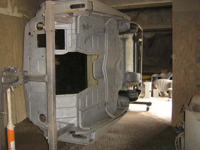

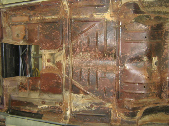

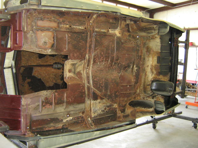

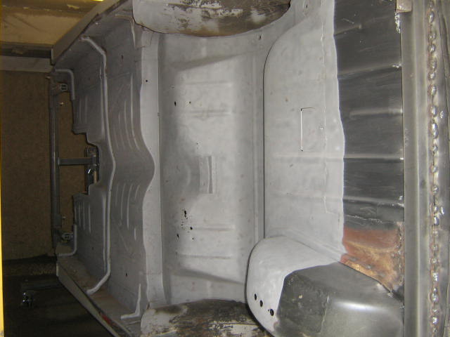

    Busy day today. Media blasted the firewall and underside of the body. What looked like alittle floor repair now is more obvious driver side rear floor and underseat floor repair. No surprises now...everything is easy to inspect.
    Sheet metal repair, self-etch prime, and then paint. Body is getting closer to being installed on the custom chassis.

    Savannah Powder Coating actually did the media blasting for me. They are conveniently located in the next building. Just had to roll the rotisserie a couple of hundred feet.

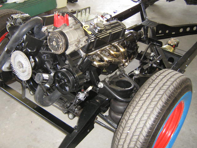

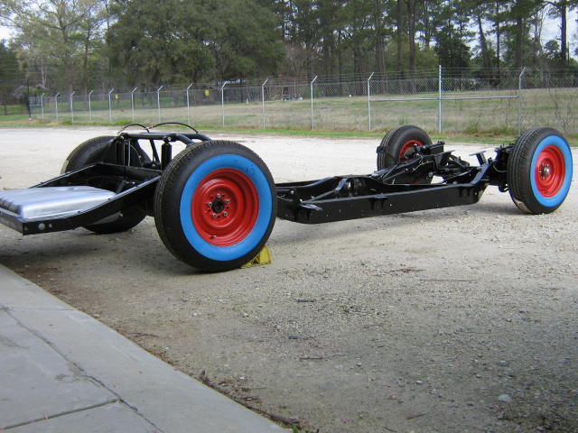

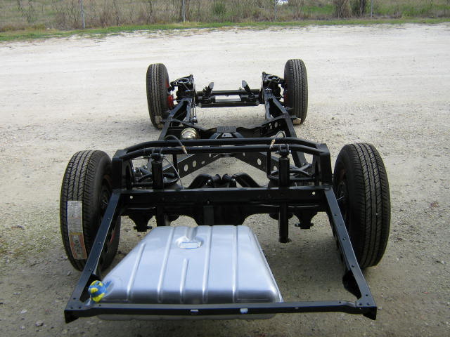

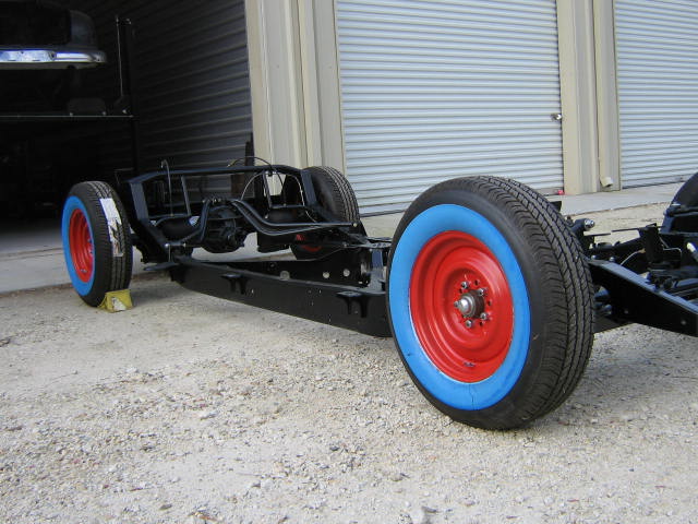

    Here are some pix of the custom chassis that will be used in this build. Engine is a SBF 347 ci stroker with an AOD trans.

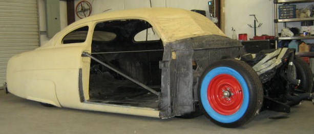

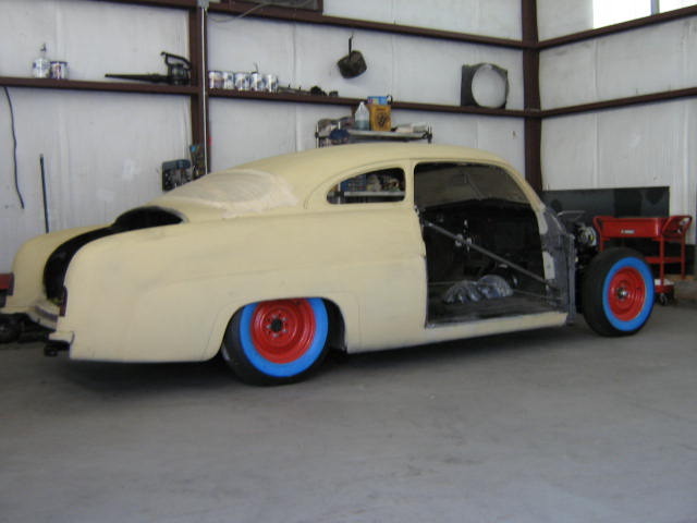

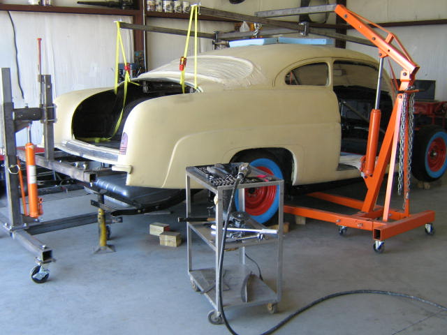

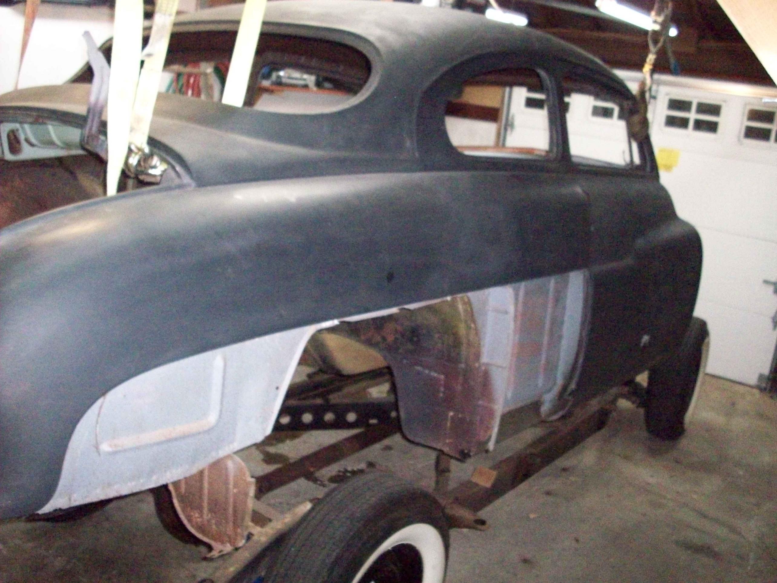

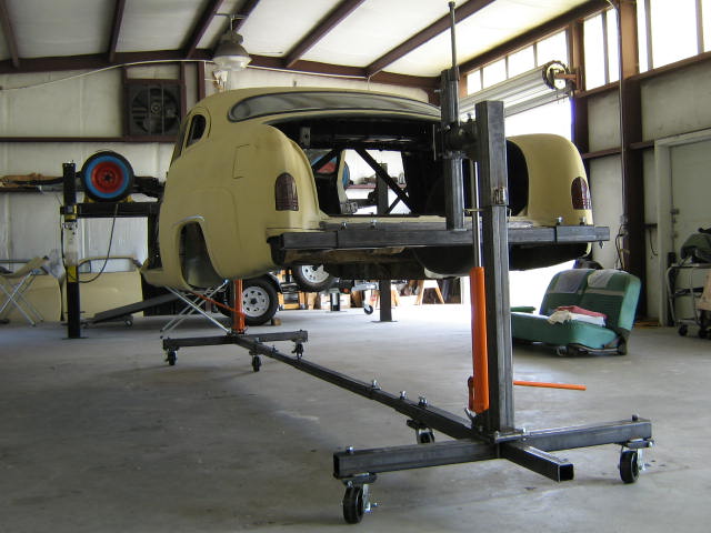

    Installed the Merc body on the custom chassis today for the first fitment check. Had to modify the rear floor area to clear the chassis suspension mods.

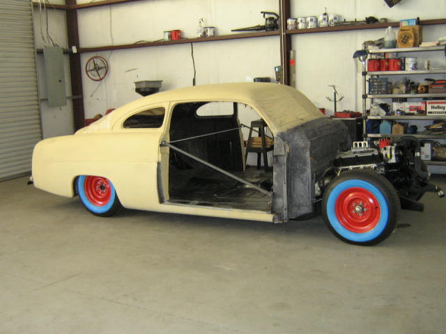

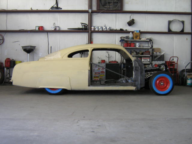

    Here are some pix of the body finally sitting on the chassis. Looking long and low! I won't have any problem "laying frame" with this Merc. In these pix, the suspension is at normal ride height.

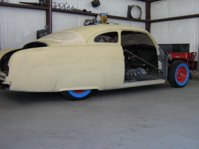

    Installed the stock rear bumper to get some ideas about keeping it, or using a 54 Merc rear bumper. Also, did a fit check with zero psi in the suspension system. Layin Frame is no problem.
