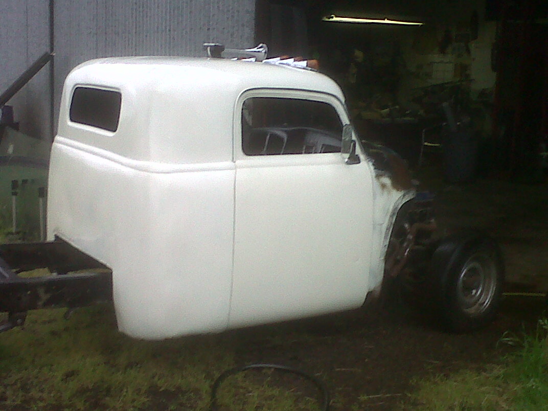

  3. I channeled mine 5 1/2 inches and extended the cab 10 1/2 I've had every big guy that comes in my shop sit in it and they fit just fine, most were very surprised

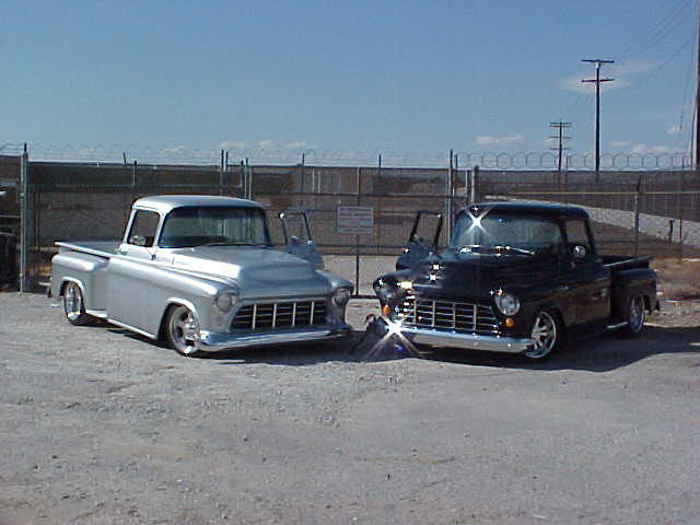

    Mine is channeled 4 inches and I ditched the stock seat and am runnin one from a Astro van that is Quite a bit thinner.

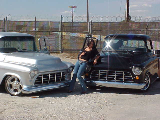

    My 50 Ad has the tank relocated under the bed and i mocked up a seat from an 80's elcamino with a flip down arm rest .Mine is gunna be a daily driver ,so comfort is top priority as far as the seat goes.Im gunna remove the headrests and get it recovered ,but it feels pretty comfy for $20.00 and im 6'1...

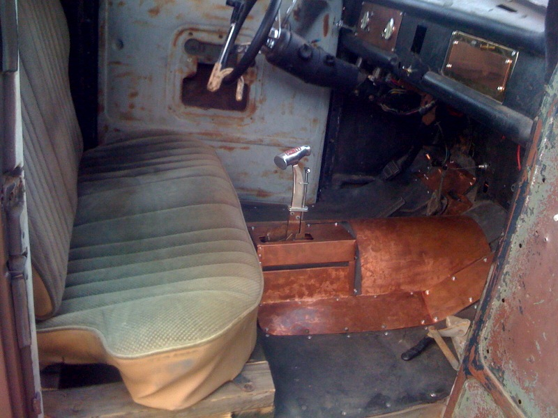

    Even though its not a 50's era chevy I have a 1946 ford pickup(which is smaller) and I fit my 6'5" frame into it by modifying the column, seat and pedals. The seat is a rear bench from a 1975 datsun b210 set 4 inches from the floor. The back portion of the bench is relatively narrow putting my seating position as far back as possible. I pitched the column up to get more foot room(size 14) and moved the pedals down. I didn't use traditional rod parts but I bet you could do the same with an old wrap around rear bench.
  15. I only extended the cab because the utility boxes were to short for my frame. turned out to be the best thing I did.
    I also have an 88 chev pick up seat that I got for free. it came with a matching back seat that folds down for a bed. I modified the front seat and the back seat tracks (relocated my tank) now the front seat moves 14 inches forward and fully reclines for those naps at rest stops. hey I'm almost 70 and naps are important and there are no more drive in theaters anyway hahaha!
