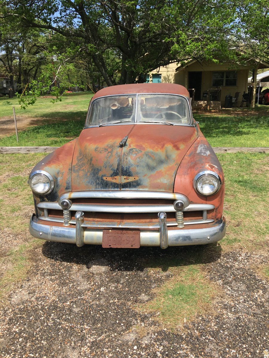

    Okay so I am building this car like what would of been considered Gas Class or Gasser! So anyways here it is. 1950 Styleline 2 Door it is a real clean car IMG_1063.JPG IMG_1065.JPG IMG_1078.JPG IMG_1058.JPG IMG_1059.JPG

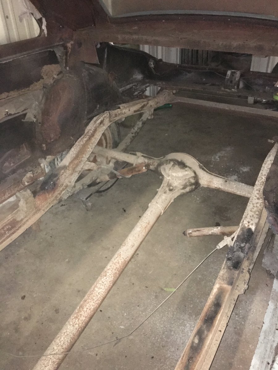

    Not too much to report on today. Besides cutting the rest of the floor out. Still have trimming to do here and there. IMG_2352.JPG IMG_2353.JPG IMG_2354.JPG IMG_2355.JPG

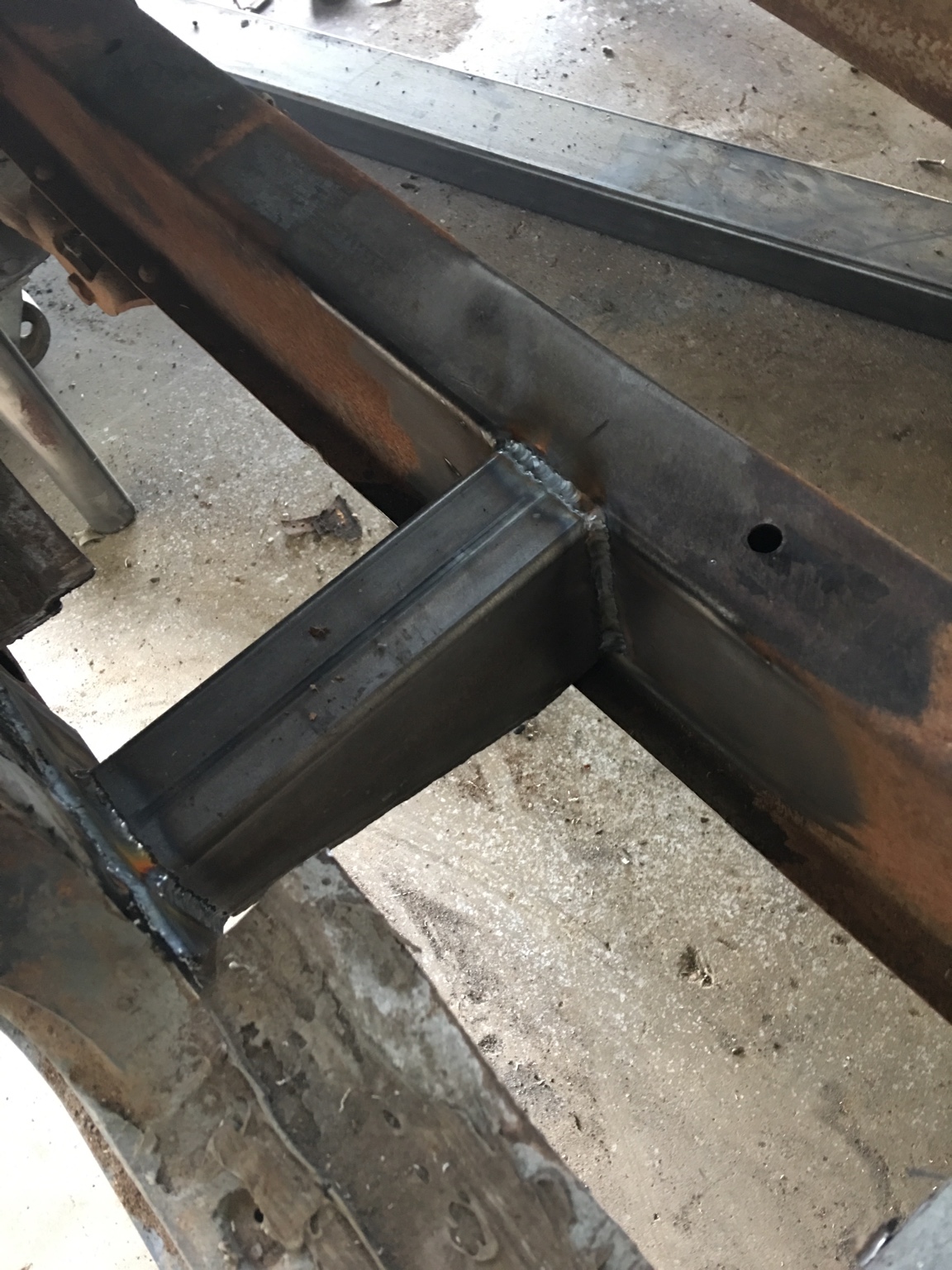

    Finally had some time to work on the car. Started fitting the main hoop of the roll cage today. Fabricated perches from the frame to the inner rocker. [​IMG][​IMG][​IMG][​IMG][​IMG]

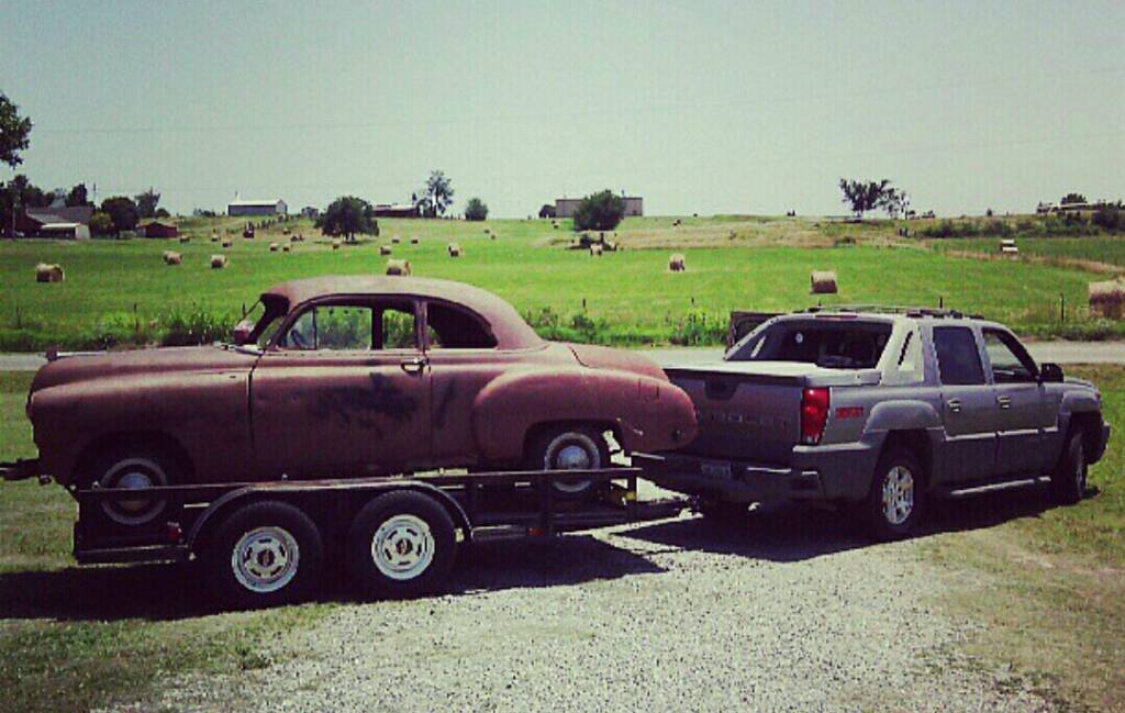

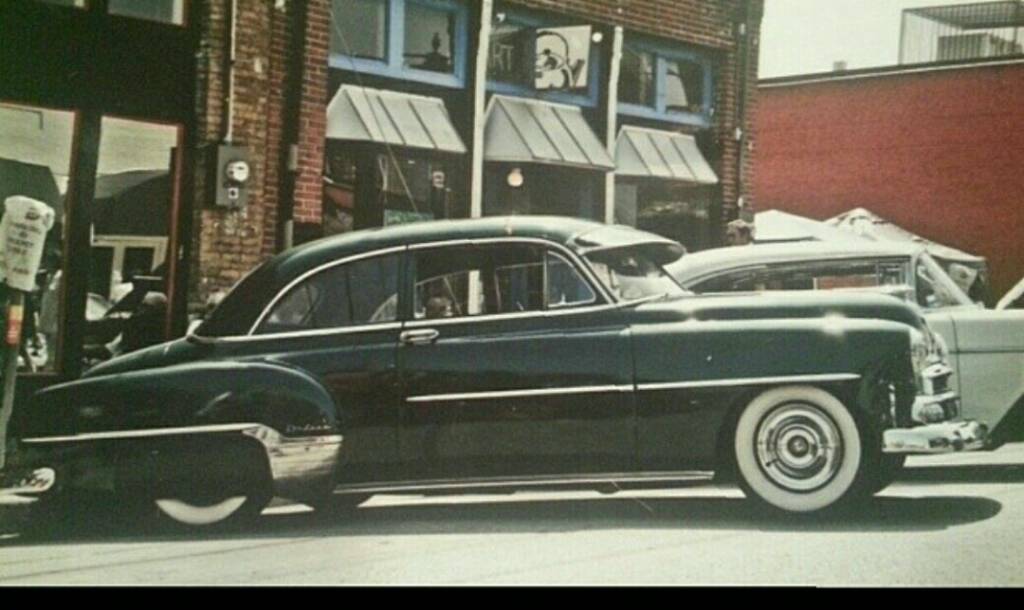

  24. Lone Star Mopar
    Joined: Nov 2, 2005
    Posts: 3,848
    Lone Star Mopar
    Here's a pic from when we first got it. My Pops and I drove to Oklahoma and bought it cheap to do a purpose built race car.
    sent with tin cans and strings.
    kiwijeff and Purple_People_Eater like this.

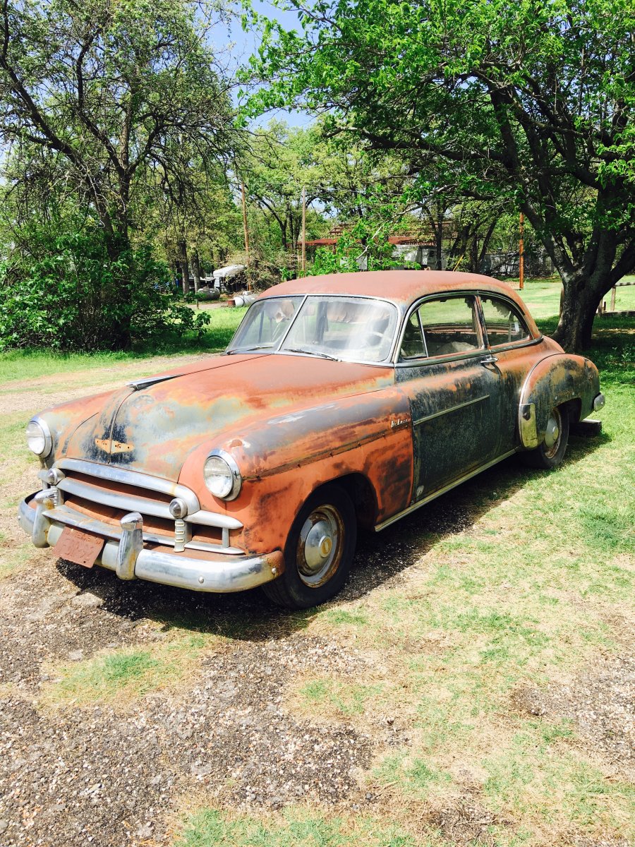

  26. Lone Star Mopar
    Joined: Nov 2, 2005
    Posts: 3,848
    Lone Star Mopar
    I have a sedan for a crusier, always wanted a coupe... Screenshot_2017-06-22-23-05-55-1.jpg
  27. Looks like the body isn't coming off the frame then:rolleyes:.
    Kinda wondering why you would want to do the roll bar now?
    Seems like there's plenty of work to do in the interior, without having it in your way.
    Purple_People_Eater likes this.
  28. Purple_People_Eater
    Joined: Jun 4, 2017
    Posts: 59
    Purple_People_Eater
    There is a method to my madness. I need the front body mounts gone cause of header interference. Cant really place Engine in the right place. Can't really do that unless I weld Front perches on. But I have to install the main hoop so I can mock up the rest of the cage so I can locate where the front perches go. Total snow ball effect. As far as interior goes. Not much left. Besides pulling the side glass. Wire wheeling the rust scale off. Taking a few misc. parts off, And some slight floor trimming. Them paint. It's getting fiberglass doors, and aluminum floors and firewall. I really want to be able to plan out my seat, pedal, and shifter placement. So as I said snow ball effect. I can't seem to do one thing without starting another.
