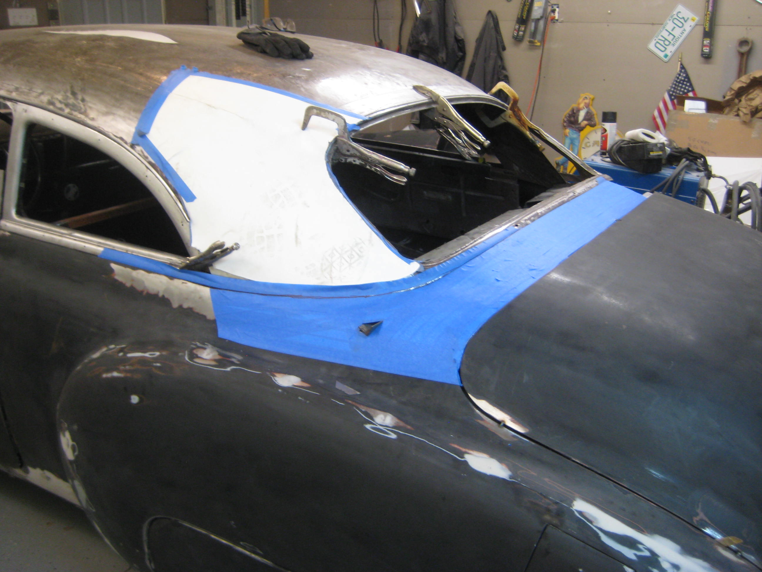

    Some photos for you Jesse. We started messing with the rear window and sail panels. We slanted the window down and also moved the whole rear window forward 2". We will also change the shape of the belt line between the 1/4 glass and the rear window so it flows better into the quarters.

    Thanks Albie. Yeah the weird thing about this car is that it really has very little rust issues for a New England car . Everything is oil collision damage. The right rear quarter had been replaced in the 50s(judging from the lead work)..and then was hit again(judging from the bodo)..It looks like a tree fell on the roof and hood...plus really strange and similar damage on the lower drivers side quarter..Then there are dings some rust and just the usual stuff to deal with almost everywhere else..It's just a lot of work...Eventually the whole body will be metal..but for now I just want to get the chop done, make the body presentable and drive it as I go.

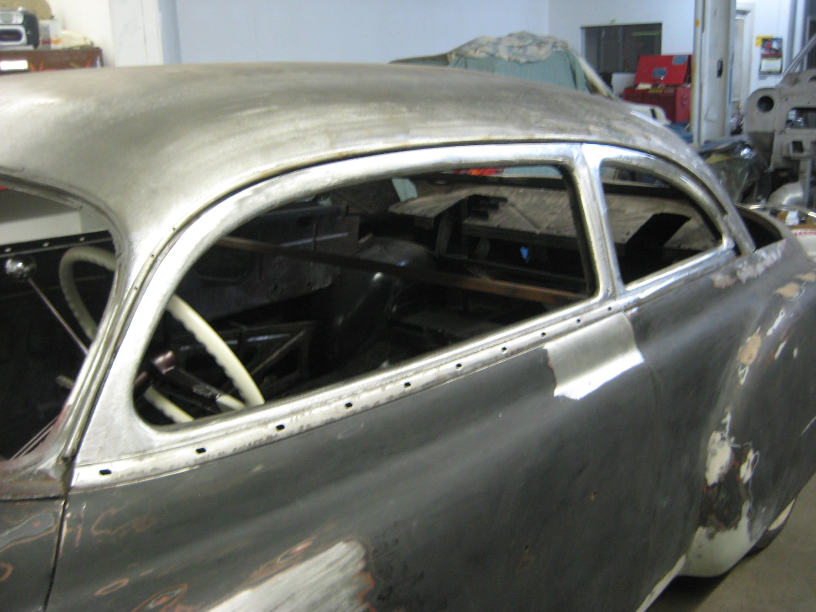

    Some more photos. Got the rear quarter pcs. in and got rid of the trim holes on the door tops. Movin on to the rear.
