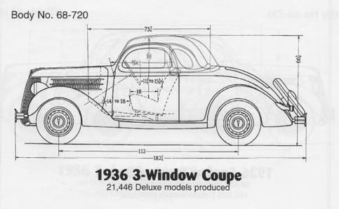

    I really like the '36 ford 3 window coupes, but they are really expensive (even as projects), so i wanted to ask my fellow hamber's. What modifications or alterations do i need to do to a 5 window to make it into a 3 window??? Thanks!

    As far as i can tell, the body line on the roof in a 3 window starts after the rear door pillar. And the gap between the roof and the beginning of the deck lid seems to be longer on a 3 window. Do the 3 and 5 window have different doors??? Thanks.

    Yes, the rear panel is longer on a 3 window vs a 5 window. The doors on a 3 window are longer than a 5 window. So you will need 3 window doors (good luck) or a pair of 2 door sedan doors. You'll need an extra set of doors to cut up to make the rear curve of the top of the 3 window door. Do a search for Cole Foster and the Metallica coupe. I'll see if I can find it for you too.
