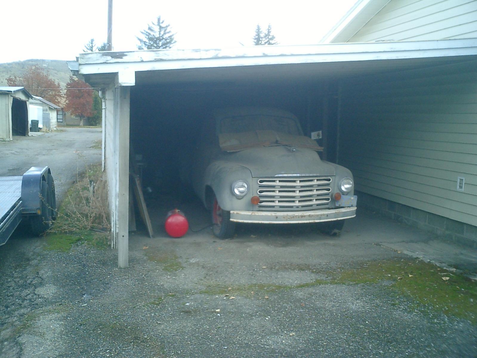

    My buddie made an offer on a '49 1/2 ton short box Studebaker PU today and if the lady accepts his offer we plan on picking it up tomorrow. I have checked my 56 Motors manual and it is not clear on Pos or neg ground for the Battery. Can anyone for sure let me know which! This truck has been parked since 1974 in a carport in this ladies back yard. Mileage is 46,000- no rust anywhere! A few dents not bad. Perfect dash. Motor turns over by hand. Really nice survivor. Pictures to follow if we make the deal. Ter409

    Well the lady who owned the pick-up called and decided to sell. A new price was settled upon and we went and picked it up today:D. All the tires aired up and we loaded it on my trailer. This thing is so rust free !!!! We are optimistic that it will start and run. Real cute truck. Ter409

  11. Did you tow it home with what looks like a 51 Willys Utility ?

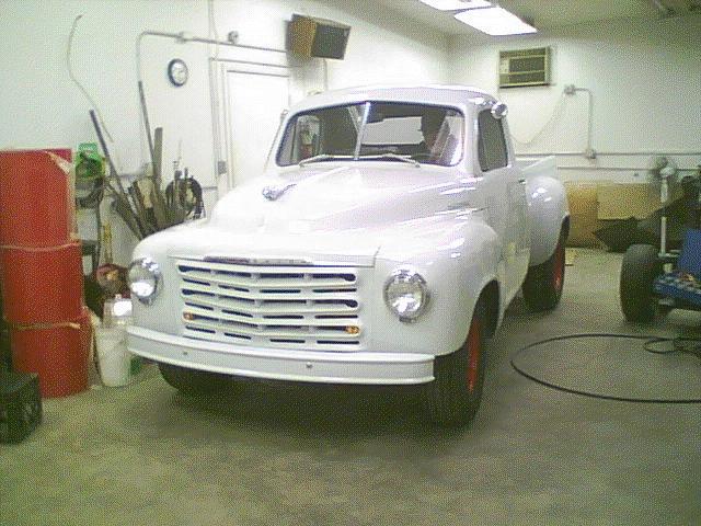

    O.K. We pulled the gas tank that was 1/2 full of varnish. Really stinky stuff! It is now in the boil out tank at the local shop. All new radiator and heater hoses, new fuel lines and cleaned out the glass fuel bowl. New Plugs! Kept the same wires and cap and points. New battery and it was + Pos ground. Ran a fuel line to a can. Primed the carb and it fired up!!!:D Oil pressure 45 to 50. Generator charging. No oil or anti freeze leaks! Had to turn the idle screw in one turn but it idles fine now. Motor is quiet all most can't hear it running. One brake is real tight so we will have to address the brake system but it does stop. Happy Happy Happy :p Ter409

    Deadbodyman!! Update on the pick-up. We had the gas tank in the local shop boil-out for several days before it cleaned up. The tank is now back in the truck. The brakes were not installed correct so alittle work was needed. They now work O.K. The throttle linkage needs some work. The trucks paint has been rubbed out and polished and is in very good condition. We have not found any deep rust anywhere on this truck. It is snowing now so not much is being done on the truck right now. Ter409
