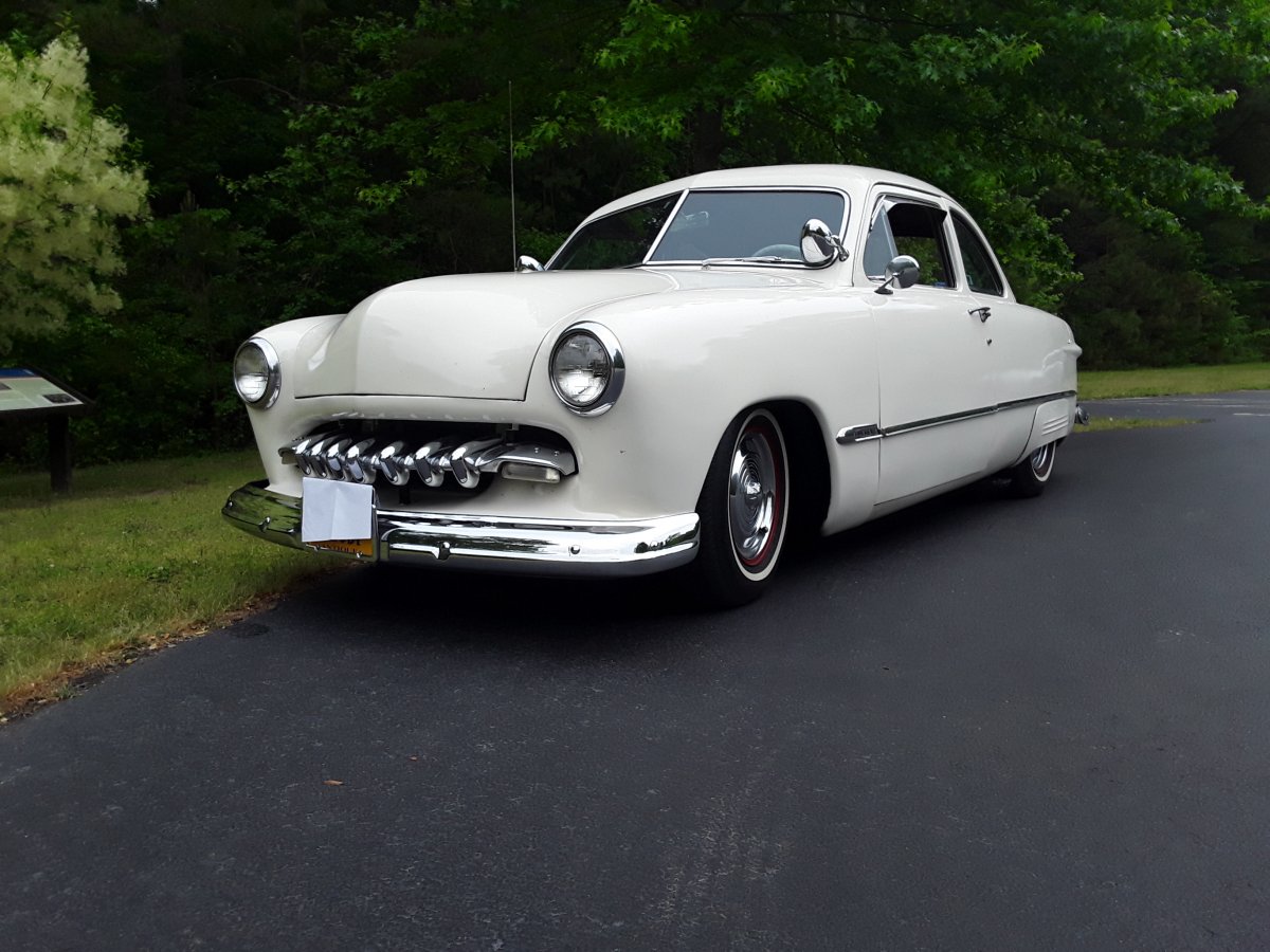

    20180508_092456.jpg Aerostar coils,fatman dropped spindles, posies rear springs with 2 inch blocks. Chevy monza v8 front shocks and 65 Chevy pickup rear shocks. Rides better than stock. 65 mustang rear. Some rubs with the fender skirts on. I have hit a manhole cover or two with the front crossmember.

    Thanks. That is perfect. Love your car
  15. waynegen
    Joined: Jun 10, 2011
    Posts: 32
    waynegen
    Nice car!! Like the color
