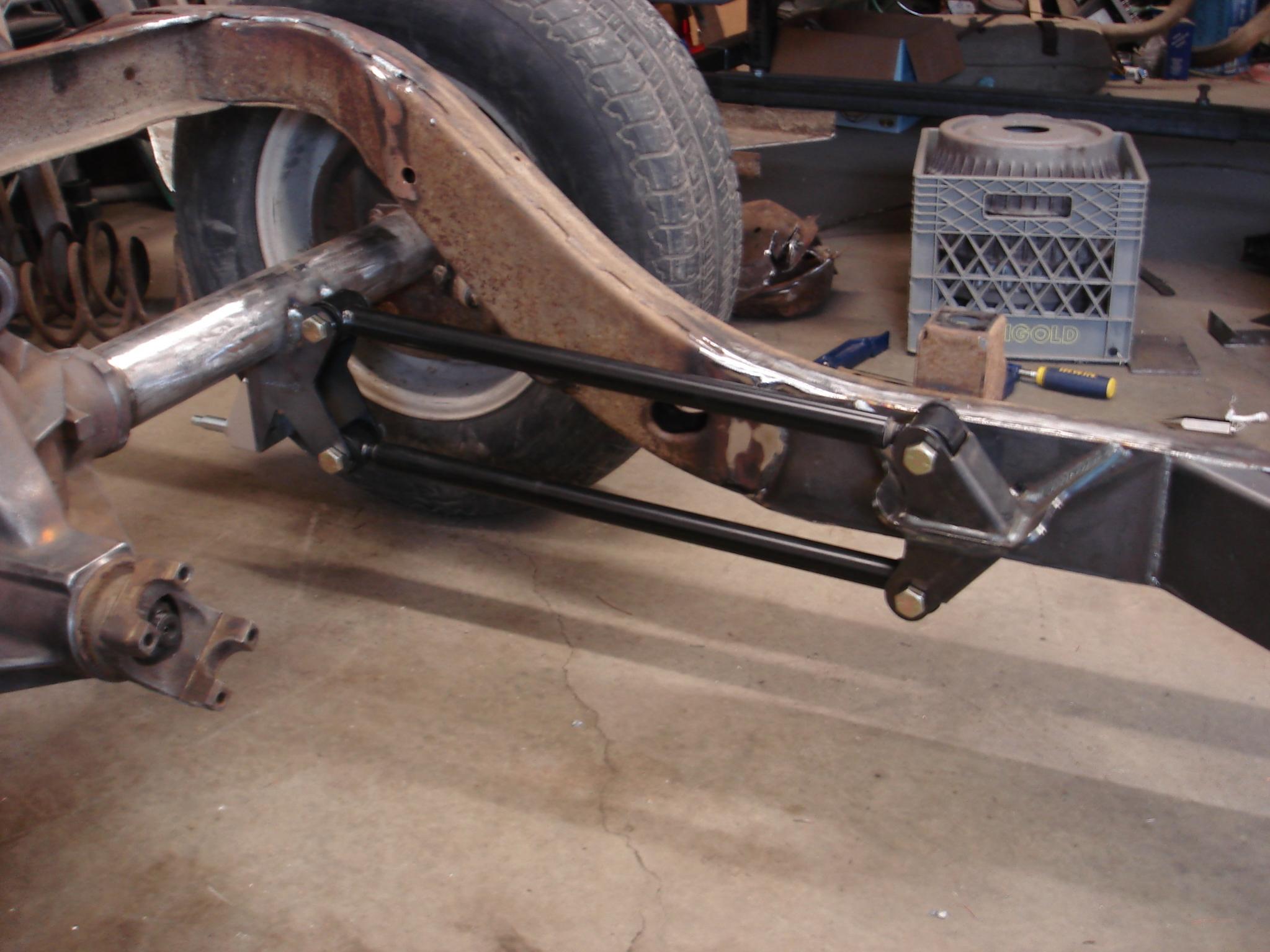

  2. rockable
    Joined: Dec 21, 2009

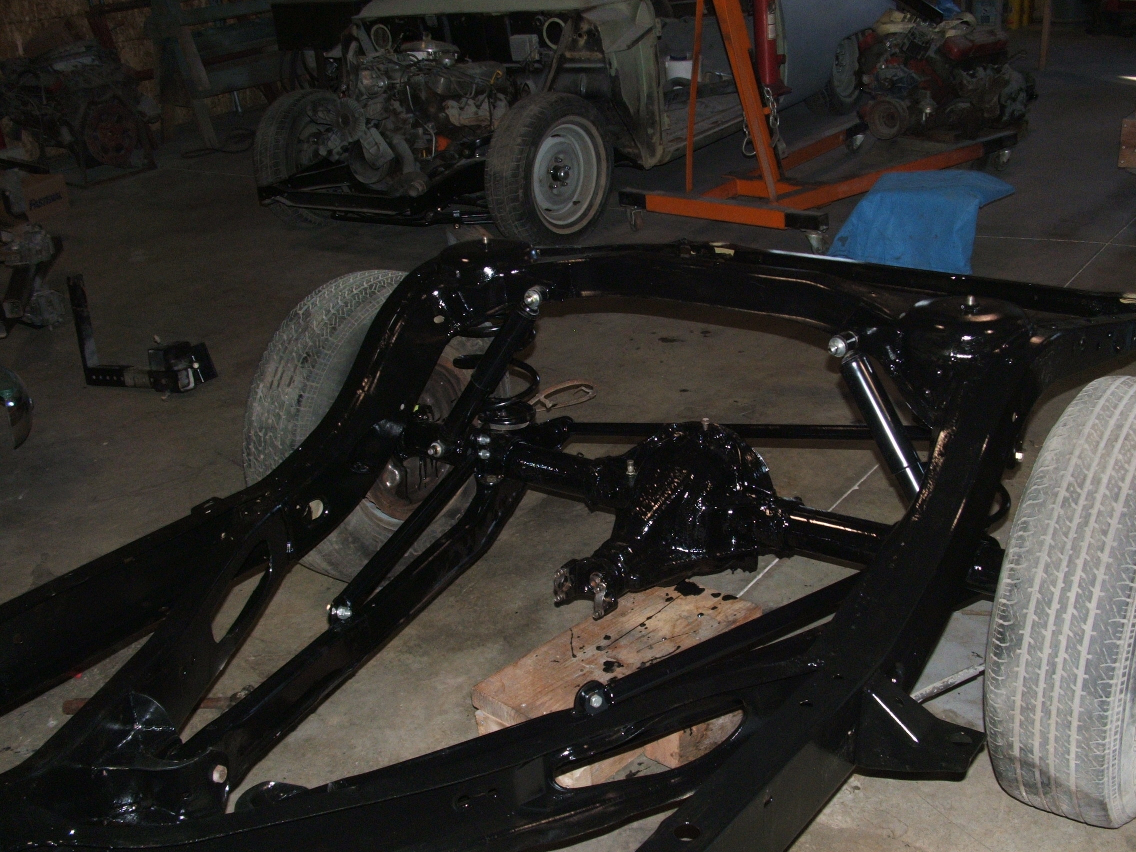

    Art Morrison triangulated 4 bar works great
    This is one we put on the 47 Olds
    This one went on the 1955 Buick
    Russ used metal plate to make sure the frame was strong enough at the mount points

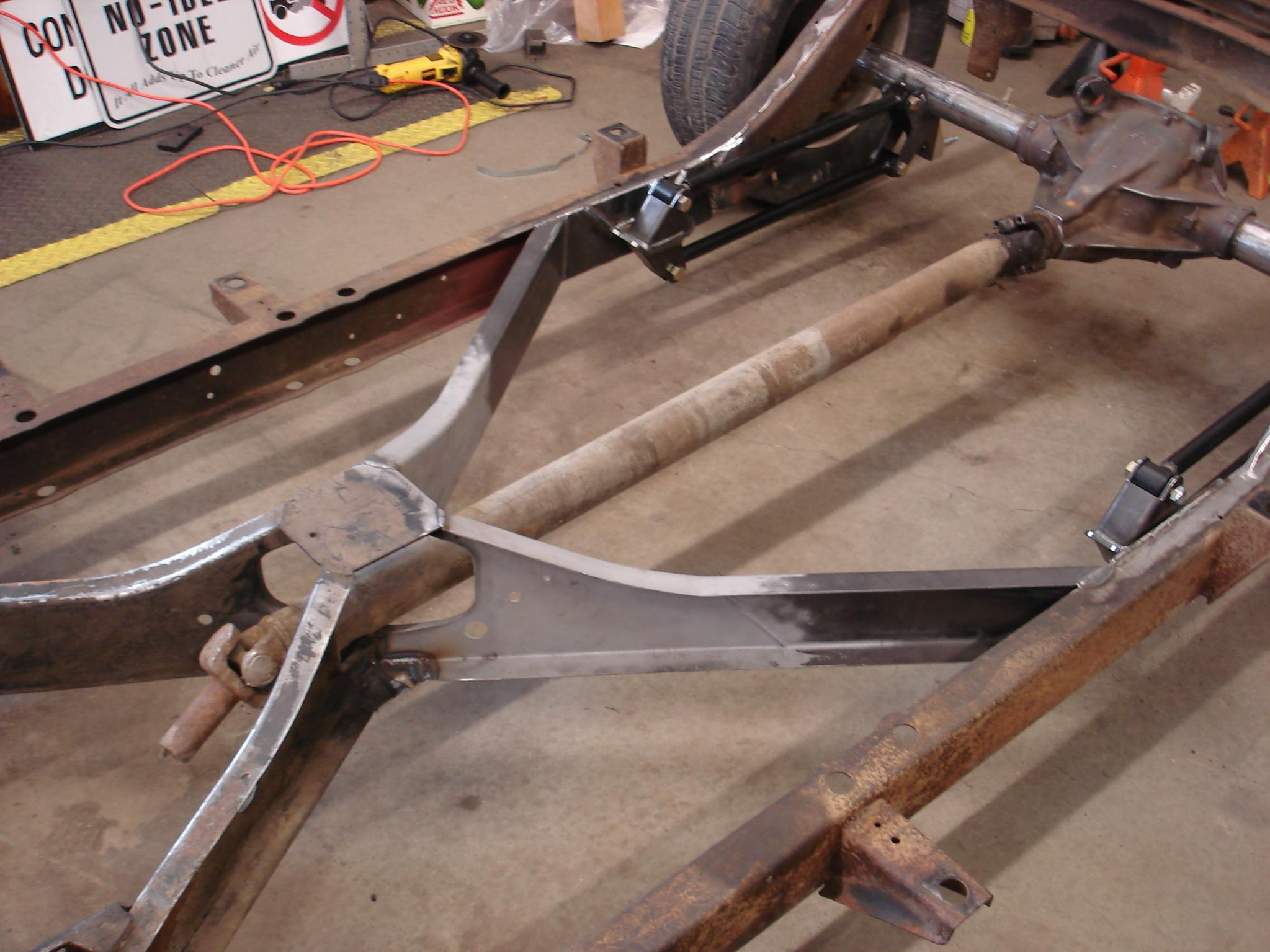

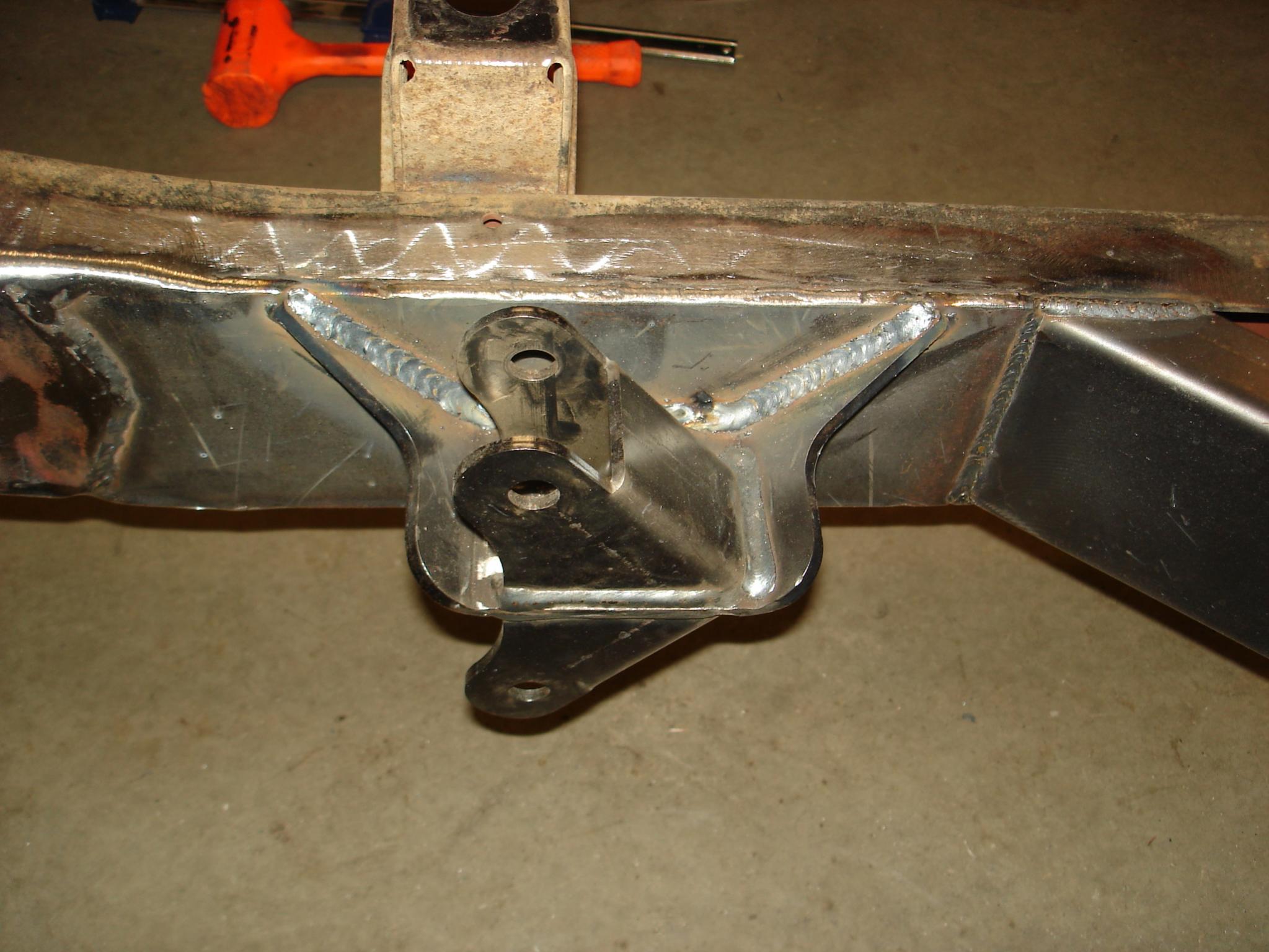

    Here are some pics of a parallel 4 bar installation on (I think) a Buick chassis.

    That's nice but they did it with the body off. They shortened the rear X frame members and moved them back into the side rails forward of the original attachment points, then they boxed everything back to the original boxing. I'm not sure I will be able to do that without taking the body off.
