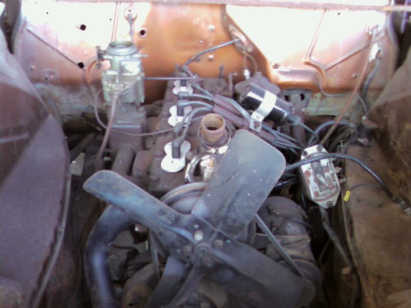

    Here is the S10 after I took most of it apart with that little tiny box of tools at the bottom of the pic at my grandpa's house in the hood.
