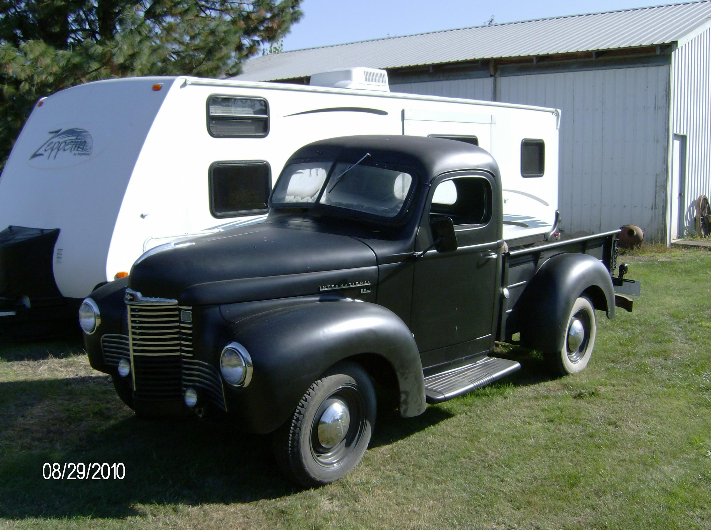

  10. silversink
    Joined: May 3, 2008
    Posts: 916
    silversink
    Mine is running a 71 must. 9" which is 59" wide ,exactly the same width as the stock reaend. The stock one was 513 gears and would onle get 45 mph. The Must. bolt pattern is the same as the International so I use the stock rims with 650/16 " rims. any questions PM me as I've parted out 5 and put mine and another one together from the parts, also if you need anything in the way of parts let me know.
    Ford and Int. use the same size U joints so they almost bolt right in . All I had to do was change the spring perches to 1 3/4 " and get a longe flex hose for the brake hookup, used the stock driveline with Ford u joints. The change over to one day by myself, not too hard at all.
