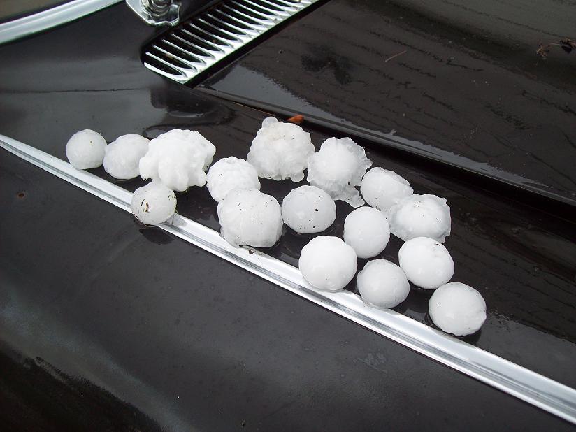

    Got the running boards and the front end pulled off the parts truck today between storms, hail took out the windshield on our daily driver:mad:, Tim Jones

    Damn Tim, that stuff looks like it could really hurt you. Know a guy on another web site from Nebraska who had two trucks totaled in the storm a week back that said it took the siding off his house too. Makes our drought seem less severe. Betting it freaked out your dogs.

    Yeah Tom we were watching it hit the car , stayed safe and sound in the house, last year my durango was totaled during a hail storm, As for the dogs they have three barns attached to their dog yard lots of places to take cover, after the storm stopped they were busy playing with all the ice balls:D,, Tim Jones

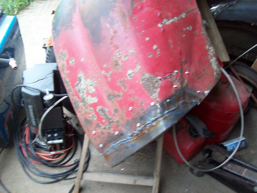

    Got some more work done on the truck, had to do some repair work on the lower part of the fender, made some running board brackets, mounted the drivers door and the running boards, It's starting to look like something,, Tim Jones
