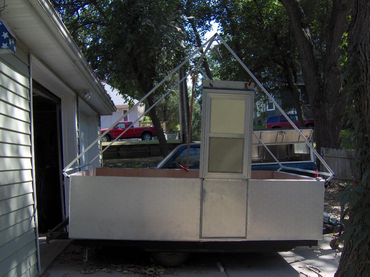

    hey Jones here is a picture of my camper construction, it is all 1x2 framed sides with 1x1 aluminum tube for top(to avoid rot). it's screwed and glued and very light with 1 inch foam insulation.1/4 inch plywood on both sides.

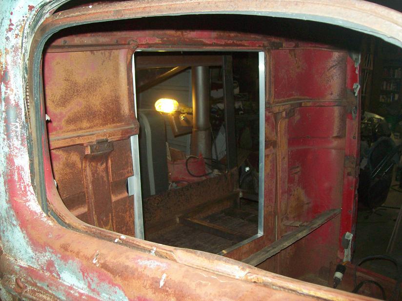

    Thanks Bob , I found that panel you were talking about to use for the back, Plenty there to work with, Here's a few more pics ,got the entry hole between the cab and the box cut out, Glad the cab I'm useing isn't perfect , would have hated to cut a nice cab like that:eek:,, Tim Jones

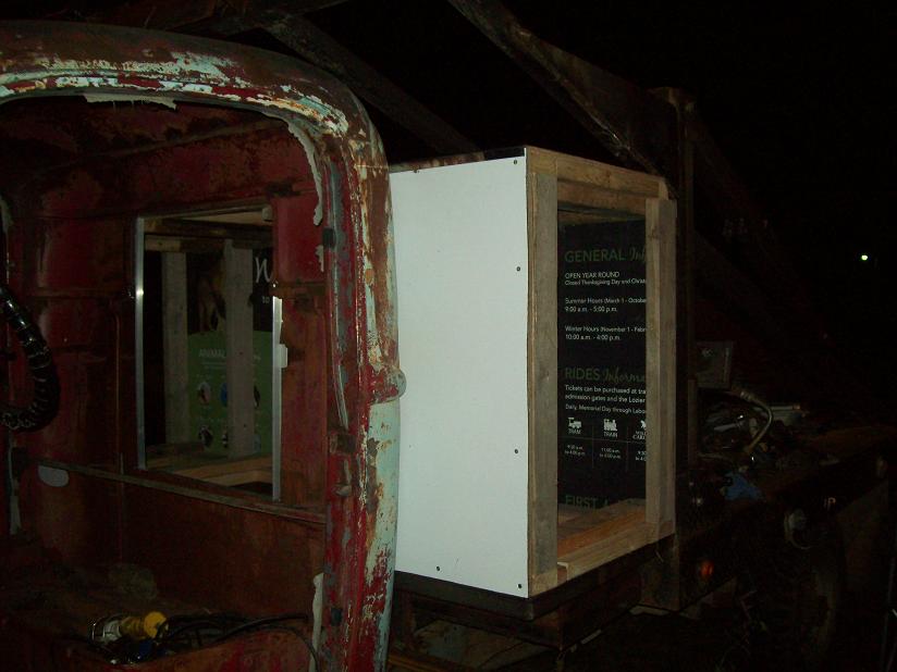

    Got the roof and sides put on tonight, at my work you never know what you will find in the dumpsters and scrap iron piles,, two sections of stainless skin for the roof and some of the old signs for the sides , my buddy 27Towner pulled a large sign out of the dumpter last year, it's a plastic with Alum skin on both sides, was able to do the entire back with it, cut a sight window in it ,so I can see right between the ramps behind me also,,, A pic of my poor mans Bending tools:D , works great in UN skilled hands like mine:eek:,,,, Tim Jones

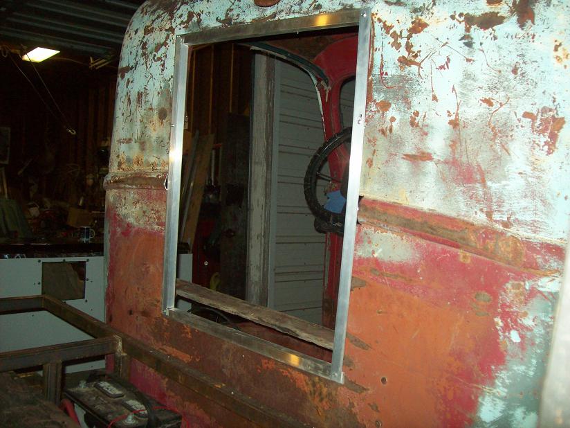

    Another heat wave came through so I'm back to working on the truck when the sun goes down:(, Got the opening on the cab trimed and slid the box in place, found out that who ever put the flatbed on the truck has it about an inch out of square the the front all welded soild so not much I can do to change it:mad:, First thought the cab had shifted at the back, Checked out OK tho, If I only look at one side at a time it's not so bad:D, I'll finsh the doors tomorrow,, Tim Jones

  10. 4444Design
    Joined: Aug 25, 2012
    Posts: 292
    4444Design
    would also do the sleeper in sheet-metal rather than in wood
    love the old cab with more modern technic anyway

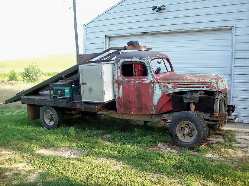

    Shot a couple pics in the daylight today
  16. 4444Design
    Posts: 292
    4444Design
    love it!
    btw: thx for the positive comment concerning my bikes ...
