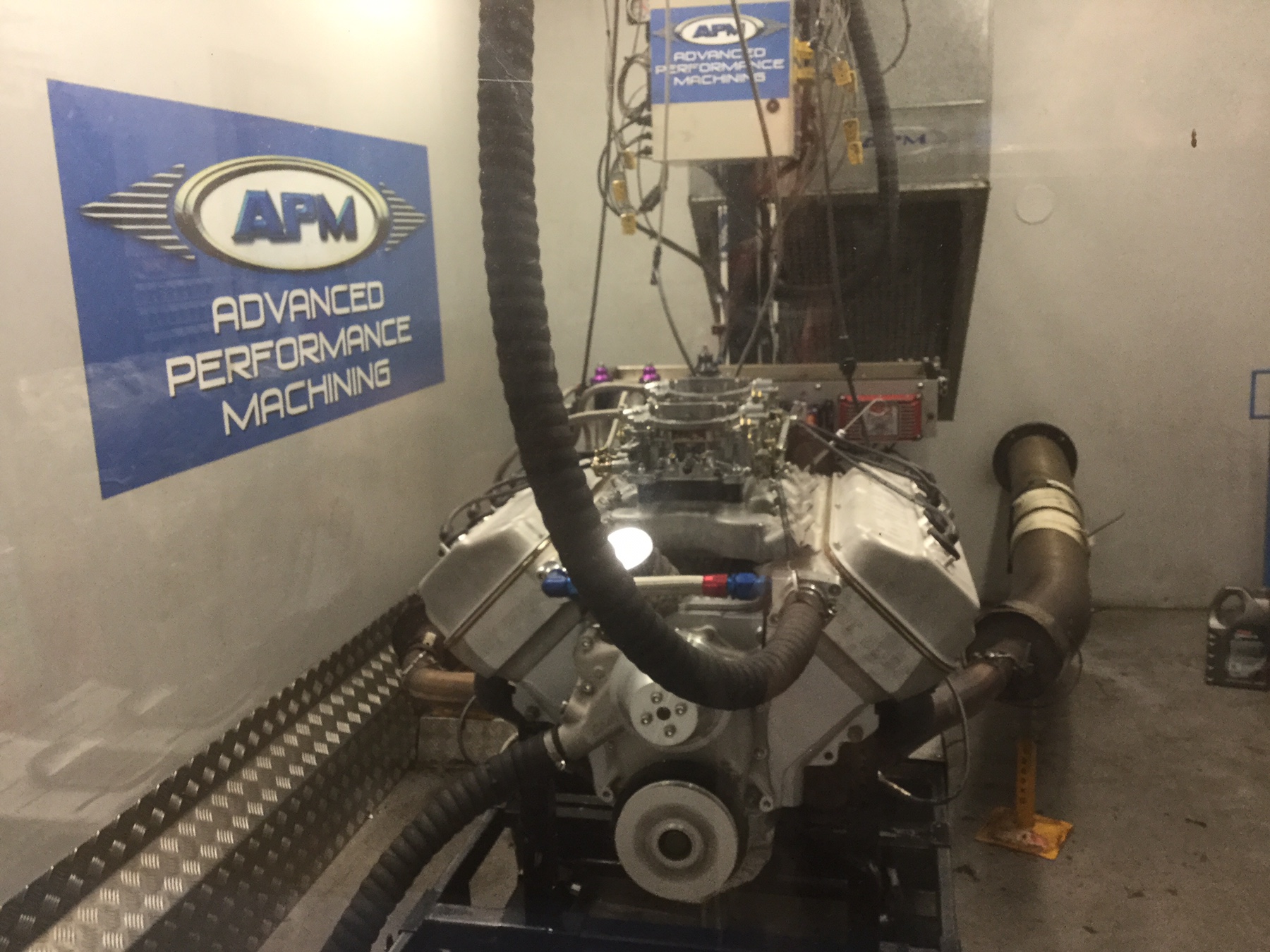

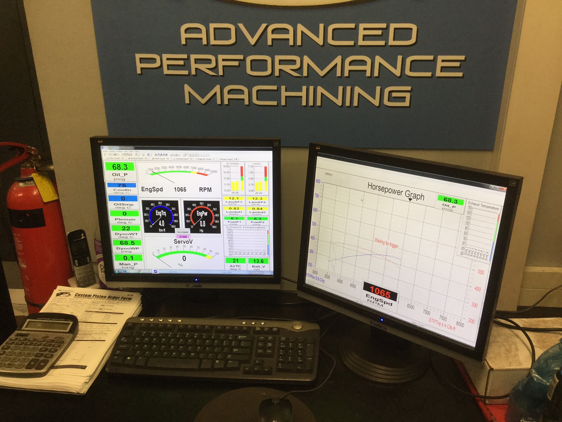

    Engine is back, just need to get back into the groove...
    Drewfus likes this.
