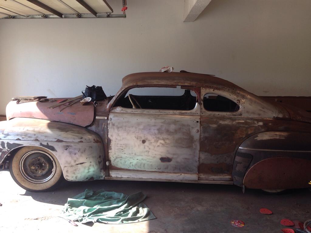

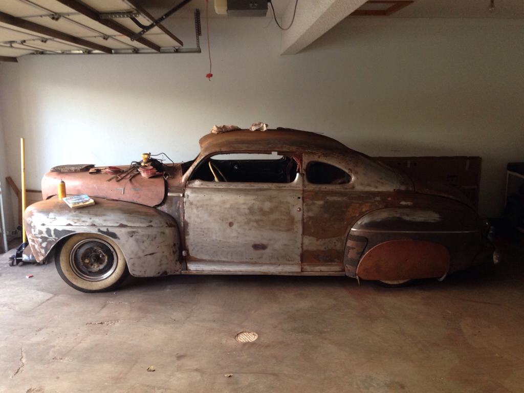

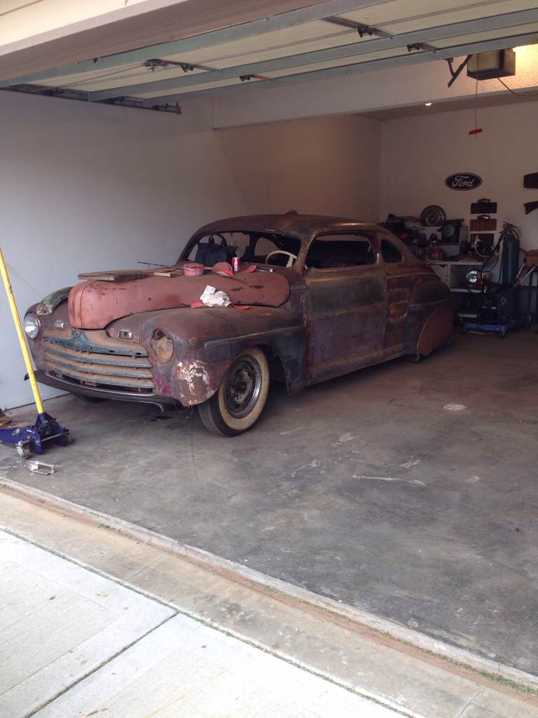

    We moved to a new house and I now have my own shop! Got the 46 moved up this week. Expect updates on a semi regular basis. 1479840213808.jpg 1479840221412.jpg 1479840229771.jpg 1479840238001.jpg
