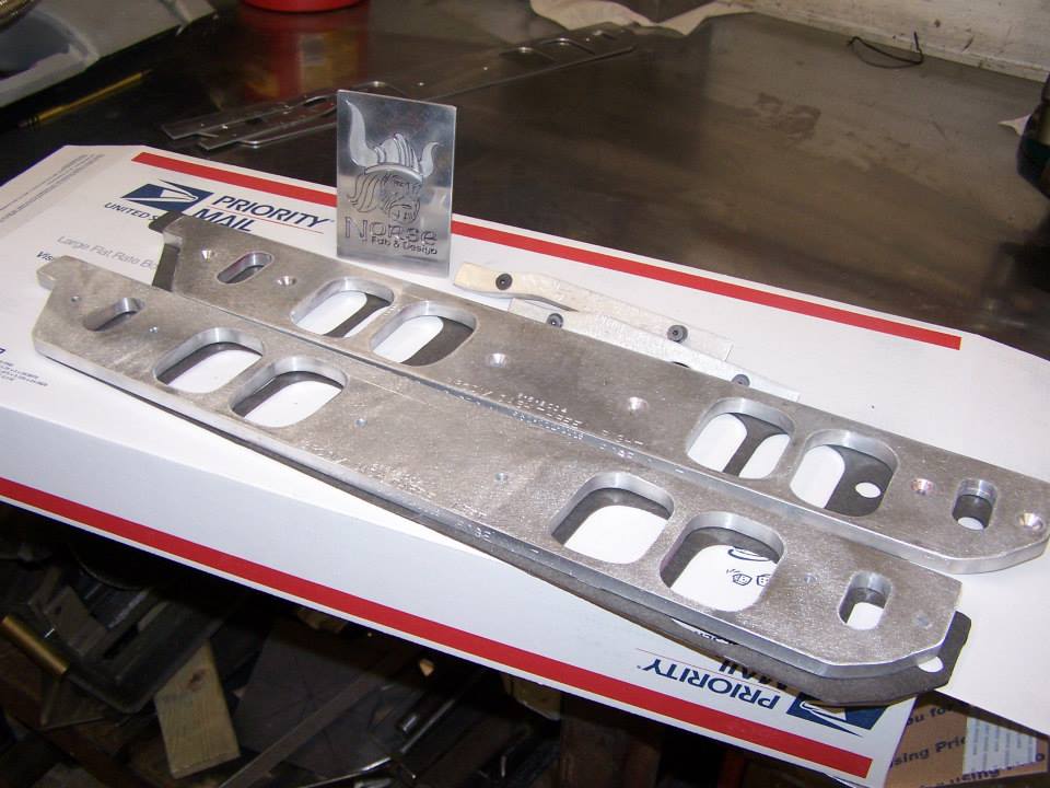

    We manufacture and sell billet aluminum spacers for whatever you need.
    We have oval port and square port on the shelf, ready to go.
    We do custom fabrication.
    Your Pal, Gary
