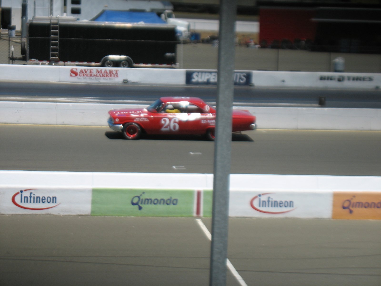

    The early 427s came as the Q-Code 1x4, 410 hp, and the R-code 2x4, 425hp. I have helped with engine parts for the restoration of 3 63-1/2 NASCAR cars- this one has my old crankshaft in it. BTW, the #29 Mustang in the background sports a very rare 302 Tunnel Port engine 005.JPG

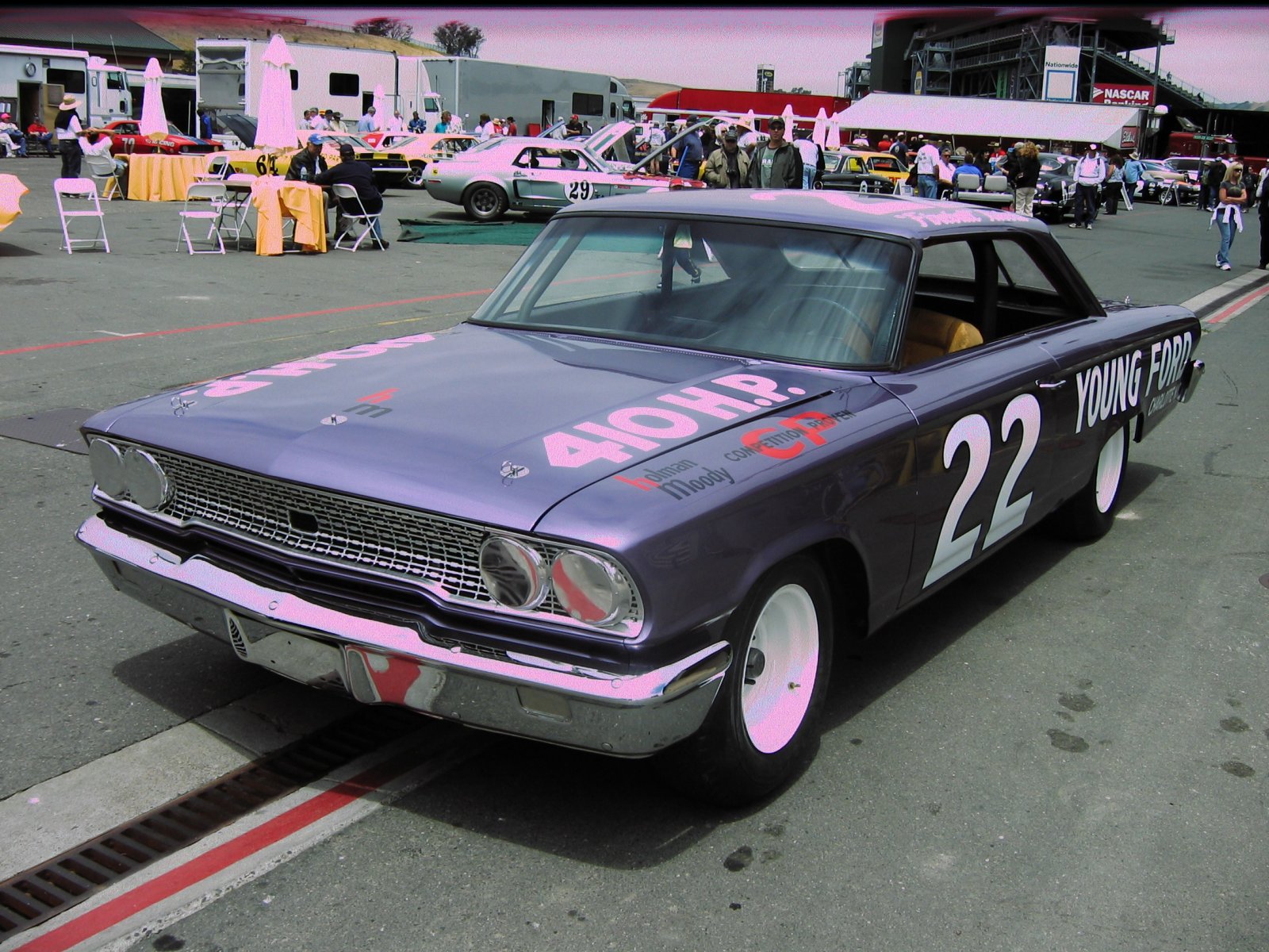

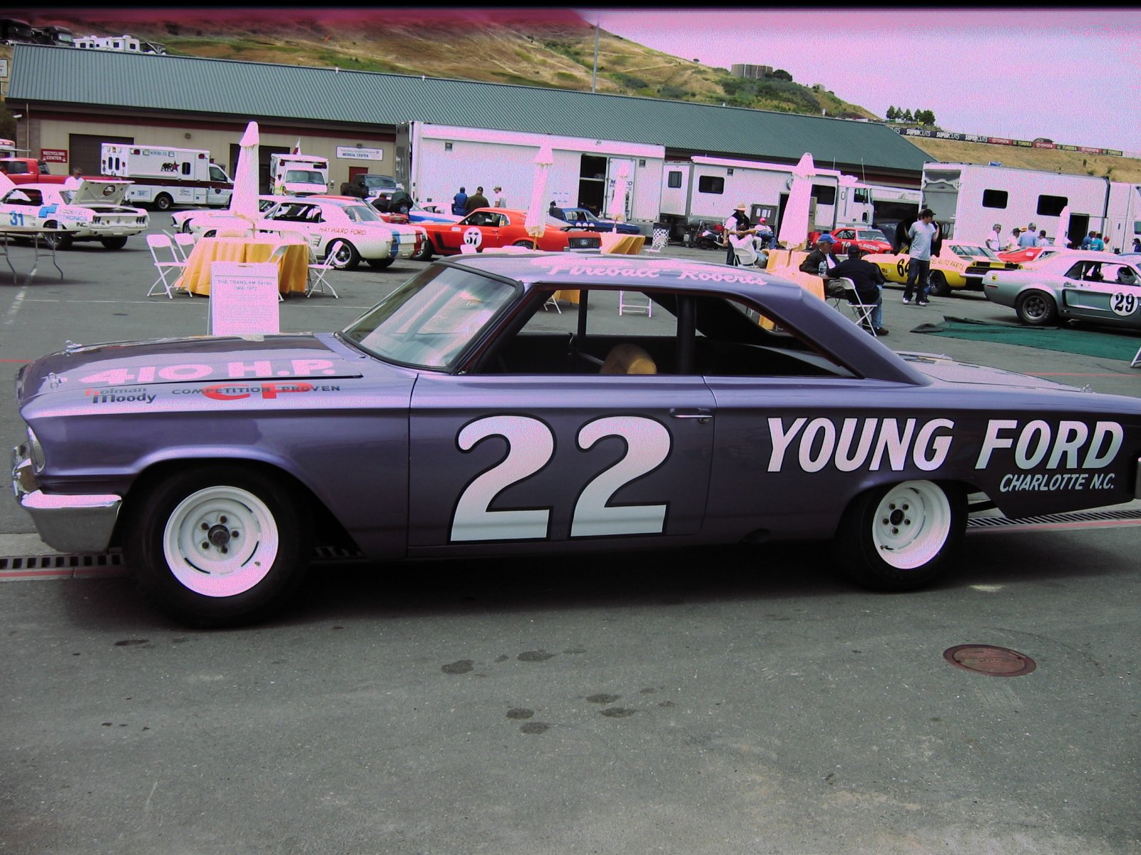

    This one has my old intake on it

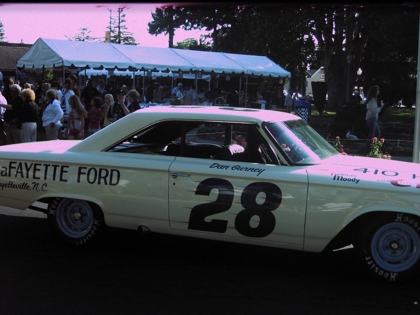

    This one I supplied the original breather parts for
